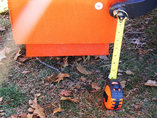

OK, I believe I'm a contender for TBN idiot of the month, I got home from work, ran out to the tractor expecting to find an overflowing hydraulic fluid level. Nope! I couldn't even see any fluid. DUH! Then I realized that I just put the new hydraulic 60" snow blade that I bought a few weeks ago on the front of the tractor . That's why I was putting the 3 point ballast box on to help with traction and as a counter weight to the snow blade. It never dawned on me that there were 2 hydraulic cylinders and 4 hoses that were likely empty and would fill with fluid. I even allowed for that when I installed the blade by running the engine for around 5 minutes at low idle to fill the system.
Anyway, I added around 2 1/2 quarts of SUDT2 to bring fluid level up to a little bit higher than it should be. I'll move the tractor to a more level spot tomorrow, warm it up, and fine tune the fluid level. Then I'll check the 3 point hitch. I'll bet it works like it should. I'll let everyone know what happens.

Here's the latest. I adjusted the hydraulic fluid level to what it should be. I had to remove some of the fluid that I put in yesterday using a turkey baster as it was overfilled. It is now at the correct dipstick level.
My height measurement to the center of the lower link ball is also 9 1/2 inches from the ground. So if that is correct, then all is as it should be. It still annoys me that the ballast box won't lower all the way to the ground. It is presently empty, but I did add some weight for figuring this out. If the ballast box had the recommended 300 lbs in it, having to place it up on blocks or something similar could be a bit dangerous and I couldn't remove it without having it on blocks. I have tried the 3 point drop speed control at both extremes and in the middle-----no effect on the height. I think I may take the advice of dsmiley and just put an adjustable lift rod on the left side too. They are around $35 for the whole thing, plus shipping. It wasn't something many online dealers had in stock but Coleman Equipment Inc had 1, so I just ordered it now. That should get me through until my warranties expire and I can drill another hole in each of the lower links if needed for special implements.
Maybe this will wear in a bit lower because when I first installed the 3 pt. hitch, I measured to the ground from the ball center at the lowest position and it was around 12 inches. I could slip a 4 x 4 under the ballast box. Now the BB is only about an inch off the ground at the full lowered position.
I'm going to leave everything as it is for the winter but I'll exercise the 3 point hitch every time I get on the tractor.
The picture shows the BB with the lower links at their lowest when this shot was taken. See how much space is between the bottom of the box and the ground, around 4 inches. It is now only about an inch, so maybe it just needs broken in a bit more.
Thanks to everyone for the suggestions and advice. If this improves at some point, I'll post about it. I'll let you know how the adjustable lift rod works out too.

Just curious if your BB is made for the BX25 as Kubota makes different models of them.If so is it possible to relocate the pins higher on the box? It makes me wonder what Kubota is thinking if they designed their products this way.I remember being frustrated with the TPH on my BX25,when I had it,in that it wouldn't lower enough to unhook my chipper without putting blocks under it.
