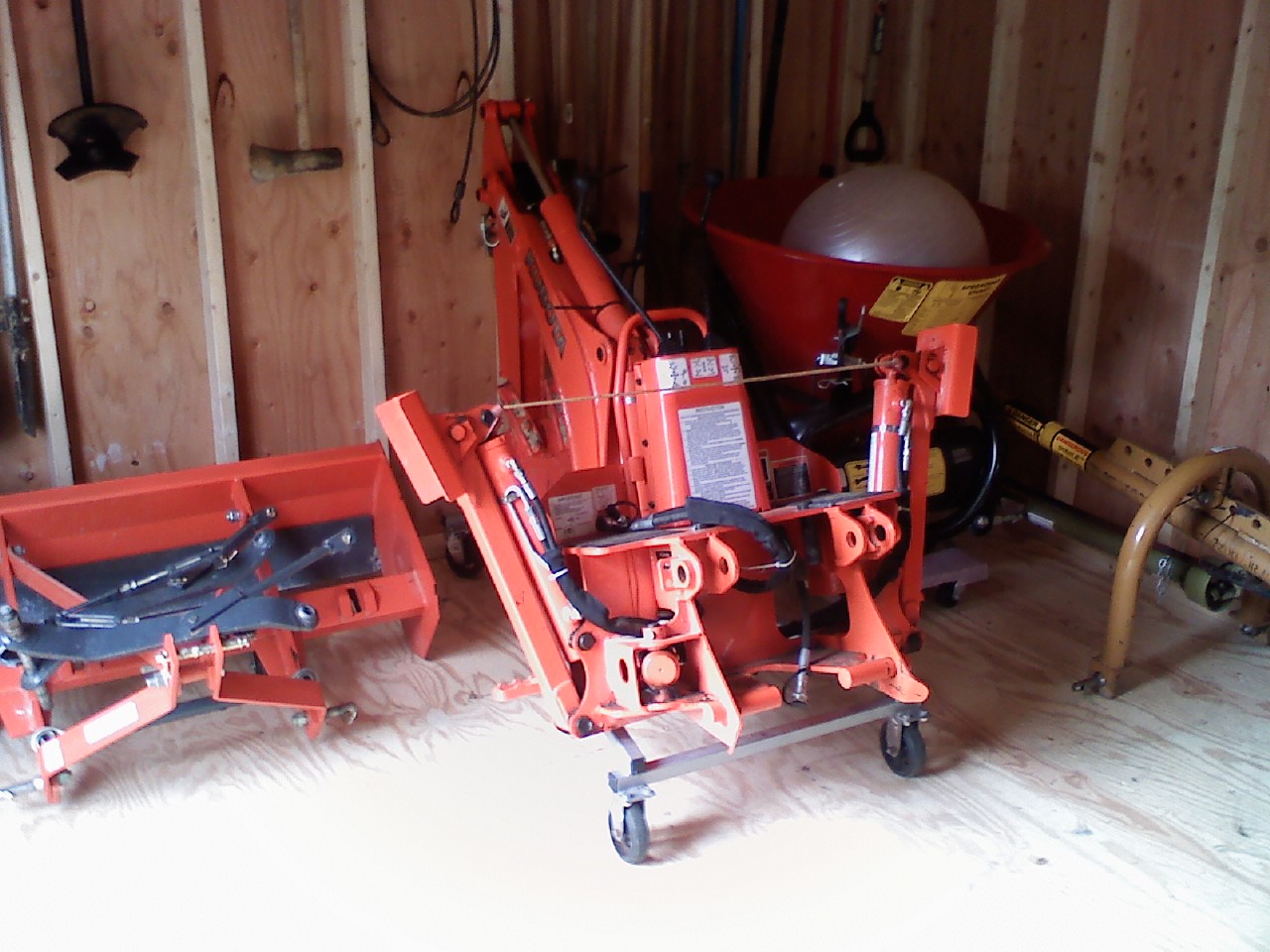

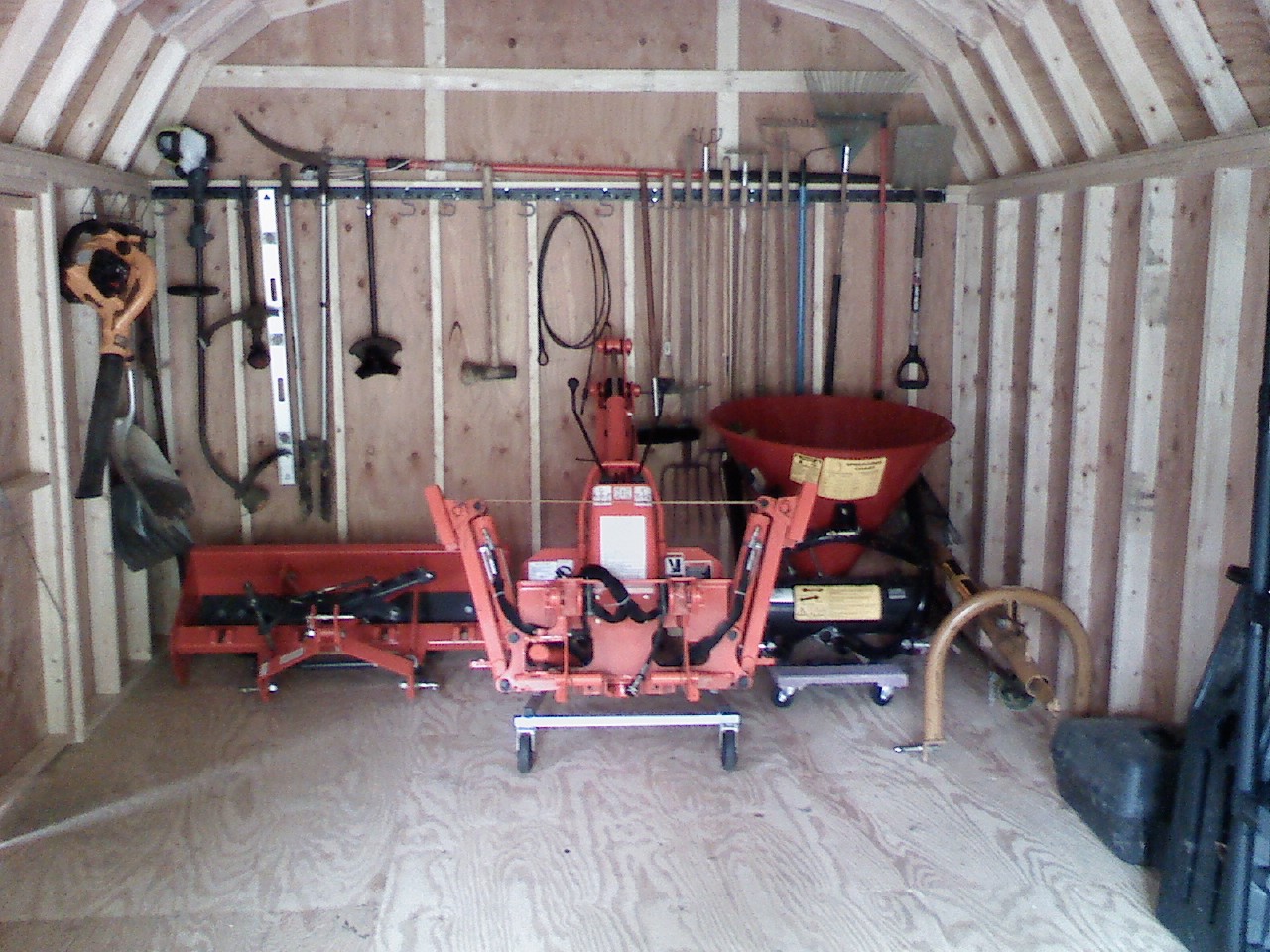

Not trying to spend your money but the BXpanded backhoe dolly Loader/Backhoe Dollies may help you with your issue. I have one and never have an issue with either pins.
