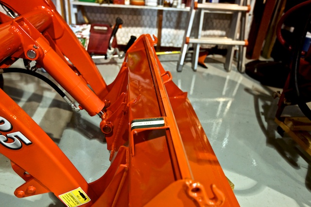

My BX 25 arrived today ... a very windy day in South Texas. I had chain hooks on the front bucket of my BX 2360 and had the dealer weld some on the new loader bucket. I also had a center loop welded just because. The other mod i had them do was to weld a piece of 1"square steel tubing ( 1/8" wall thickness) along and just under the lip at the top of the bucket to strengthen the top leading edge as I do use the chain hooks to pull things out .
I have also ordered the BXexpanded back hoe dolly and trailer hitch. I also plan to mount a circular hook on the front frame in one of the two holes in the frame / grill guard in case I need to pull something. gives me lots of options
Now to learn the back hoe, many people have told me if I liked the BX 2360 I will be in love with the BX 25 ... hope so

I am surprised that no one commented on this simple and logical improvement to the front bucket. I have used the chain hooks frequently to pull up neighbors old fence posts and numerous dead bushes ( remember we have had a very dry summer) and re-enforcing the top edge of the bucket minimizes the chance of bending it when using chains attached to the outboard hooks and the weight increase in minimal.

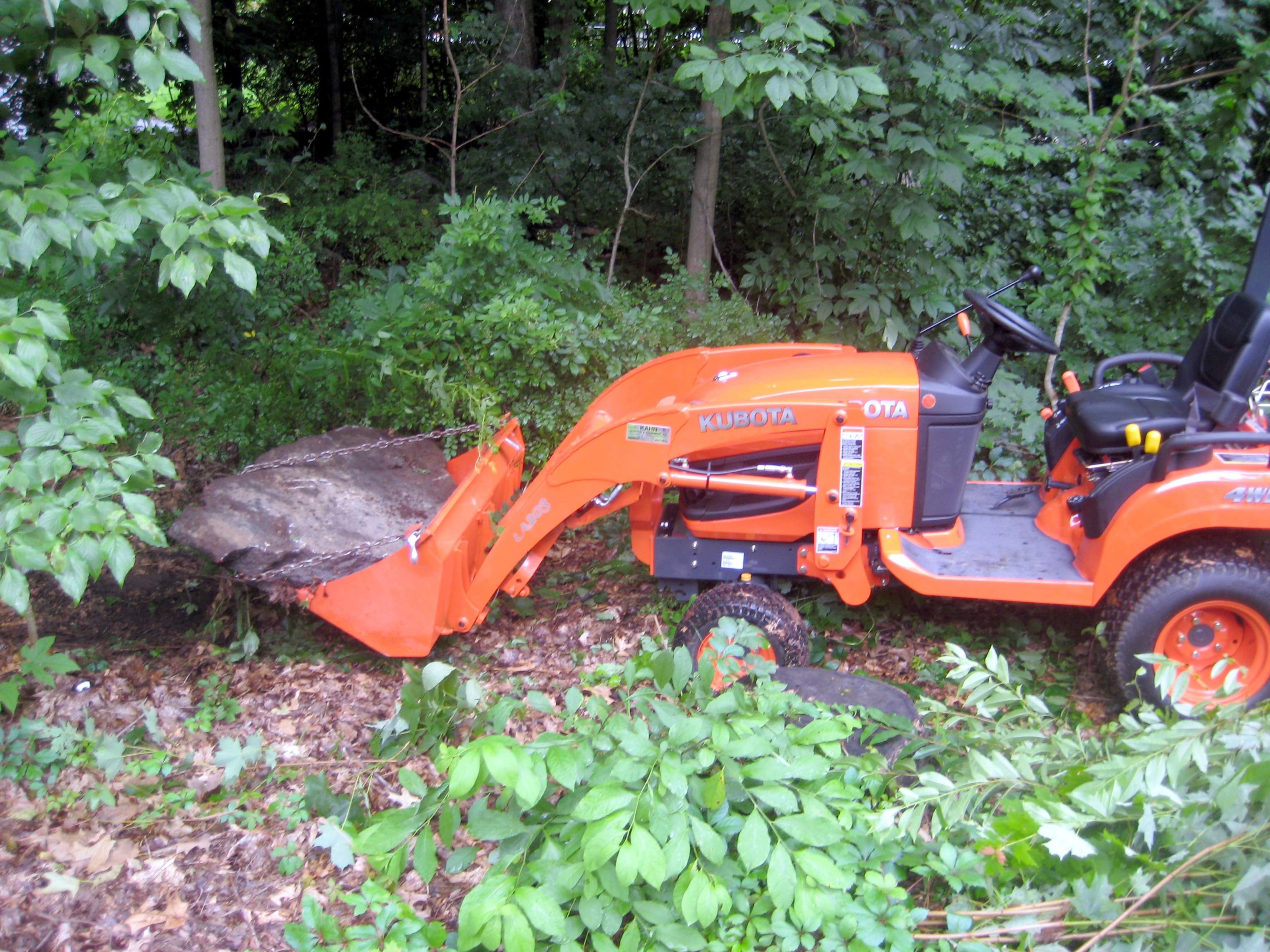

I think that's because having chain hooks added to your bucket is almost standard fair for TBN guys. I had mine done after reading here and elsewhere how helpful it is to have hooks on the bucket. Mine are at the outside top corners and don't seem to need any additional reinforcement.
Here's how I use mine most often, which is to use a quarter inch chain from one hook to the other to help keep large objects in the bucket.
