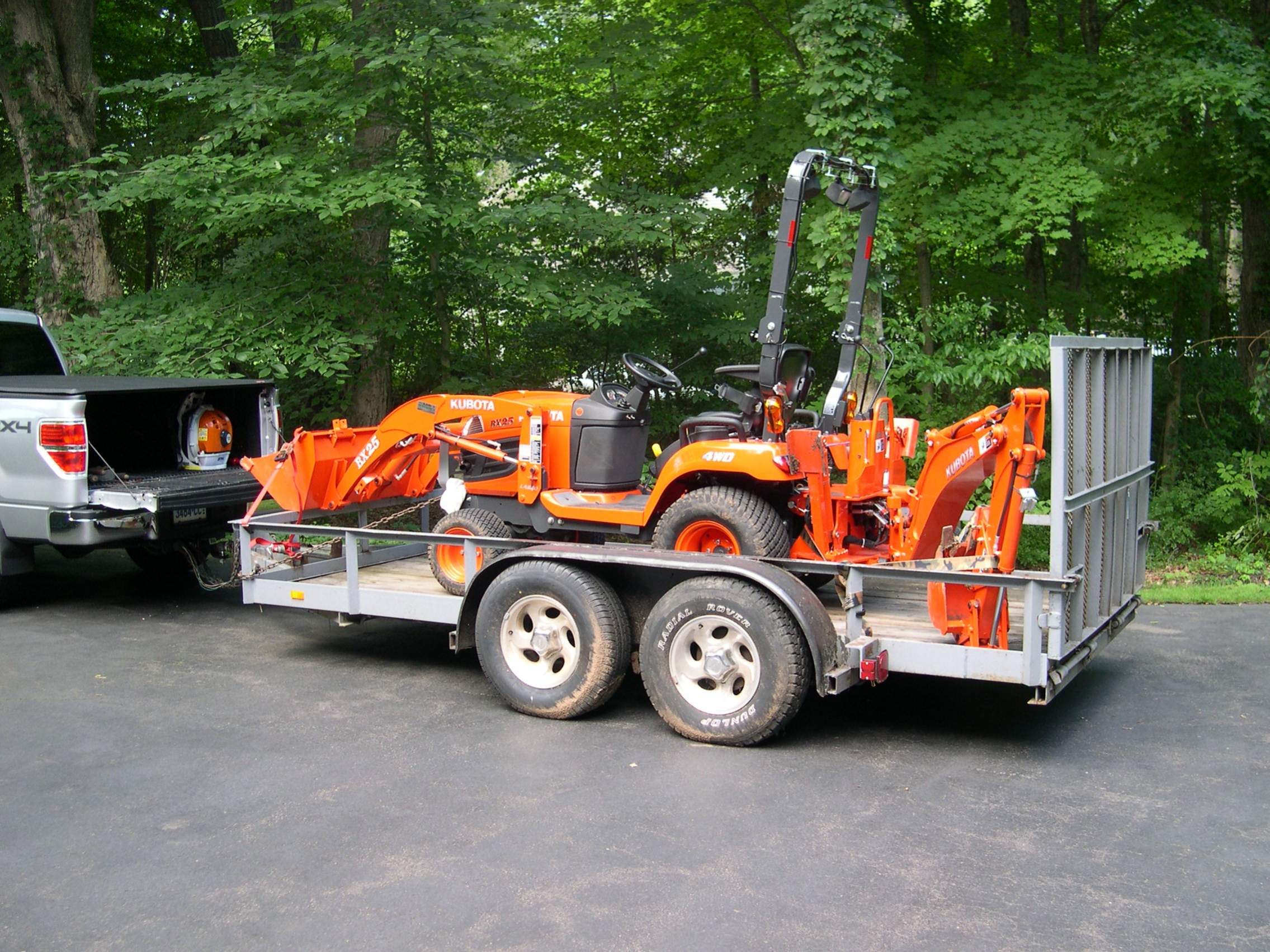

On hooks, I prefer chain hooks since you can drop any link of 1/4" or 3/8" chain into the hook and hold the chain in place. Makes for lots of flexibility chaining up various sized objects to the bucket. I use a slip hook off the draw bar to pull out saplings and whatnot. Just throwing it out there for your consideration.
Also, on trailers, my 14' is a smidge small for the BX25 in full dress. Bought it when I owned a BX1860 so it was plenty for that. No budget for anything longer at this point.

I think I measured a quick 15' minimum for a fully dressed BX25, bucket down, BH pinned. It was a quick measurement, I need to get serious and measure but good. THANX for the pics! Gotta love pics! :thumbsup:
