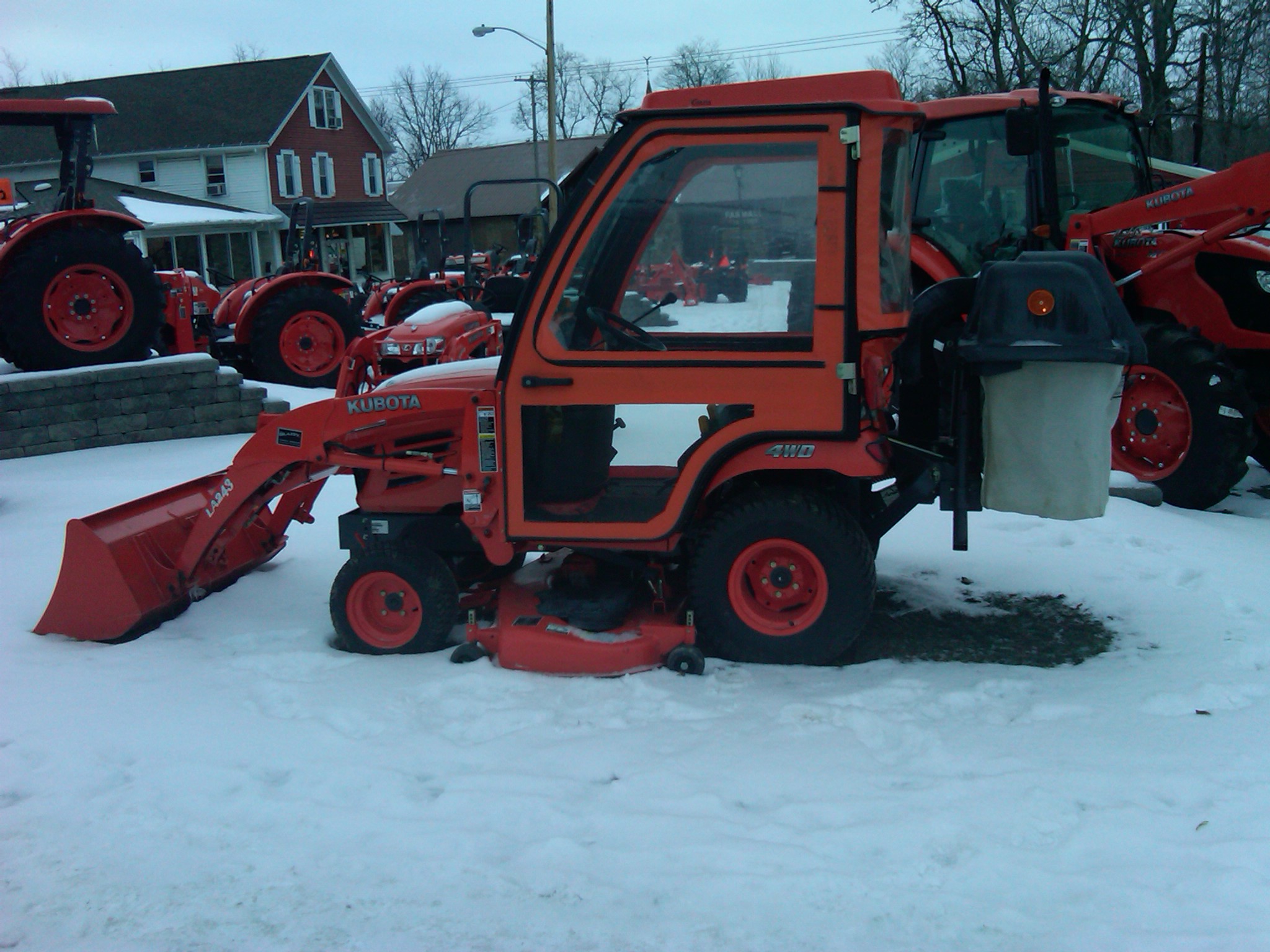

No I havent priced one recently, but they are more then 1k which is too much for me on a small tractor. here a picture of one shown locally to me.

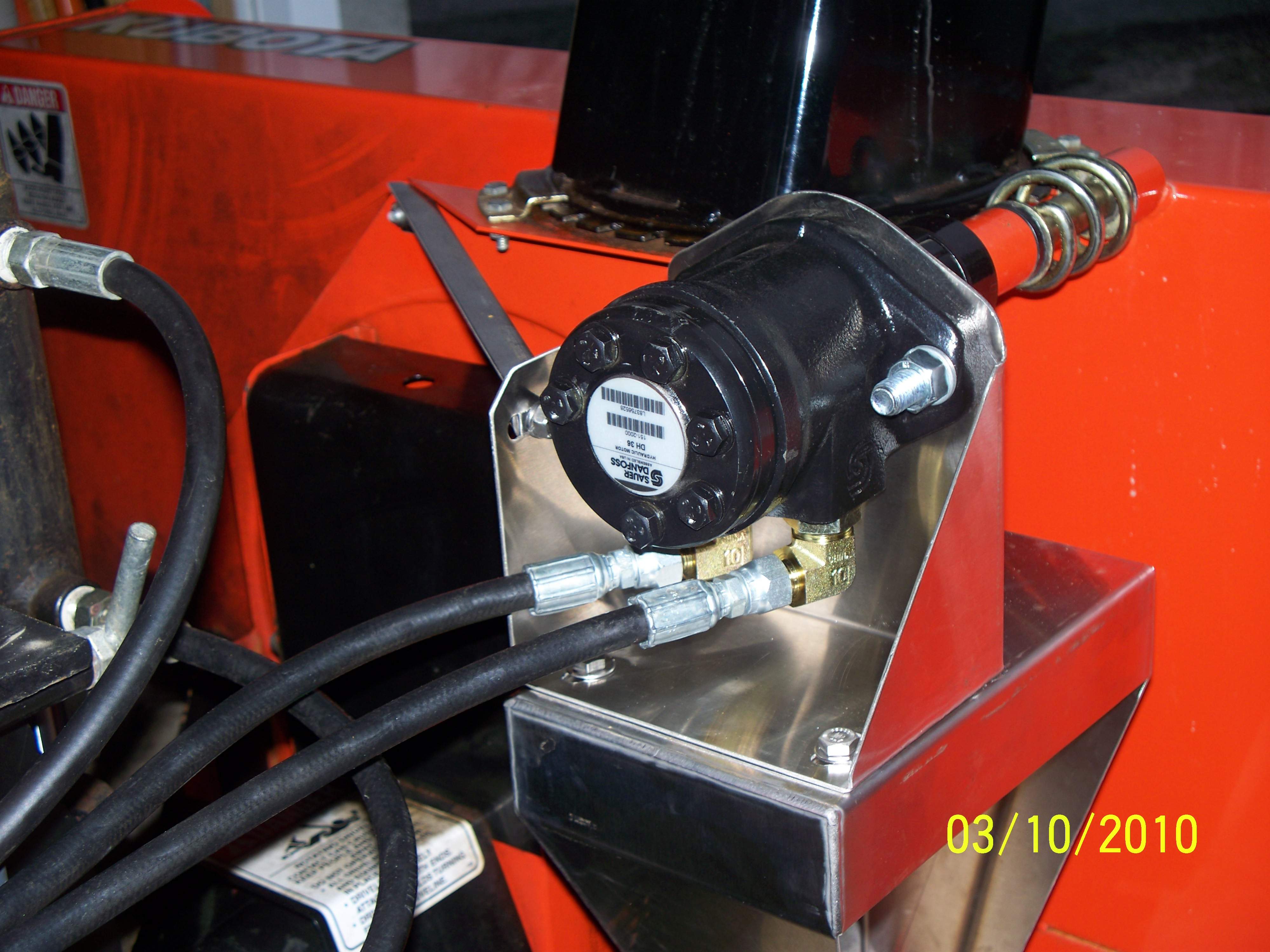

That's the thread where I got the idea for my cheap cab. I found the cover
cheaper at another place. I believe it was only $64 plus shipping which was eight or ten dollars. I used 2x4's for a front frame that bolt through the factory
fender mounting holes & I used a piece of cheap particle board for the roof. I have closed the front in better with foam & covered the radiator inlet with plastic since the photos were taken. I have also put a hydraulic chute rotator on the blower. I attached a few pictures of that setup. It works great.
