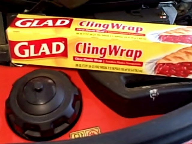

There are two fuel filters: one near the engine, one under the tractor. Because there are no shut offs for the fuel line, I did this trick when I swapped out my filters. Remove the fuel cap, then place a piece of plastic wrap, like Glad Wrap, over the fuel tank opening. Then put the fuel cap back on, threading it over the plastic wrap. The plastic wrap prevents air from venting through the cap. (Plumbing 101: Air moves liquid.) Using this method, I only lost about a half pint of diesel.
Good Luck.
