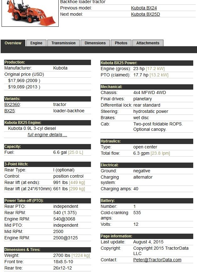

There's a lot of truth in everyone's statements.
Machines are designed to meet specific parameters set forth early in it's design. Does anyone know the actual loads the BX25 can actually endure over time? I know I don't and I don't pretend to. While I did think about the front axle I may be guilty of not giving it the consideration it's due.
Specs.
Counterweight is another important consideration. As the FEL load increases the front axle / wheels become the fulcrum or pivot point. To counteract this load additional load must be added to the rear to prevent lifting the rear wheels off the ground. According to the data above, the BX25D sporting the front end loader and backhoe weigh in at 2,700 pounds.
Having the backhoe attachment in place clearly adds a lot of ballast to the equation. According to Kubota, the backhoe attachment adds an extra 617 pounds
One could contact Kubota and pose the question whether or not the force of a 2" cylinder compared to that of a 1.5" cylinder is a lethal combination.....but I'm almost certain they'd plead the 5th due to liability issues.
Caution is always advisable anytime we uses these machines whether completely original or slightly modified.
Before I move forward I'll see if I can gather more information especially regarding the front axle...

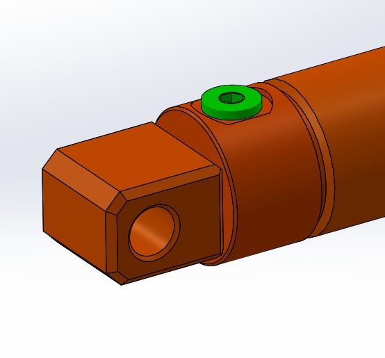

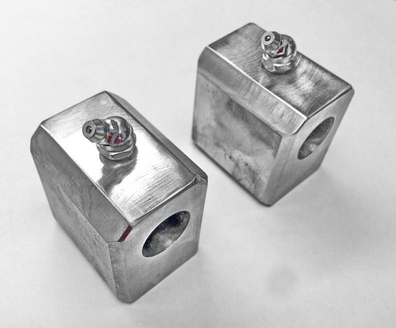

Like everything in life, all good things take time!
Modifying the set of cylinders I described on page 2 requires an adapter in order for them to fit in the stock loader arms. I machined the blocks below and when I get a few bucks put aside I'll order the cylinders and modify them by removing the standard mount then welding on these..
Nothing fancy, just some low carbon steel milled, drilled, and tapped..
