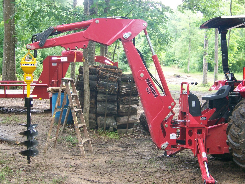

Check out Danuser Augers. The 8300-1 should work if your BX25 puts out 6 gpm.
http://www.danuser.com/PDF/ag_brochure.pdf
I have the 8300-2 and love it. I fixed it to mount on my backhoe, but will get the bracket to mount on my loader bucket, on the side.
hugs, Brandi

I thought that also. I thought, since my backhoe bucket could reach 14 feet, I could put in 3 holes eight feet apart. But after I got the auger installed, I realized I had to raise the boom so much for the ground clearance, My hole digging reach was severely restricted. Each time I have to move the tractor for more holes, I have to stow and lock the boom, raise the stabilizers and then move around to the front seat and move the tractor, then reverse all this. Moving it to the front bucket, I will not have to do all again, time after time.
I would not have to leave the seat. Having the auger on the end of a backhoe was great for getting into the barn and digging holes right up to the wall, or other tight spots, but for numerous, wide open, fence posts, it needs to be on the front bucket. Danuser sells a loader bucket mount. I didn't buy that and I modified the auger motor's mounting swivel to except my backhoe bucket's pin. So I will make a loader mount to fit it and have straight line access and limited corner augering access.
hugs, Brandi
