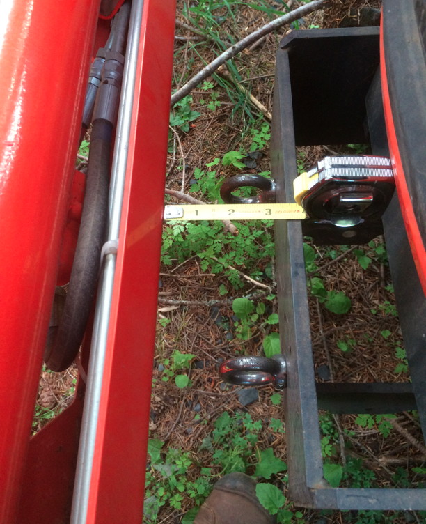

Do any of you know of a front weight bracket for the BX25's? Maybe built one?
I put a EA aerator on my BX25 and while it works great it also causes the front end (wheels) to lift about 18" off the ground on a hill so that is a little bit of a problem. I could use the front end loader but would like to keep the machine shorter so thus the idea of a front weigh bracket.
   / BX25 front weight bracket #2
There is only about 3 inches space when the loader is fully down.

I got a factory bracket and suitcase weights for my BX24. Not cheap, and the bracket and weights didn't fit each other :( Once I got the bracket modified I could use it but ... not only does the loader come off (that was the idea as you indicate) but the brush guard has to come off too. Major PITA. Can't even leave the weight bracket on when the loader goes back on.
Used the setup once with the tiller and never again. Just too much fuss. Maybe Kubota has done something different now or better yet someone here has fabbed up something that works well.
