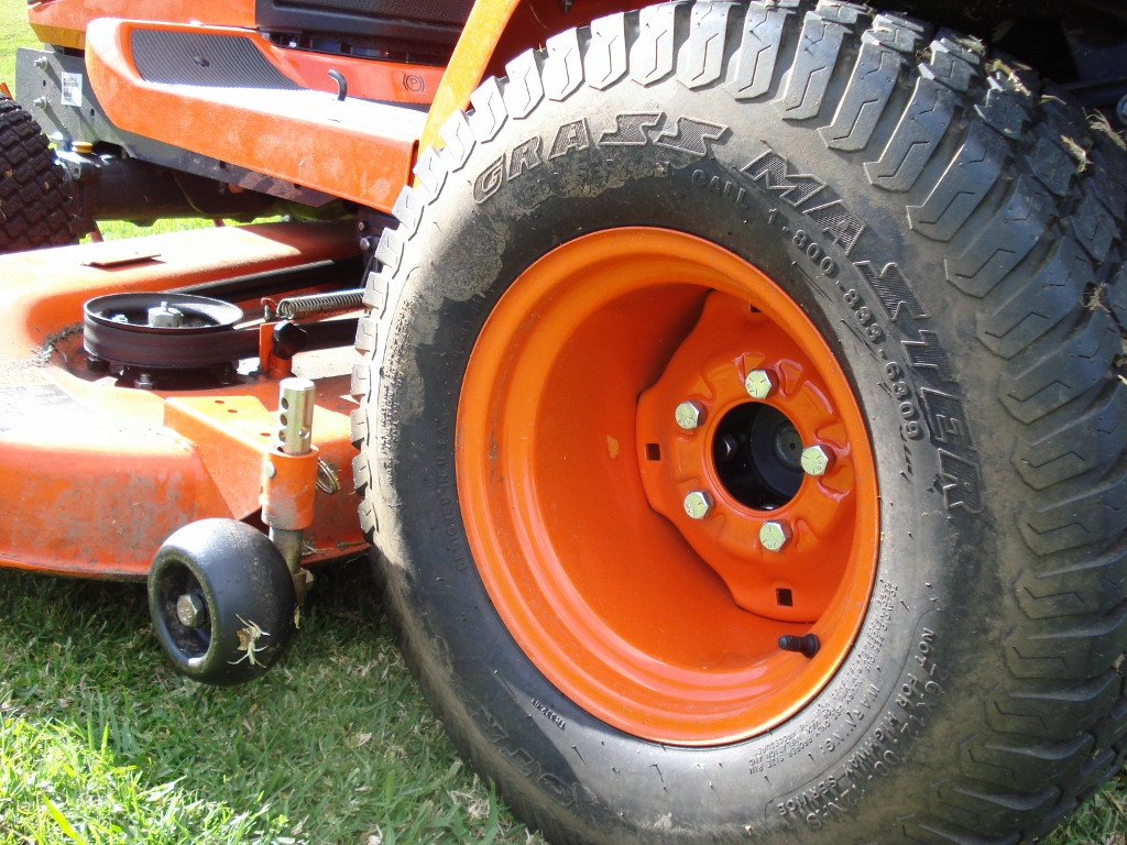

I got the spacers after a recommendation from a fellow TBN member "OrangeRidge" .. thanks mate!
got 2" rears as my mower deck gauge wheels prevent going any wider .. I don't mow very steep, but its good to know they are there .. spacers01.jpgspacers02.jpg

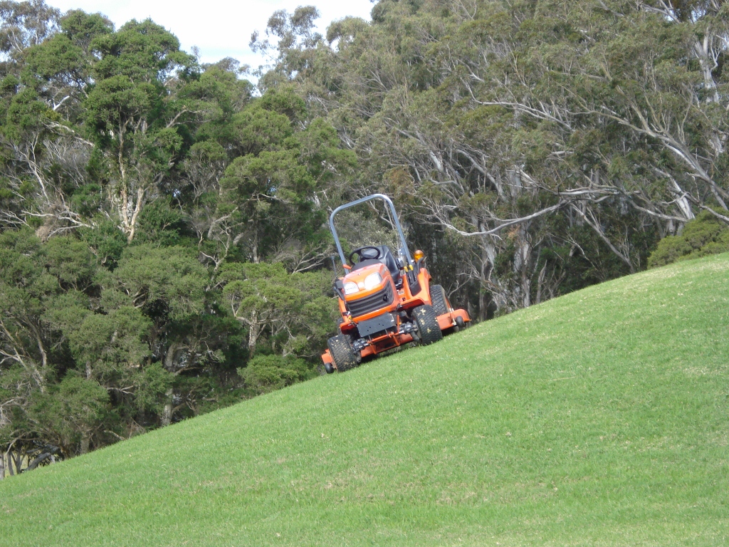

I bought the Bro-Tek rear wheel 2" spacers a couple months back and it's made all the difference in the world to me. My property is pretty much on a 15 to 20 degree slope for the full 5 acres I have. I do have some areas with more slope, however I'm still uncomfortable sideways in those areas.

   / BX25 Goodies #149
It looks good. Does it feel more top heavy now?
   / BX25 Goodies
#150
I can feel it yes, what is the width OE, 44.5" ? Yep I feel it.
I have the rear wheel weights that I will add which themselves weigh
more than the roll-cage, maybe adding wheel spacers too. I put on a
rear hitch and I have a front hitch going as well, all add to ballast
to counter it. I need to get a few projects finished up then
I will address the undercarriage protection, which will add even more ballast.
