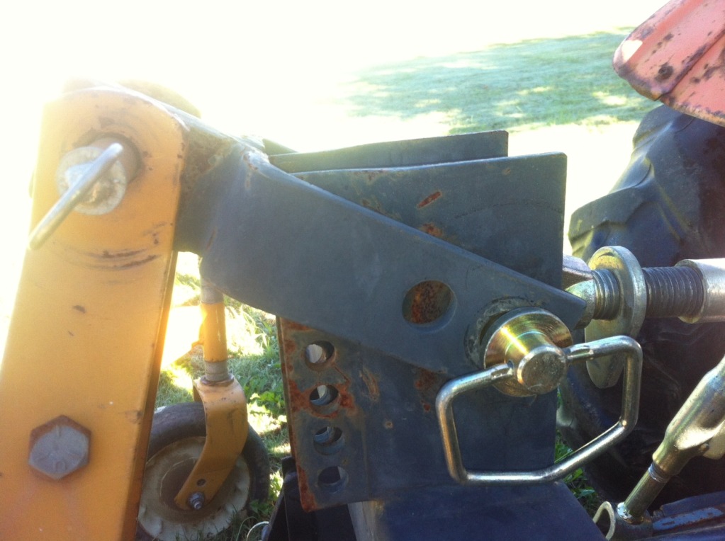

Hi, I actually have one of the HF top link adapters. I purchased it when I got the quik hitch. I use it more than the "hook." It replaces the hook and uses the toplink pin to attach to the QH. Kinda squared off U shape with a drilled solid square bar welded to the base. I find it very handy for most implements.
   / BX25 Harbor Freight Quick Hitch
#42
Thanx Bill, but have you ever heard the phrase, in forums,
"Pictures or IT NEVER HAPPENED!" :D
I would love to see pics of it bro...
TIA!
   / BX25 Harbor Freight Quick Hitch #43
Here ya go.

Thank you Billy...
I wish I knew how ot order that puppy...
In the instructions they spoke of it but there was no number with it!
   / BX25 Harbor Freight Quick Hitch #46
Call harbor frieght customer service and ask for Item #29309, Description 93691 Hitch Adapter
