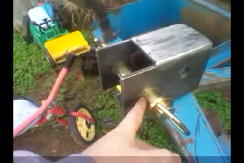

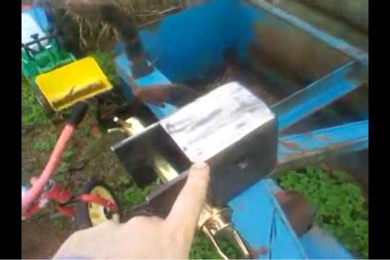

Artisan, for you top link adapter could you, weld like a top on the adapter so it doesn't pivot up or down, here is a photo I took off a YouTube video "it's how to make a toplink adapter"

Thanx for the input.., I am chewin' on ll of it.
I want to try to make it remain easy on and off.
I await some roll pins still, after I get them I will
test this and see what I see...

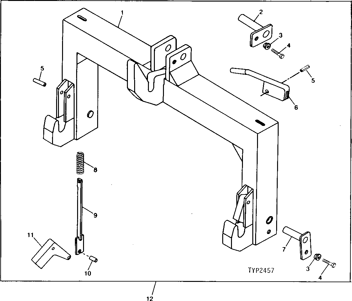

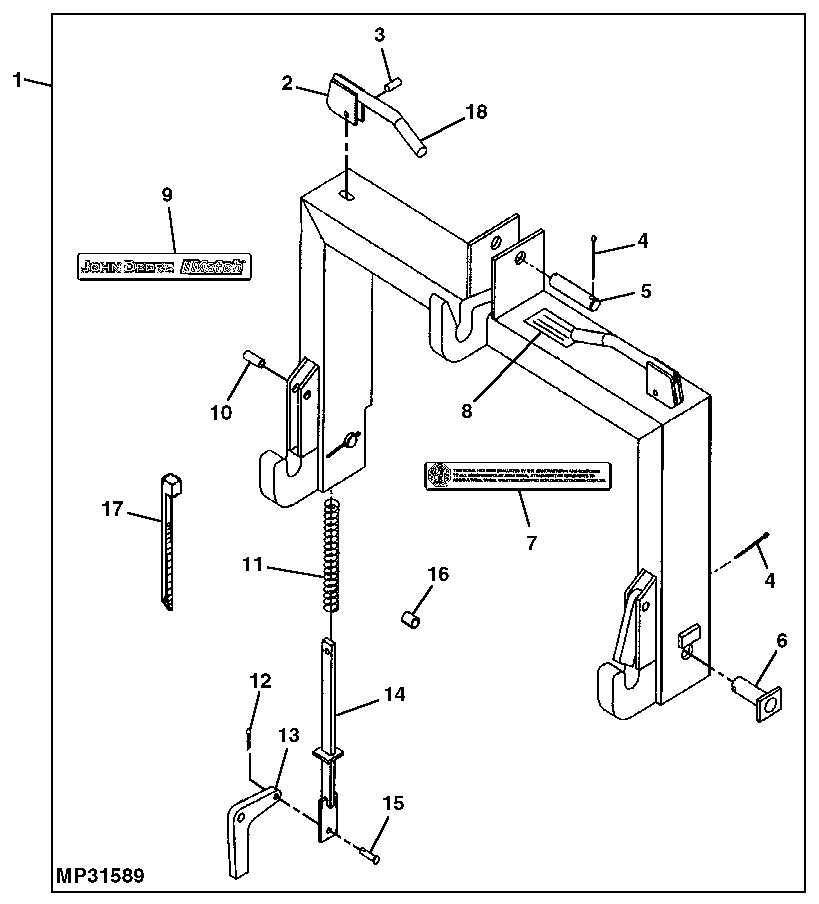

Here's the picture of a JD QH
Item 6 in the picture is what I think you're talking about.
Part #: PM9206
Description: Lower Link Pin
You can get the part numbers here https://jdparts.deere.com/partsmkt/document/english/pmac/5998_fb_Hitches_Quick.htm
and do a search on https://jdparts.deere.com
Price comes up as $6.83
Actually I was expecting the pin to be like the ones on my JD CAT 2 QH. The "flags" on the ends are drilled for a retaining bolt.
