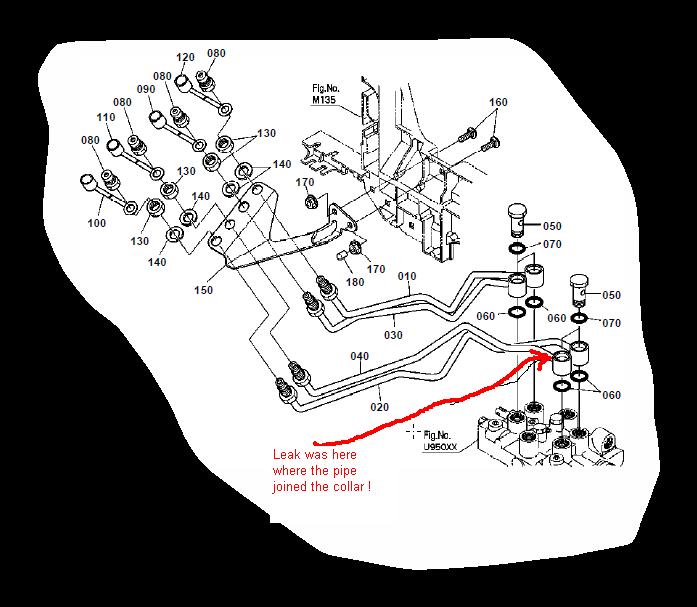

I have been working my BX25 pretty hard these days with lots of loader work and about a week ago I sprung a leak from one of the O-Rings on one of the connectors on the loader control manifold located down by your feet. The O-Ring was destroyed. Of course, the dealer says they have never heard of any problems and gave me a new O-Ring. It is now leaking again. I have not had the time to take it apart yet to look to see if it is the same O-Ring.
I have found some other posts of users with their BX24 and this same issue. The issue appears to be an incorrectly machined fitting for the pipe to the quick connect. The resolution appeared to be a replacement pipe.
Did this solve the issue? I need some ammo so that I don't waste my time trucking my machine into the dealer for him to just replace the O-Ring again and send me on my way only to be back again for the same problem.

The connections to the manifold have 2 O-Rings. An upper smaller one and a larger lower one. The lower ones are blowing out. I put a hydo pressure tester on the tractor and in is around 1950 PSI which I believe is in the expected range.
After taking it apart again this morning, it is not the same one replaced last week. Luckily it was another one of the front ones that are easy to get at. I am little worried about this being a common occurance.

After much research and some help from member posts on this board, it was determined that the hydraulic lines going to the manifold are deffective. They have an incorrect bevel and this causes the tractor to eat O-Rings. My BX25 is at the dealer as we speak getting all of the lines replaced under warranty.

Well I talked to the dealer and he sent a mechanic over today to replace all the "o" rings. But on closer inspection found a leak where on one of the loader lines where the tube attaches to the "collar" (see attachment). Tried to get the part off but finally put it back together and she's off to the shop for repairs. They have to order the part, so my pile of loam will sit a little longer . Sure hope KUBOTA covers some of this , my warranty ran out in May. Is this the "flare joint " others have mentioned because my dealer stated that all he knew was that Kubota did a lousy job of installing some of the "o" rings. Thanks again for all your help here - I have a habit of "listening more than speaking on here"

Replacing O-Rings did nothing for me except it bought me 2 weeks before I had a leak again. In my case, all of the lines need to be replaced as the flare on the fittings is bad and they will chew up any O-Ring you put in there over time.
My dealer called Kubota and they know of this defect. The fix is to replace all of the lines.

My BX2350 blew out an o-ring in that manifold. Referring to the drawing posted by bubblehead, mine first blew ring #070. Dealer came out and replaced it.
It held up for a few hours but then really started hemorrhaging fluid out of the lower seal where ring #060 is located. Dealer took it in and fixed it and so far it's held up for another 20 hours including moving 10 tons of gravel.

Had the same problem just the other day but it wasn't just a leak as the whole oring for the bucket dump blew out and I lost over a gallon of hydro oil like right now. BTW A Five hundred pound rock hits the driveway pretty hard when dropped from about three feet.
Lots a luck with trying to remove the fittings without taking half of the tractor apart as the battery case is just about an inch above the fittings and is part of a large aluminum casting to which most of the tractor is bolted . You can replace the bottom oring but not the top. There is however a solution and that solution is called an angle grinder with a cut off wheel, takes about five minutes to cut the hole in the base of the battery compartment as opposed to five hours taking things apart. After the hole is cut it's a piece of cake getting at the fittings with a ratchet and a one inch socket. Strange how some things on a Kubota are metric and some are Imperial.
The lower orings cost .80 cents and the upper ones are $1.35 and the screw in fittings are $5.47 each, not sure what the lines cost as I replaced all of the orings and the screw in fittings but not the lines, hope this fixes it, if not the lines will have to be replaced as well.
This seems to be an ongoing problem with kubota hydraulics, in some cases replacement of the rings has fixed it, in some both the rings and fittings, in others the lines have to be replaced as well and in still others the entire valve body has had to be replaced. Anyway you look at it it sucks because if you can't rely on your hydraulics there is no point having them because it can get real dangerous real quick.

Sorry for keeping reviving this thread, but I have good news.
Because this website allowed me to see the other tractor owners that had similar problems, I was able to convince my dealer to research this more.
He found some sort of technical bulliten did exist and he ordered me the four aluminum replacement tubes, that have better flare design so that they fit over the o ring system better of the control valve.
Got my tractor back this week and because it was followon work to a previous warrnaty on my 2008 tractor, they covered the cost.
