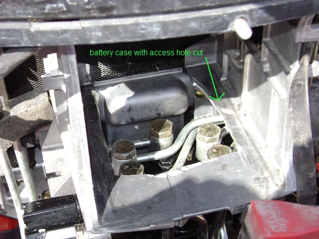

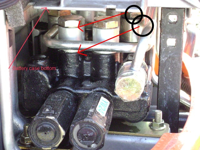

Had the same problem just the other day but it wasn't just a leak as the whole oring for the bucket dump blew out and I lost over a gallon of hydro oil like right now. BTW A Five hundred pound rock hits the driveway pretty hard when dropped from about three feet.
Lots a luck with trying to remove the fittings without taking half of the tractor apart as the battery case is just about an inch above the fittings and is part of a large aluminum casting to which most of the tractor is bolted . You can replace the bottom oring but not the top. There is however a solution and that solution is called an angle grinder with a cut off wheel, takes about five minutes to cut the hole in the base of the battery compartment as opposed to five hours taking things apart. After the hole is cut it's a piece of cake getting at the fittings with a ratchet and a one inch socket. Strange how some things on a Kubota are metric and some are Imperial.
The lower orings cost .80 cents and the upper ones are $1.35 and the screw in fittings are $5.47 each, not sure what the lines cost as I replaced all of the orings and the screw in fittings but not the lines, hope this fixes it, if not the lines will have to be replaced as well.
This seems to be an ongoing problem with kubota hydraulics, in some cases replacement of the rings has fixed it, in some both the rings and fittings, in others the lines have to be replaced as well and in still others the entire valve body has had to be replaced. Anyway you look at it it sucks because if you can't rely on your hydraulics there is no point having them because it can get real dangerous real quick.

I took the tractor apart as far as I dared and the only way to get at the B1 control valve that is leaking (bucket boom) is to consider cutting the battery box away like David did , or really tear down the tractor much more. I could even see on the B1 valve a piece of the o ring sticking out, where it is now weeping out oil. Will blow soon I imagine !
I think I will write a long letter to my dealer suggesting kindly that it seems like there might be a manufacturer problem with BX24, BX25 and BX26 control valves (refer to TBn history I found too) and ask if there was any TSB (technical service bulliten) issued for North America in regards to maybe getting replacement upgraded tubes and or oring system.
I will leave it to their discretion on whether it is a followon to previous warranty work. At this point it is not the cost , it is the fact that o rings seem to last only one year on my bucket boom control valve (B1 in the workshop manual.

I had the same repair done (warranty) to my bx24 last year, I practically had a fight with the guy because they told me that they would only change the two loader lift steel lines under warranty, and that kubota would not cover the others. Their reasoning was that the higher pressures/failures were seen on the lift rather than the curl lines because of the increased pressures found there . I told them and every kubota number that I could find that this was bullcrap the lines were manufactured WRONG. Just because they did not fail did not mean that they are not defective. The drilling out the battery box is a good idea However on these machines the larger problem is the steel lines that were made wrong. I changed about 3 orings on my bx24 and finally had enough and drove the 1.5 hours to my dealer with a borrowed truck/trailer to get the repair done. Knock on wood it has not blown out like the origional lines/orings. The dealer after some time finally admitted that there was a TSB on this issue which indicated the lines were manufactured with an incorrect bevel which caused the o-rings to not seat well. Good luck with the problem !!
   / BX25 Loader Manifold Leak #18
Romas right about the "Bullcrap". If Kubota has issued a TSB then they know full well about the problem and should pony up and fix it, warranty or no warranty as it's a screwup on their part and has nothing to do with how the loader is used or what part of it is being used. My dealer although very helpful and polite gave me much of the same runaround so I finally did the job myself. It wasn't all that expensive, but thats not the point. The point is that it should not have to be done but it's an imperfect world and mistakes happen, however if it's a mistake on the part of the manufacture then the manufacturer should have to fix it.

Sorry for keeping reviving this thread, but I have good news.
Because this website allowed me to see the other tractor owners that had similar problems, I was able to convince my dealer to research this more.
He found some sort of technical bulliten did exist and he ordered me the four aluminum replacement tubes, that have better flare design so that they fit over the o ring system better of the control valve.
Got my tractor back this week and because it was followon work to a previous warrnaty on my 2008 tractor, they covered the cost.
