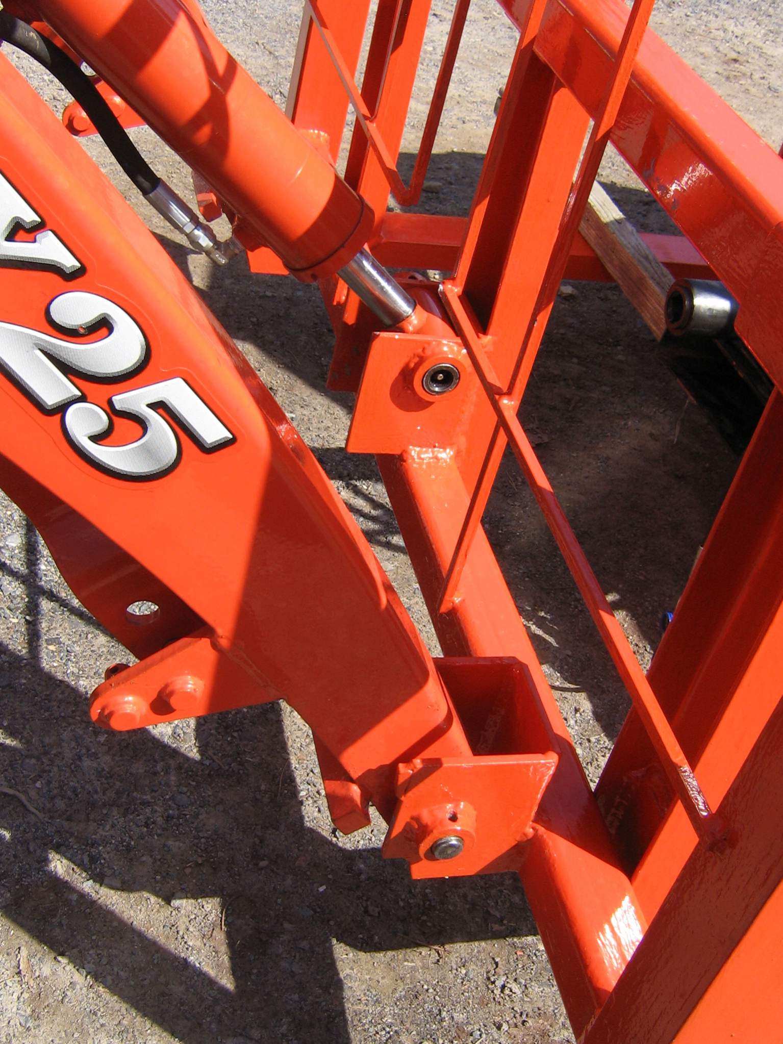

Pictures of my first major BX25 project... pallet forks. If I said it once, I've said it a thousand times... I LOVE that tractor! :laughing:

nice design!:thumbsup: I have a question tho. do you have difficulty in trying to install the pins with guard up that high?

radioman - I am afraid I do not totally understand your question. I have no trouble with the pins. Perhaps an additional picture will help make it clearer.

Hi Yooperman,
Your forks are the best I've seen. Kudos on the Kubota forks.... I was looking at the last picture you show with the detail of your attachment point. What are the details for the weld where the PIN goes through the mount point on the U channel for the hydraulic arms on the BX25?

Thanks for the kind words. If I remember correctly, I took the placement for the mount point directly off the FEL bucket. In other words, I measured the distances on the bucket and just replicated them for the forks.
If that doesn't answer your question, I'll try again.

Thanks for the reply. I attached a picture (I hope) of the area that I am curious about. I was wondering what you used for this? Is it a small piece of steel pipe welded to the side of the mount for the mounting PIN to go through and a hole drilled in the side of the pipe for the clevis pin to go through? Thanks again.......
That is exactly what it is. I was lucky enough to find pipe with an undersized hole so that enlarging it for the pin was fairly easy. By far the hardest thing for me to do was to drill the hole in the pipe for the clevis so that it was exactly centered so as to line up with the hole in the attachment pin.

I was just thinking about the problem of getting the hole lined up. Your picture made me wonder if you could start with a hole on one side of the tube, then insert the pin and use the drill bit to get the 2 holes aligned, then drill thru the other side while the pin is still in place. Seems like that would solve the problem, but I haven't tried it. You would essentially be using the pin as a drill guide.
A v block that is carefully setup on a drill press will hold round piece in place as well, and is a good place to start to get the first hole aligned. I've always found it is hard to get that first hole to start straight thru, seems like it always wants to wander a bit, even if (or maybe because) it has been center punched first. If everything is set up right the hole should go dead center thru both sides. Of course, this works best with longer pieces of stock so there is enough to clamp into the v block. Also, I think it might work better to get the hole started if a center drill is used without center punching, just rely on the setup to have the workpiece center under the bit. Center drills are short and very rigid, which helps eliminate any tendency for the bit to wander.
