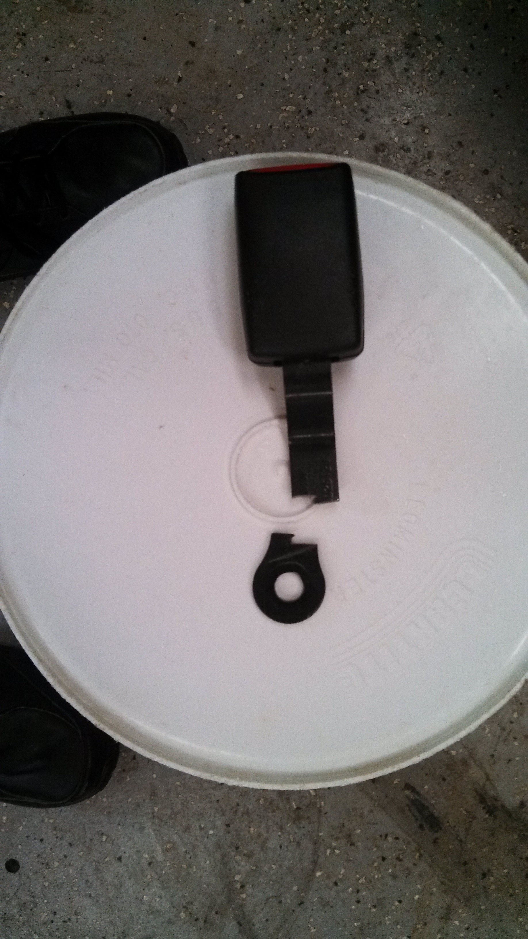

The Seat belt on my BX broke. It's been a few years but I posted pics at the time. No accident, I assume fatigue. The metal on the latch side just broke. I replaced it and e mailed Kubota pics if it thinking they should give me a new one. Never heard a thing.
   / BX25 SEAT BELT FAILURE #36
Here is a pic of mine that broke, glad it didn't happen during a roll over.

Cannot believe some of the thinking going on here...........seat belt worked
If you need to get out that fast may I suggest the ACES II ejection system or a Martin Baker system
David
   / BX25 SEAT BELT FAILURE #39
Think of it this way, instead of a slow roll onto your side what if it happened on the side of a hill and you rolled several times. Would you want that seat belt to unlatch if, say a stick or something else hit the release button in the middle of rolling? I would say not. A seat belt is a compromise, like most everything in life. It can either hold you securely in the seat no matter what or risk releasing too soon. Sure there are times when it can be a real issue, say rolling into a pond or if your tractor catches fire and you need to release the belt but that's the price to be paid for a system that wont fail during a roll. Also seat belts were designed for cars to prevent injury in accidents involving more than just rolling over then were adapted to equipment like tractors.
