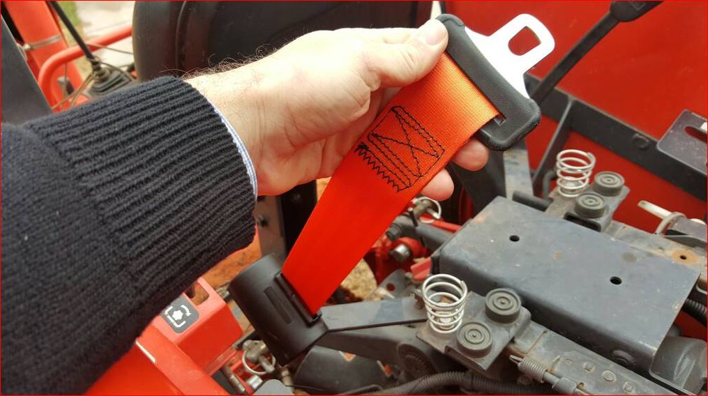

These guys are actually manufacturers of seat belts. WWW.SEATBELTPLANET.COM I got a lap retractable seat belt and had it made in orange. The orange wasn't an exact match but close enough (and of course completely unnecessary but...why not!?) :)
I'll see if I can find a pic and post it later. I think I posted it once on this site but might have been on orangetractortalk. Either way, the lever style looks like a great option as nothing would likely get stuck in there.

The seat belt mostly worked but not entirely. It is also supposed to release with less than 30lbs of force applied to the release button on the buckle while it is also under load, for example after an accident. Enjoy: Seat Belt Buckle Release Force: Cause for Entrapment?
Here is my orange seat belt geekery!!
