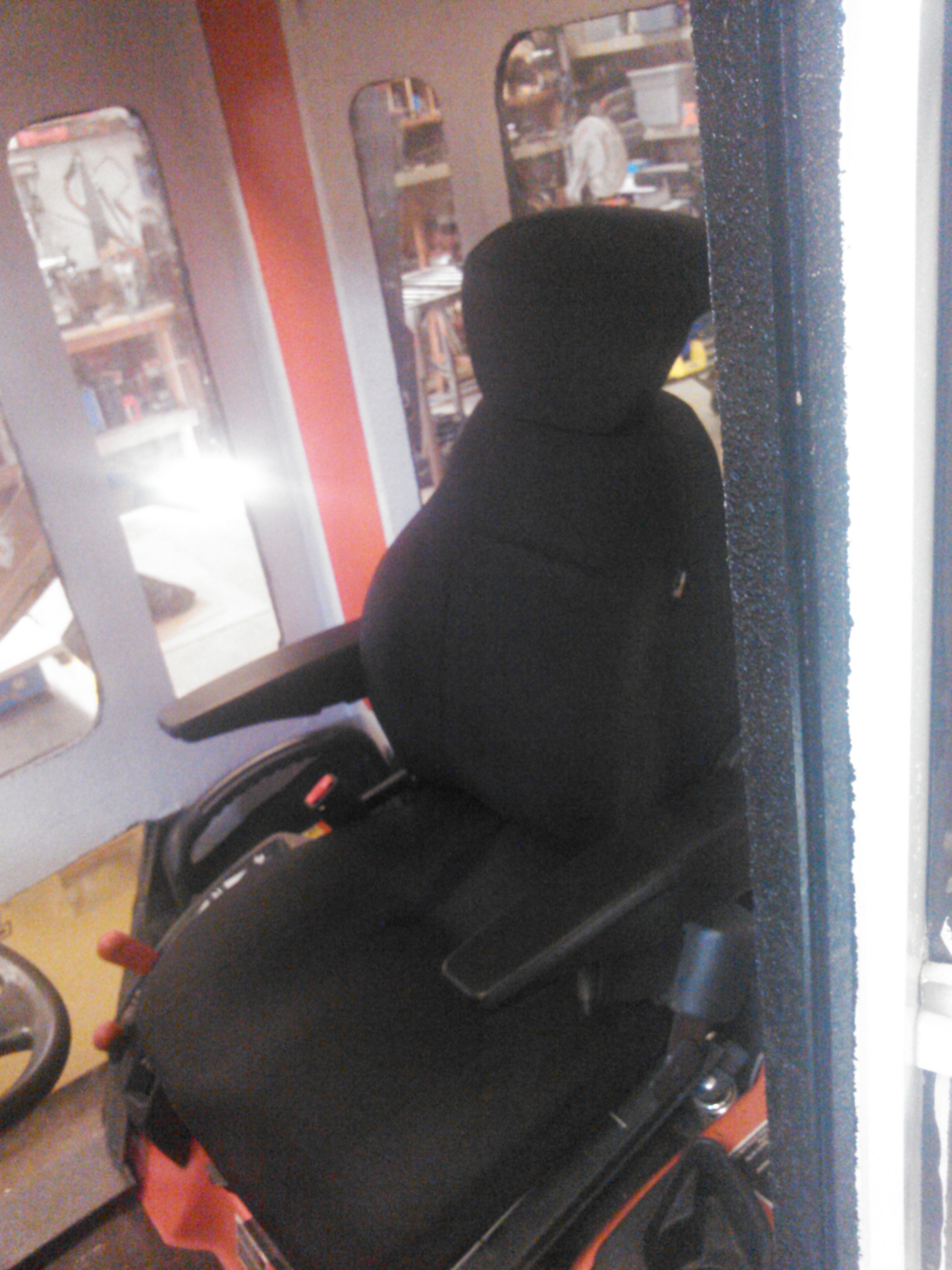

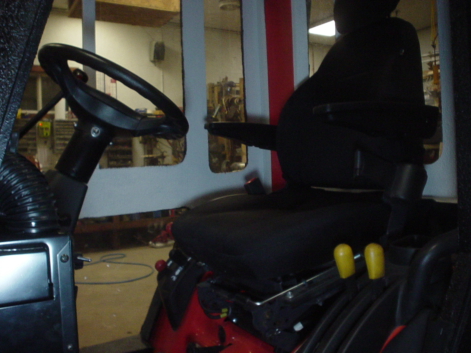

BX25D seat is priced way too high from dealer! Look at 'SURPLUS CENTER.COM'. I installed the 440 HIGH BACK CORDURA item #1-3208 @ $224.00.
They have a vinyl high back too for $204.00. #1-3572.
All you do is take off slider from new seat, use 1/4" longer bolts/nuts on 2 front mounting holes. on rear I used 2 pcs. of 1/8"X3/4" flat approx. 6" long with slight 'S' bend to reach from factory bracket to seat. The nice part is the seat belt and safety switches are all maintained. I think new seat and raising my steering wheel are the 2 best mods I've so far. NCM_0027.JPGCAB MISC 006.JPG

These look like real possibilities. Is your seat back adjustable with lots of adjustments or like 2 or3? Thanks.
/ BX25 seat replacement #5
All kinds, forward & back, unfortunately with cab on it will only go back so far. also head rest is adjustable.
