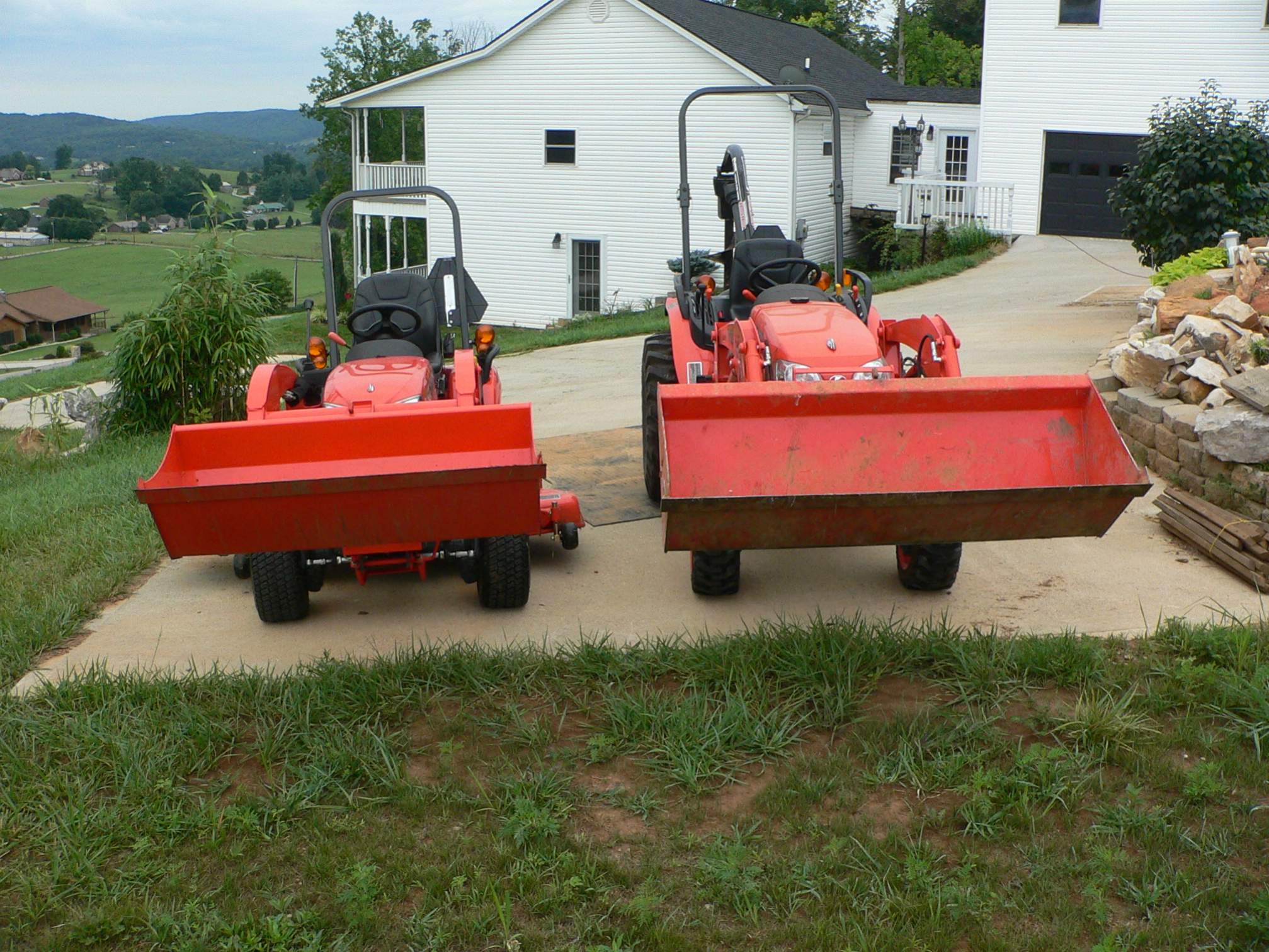

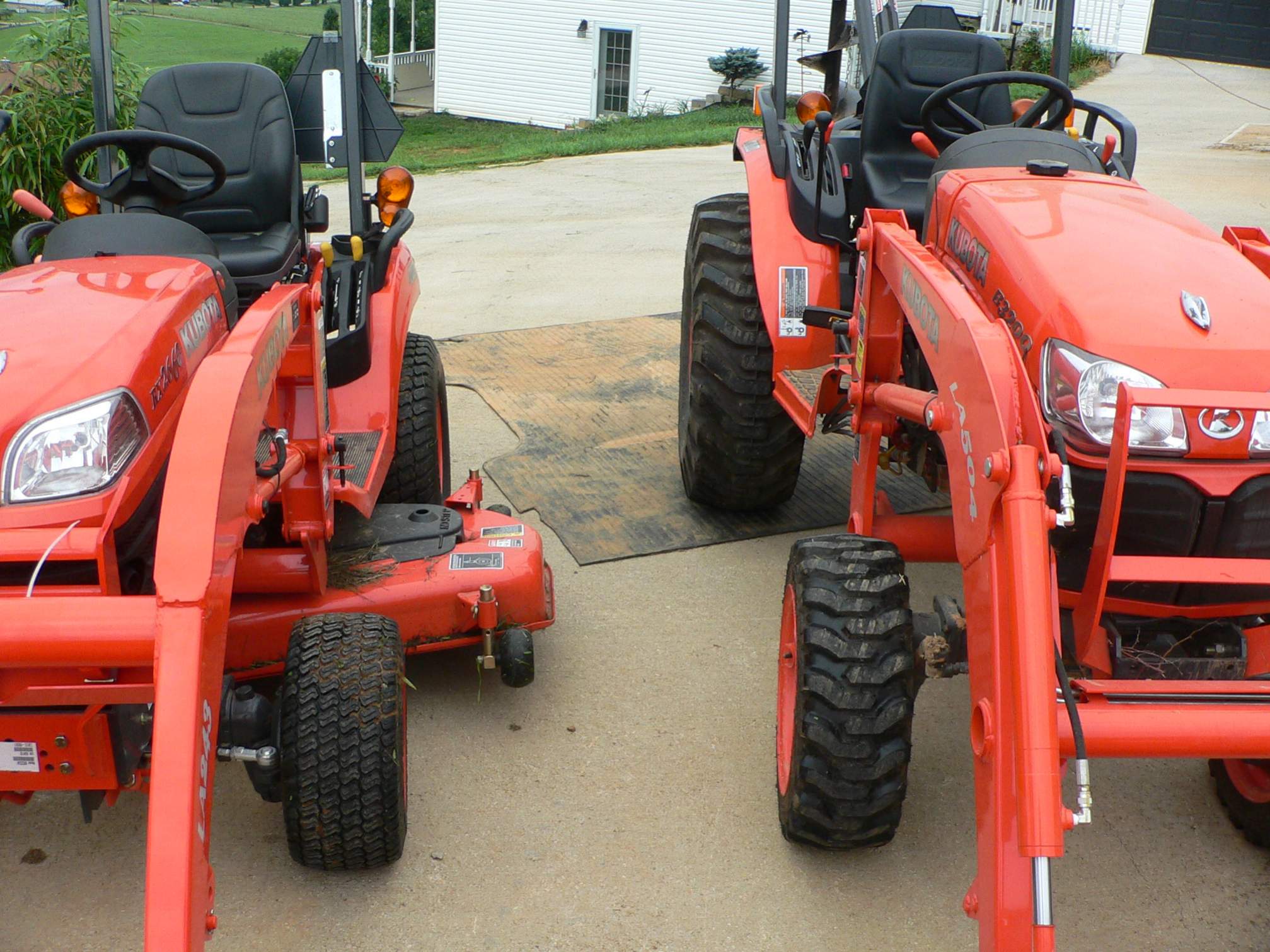

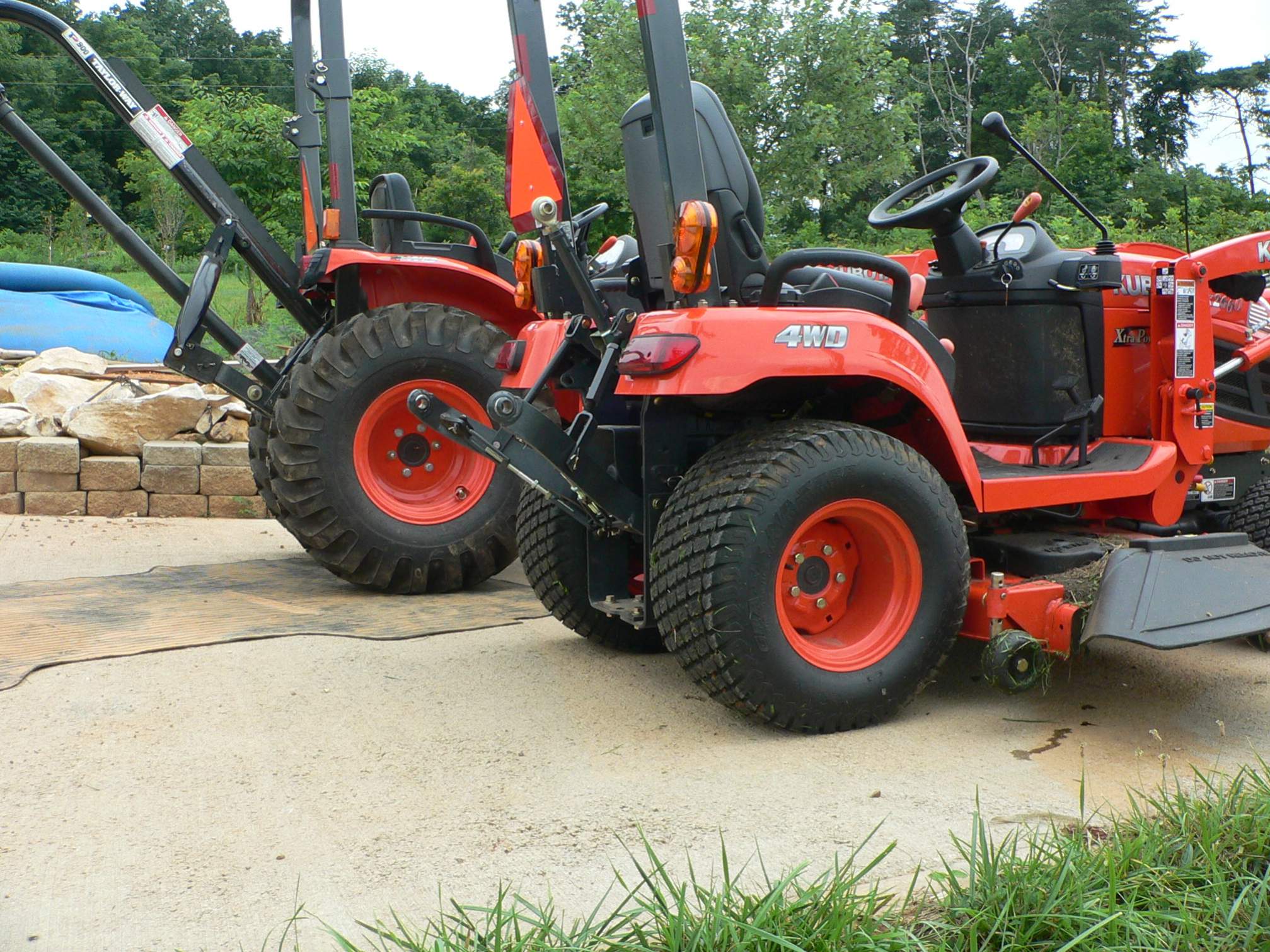

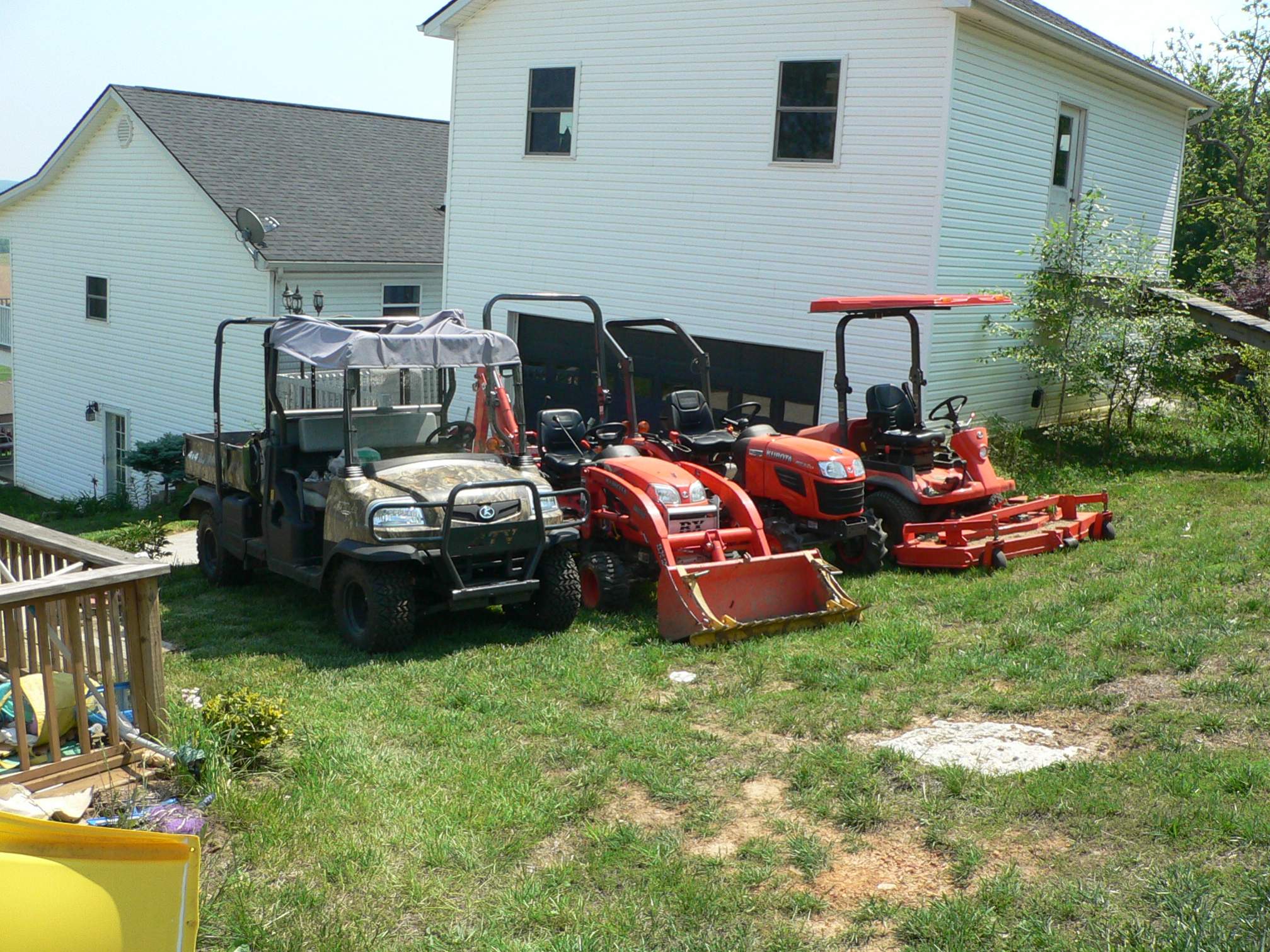

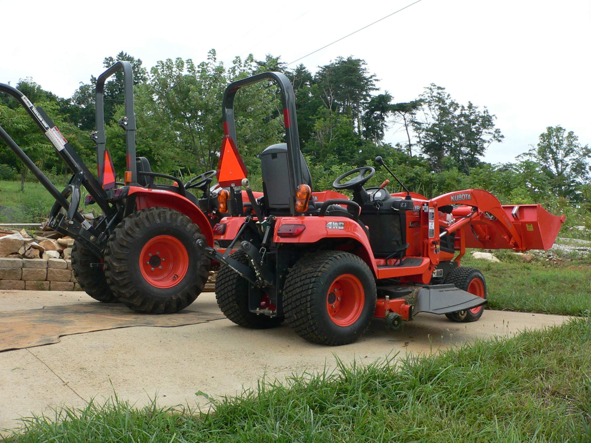

BX side by side with B.
BX2660 vs B3200 BX25 vs B2320
Ok, you have the perfect solution :D buy them all.. only wish i could :D

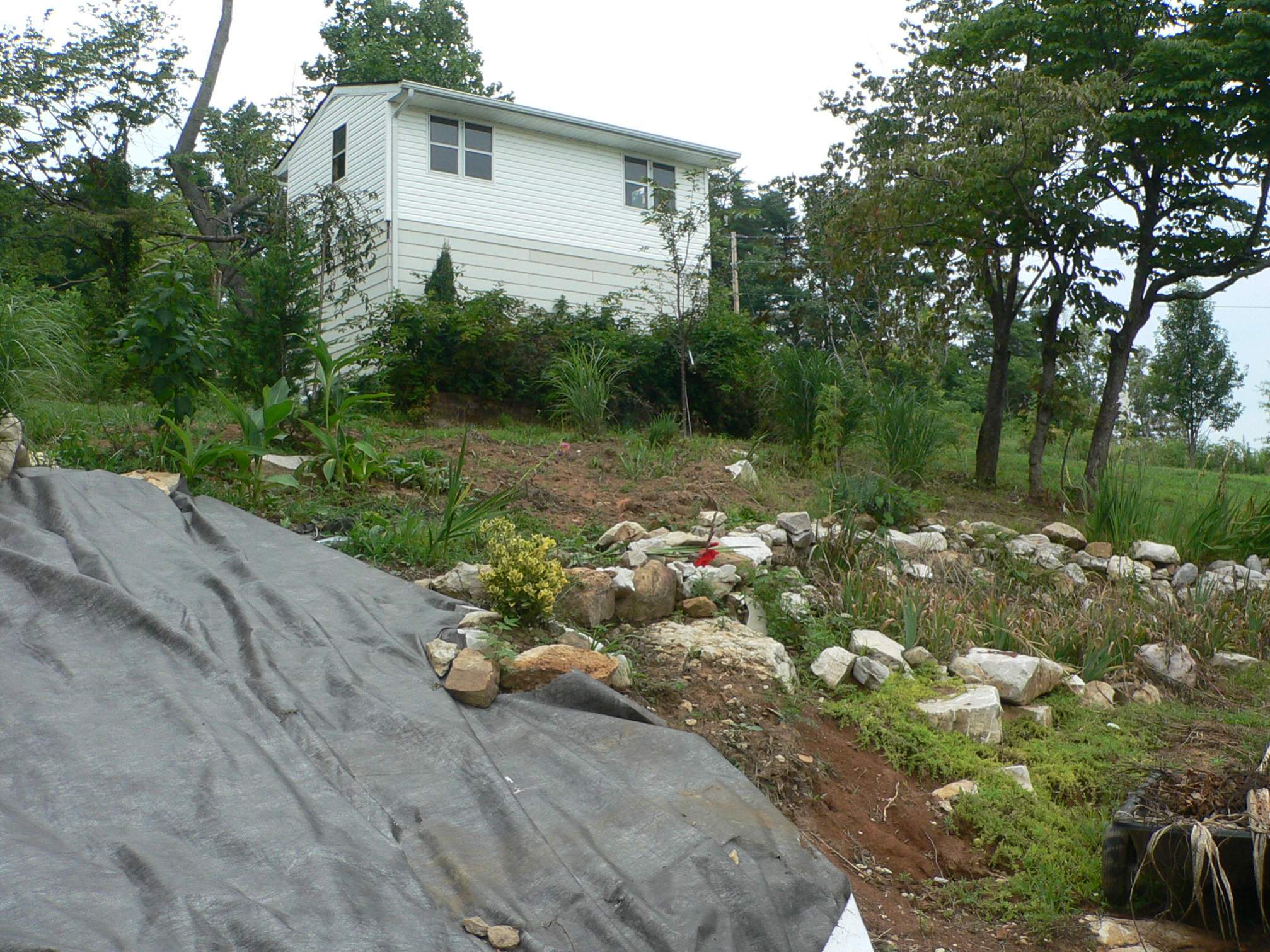

Looking at your land, id say its quite similar to the layout of my own , even the slopes. Do you have any issues with the BX (or the B) mowing across the top slope, by the raised garage with the open door? This picture
How about in front of your house where it appears to be a bit steeper?
I have an angle gauge around here somewheres... if i can find it ill give some better information re: slope.
BP: (and everyone) Thanks. Ill give your comparison a read .
Has anyone directly compared a BX to a GC?

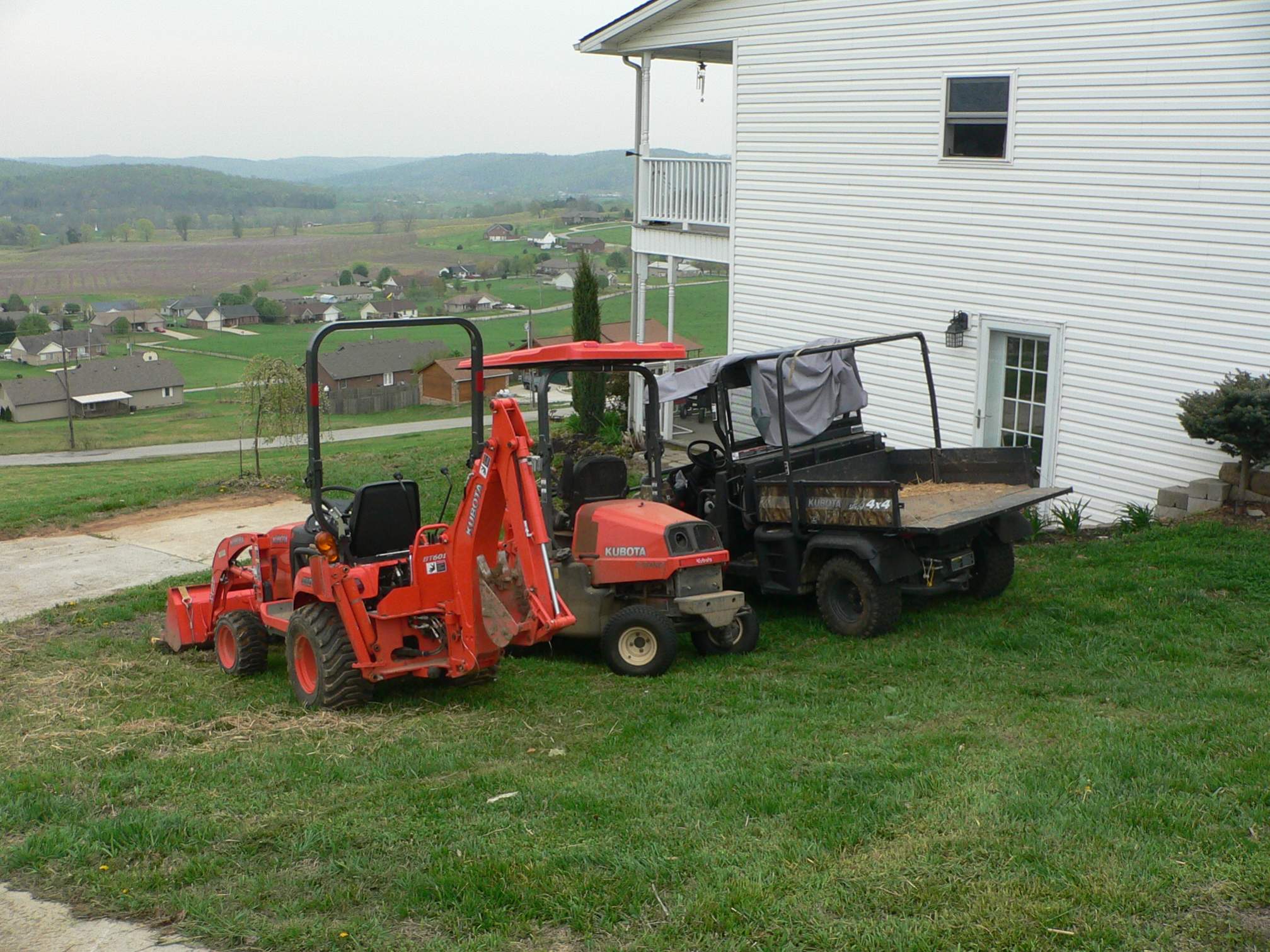

I have used BXs for mowing except for a B7800 with 6'RFM I used for front yard which is flater, not flat but flater.
I currently have the F3080 4wd for all of my mowing. It's the most stable mower Kubota and maybe anyone makes.
The best BX for mowing was a BX1500 (smaller and closer to the ground) and then all the other BXs.
The Bs that I have owned and own do not feel as stable to me and they aren't, in my opinion as any BX. I once traded for an L3240HST and it was a short term machine, very scary on hill side sitting so high off of the ground.
Get a BX2660, MMM and under carriage plates or leave the MMM on all of the time which is what I did. If you want a BH then get the BX25 with MMM and take FEL and BH off when mowing.

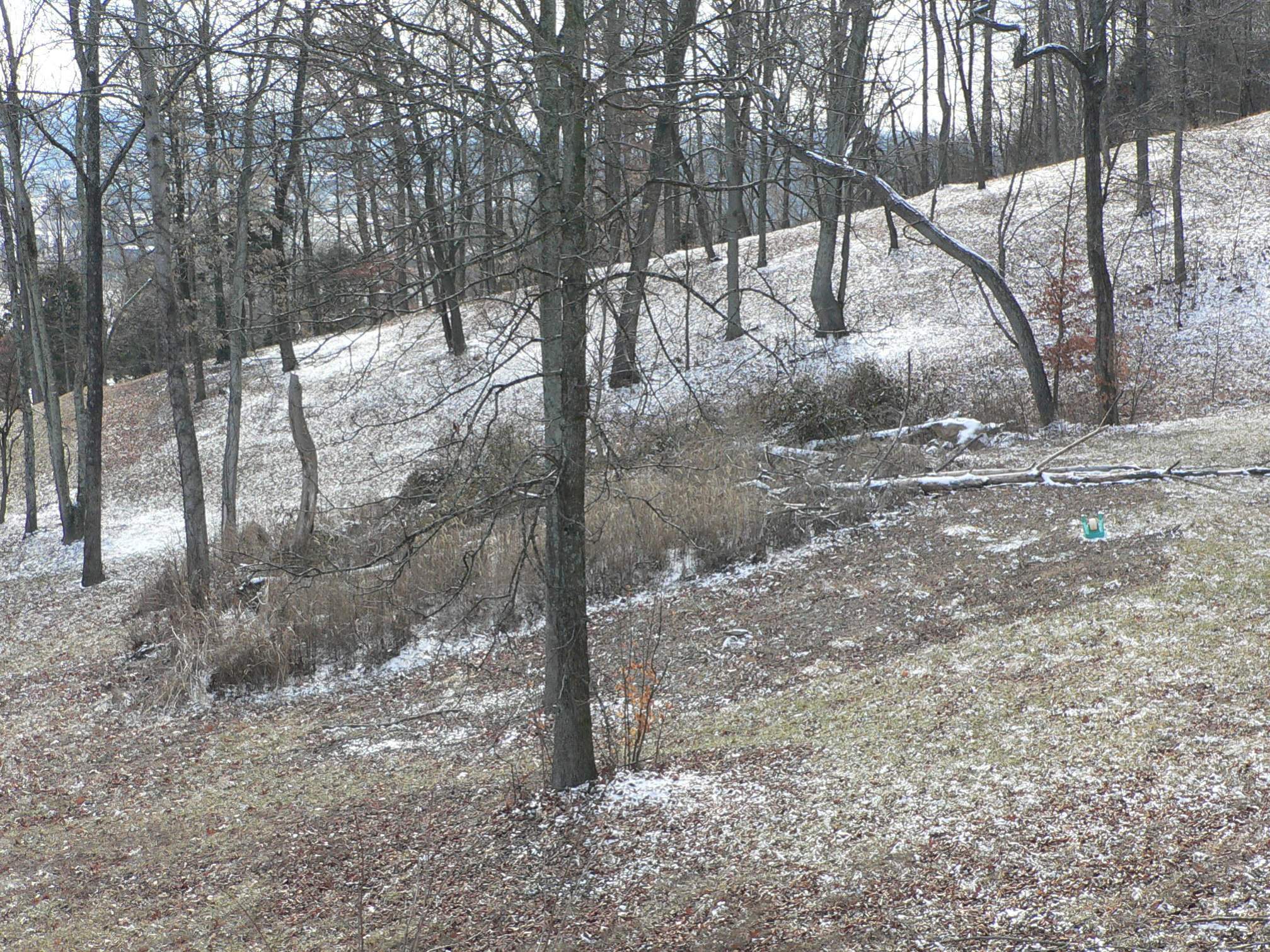

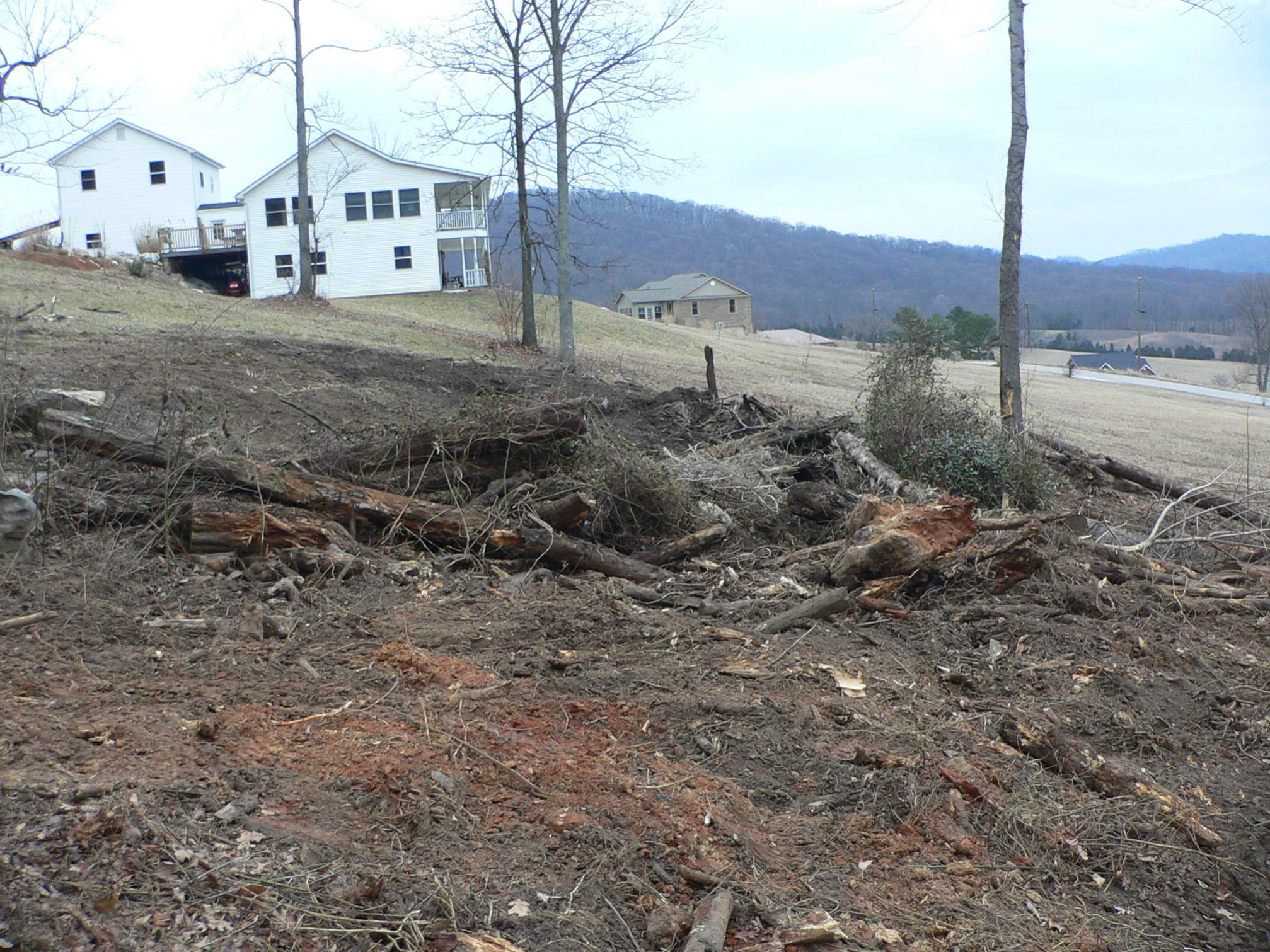

Johnthomas, when you mow the upper area, do you go vertically or horizontally?
I know vertically is ideal (and safer) but even if i go vert, id still have to turn at the bottom of the hill (property doesnt go to a "flat" for turning). Currently i mow horizontal, with my butt hanging over the uphill fender :D
   / BX25 vs B2626 with backhoe #17
I have a BX with a 60" MMM. I'm pretty happy with it. The main reason I bought it was was for mowing hills at my house. A lot of what I mow is a cross slope, and I filled the rear tires, which I thinks helps. The steep hill, I mow up and down, not cross wise. I have backed up and down this hill when mowing, this might be an option for you. I keep the nose up hill when doing this. You just want to make sure you have it in low range and 4 wheel drive when doing this.
   / BX25 vs B2626 with backhoe #18
Actually the upper area near tractor building is almost flat on the front (open) side. With my F I mow vertical, horizontal and then diagional all of it except for one spot that is really, really steep and I go up it and coast back down. Right in front of my house is the steepest other than the one corner spot near my far tree line. I mowed the front of houset up and down with BX2660 but some times mowed it cross the slope with the BX1500. I would never mow any of it cross ways with a B.
Here are some pictures around my house but slopes/angles are hard to see/judge in pictures.
