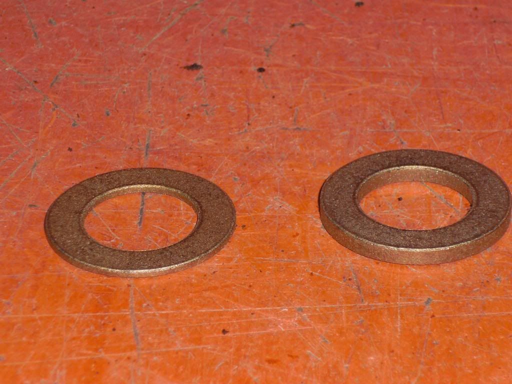

Sorry to butt into your conversation being a Newbie and all but I was surprised to see you guys talking about the FEL on the BX25 and the new D, I just received a QA for the BX25D and installed it on my BX25, all seemed to fit OK except I had to install a 3/4 inch washer on the outer edge of the lower pins, I found the QA buss was a bit wider than the original bucket, other than that it seems to work OK and I am going to make my own forks and front snow Blade, after looking at the pics 4shorts posted I won't be posting any of my handiwork, what I make is good for workin not looking. Thanks for your time, Newboss2
   / BX25 vs BX25D FEL?
#16
Newboss2,
This is the problem I ran into with the attachment issues. Sounds very similar to yours.
Gap between my FEL arms and the new QA.
I filled the gaps with bronze thrush washers. Mainly to keep grease from leaking out.
I used two different thickness on the arm pins. The center pin was close enough so I did not use anything.
Your BX is a new BX25D? Strange that there is a common fitting issue.
I am looking for a blade right now. I just need to weld up the forks. :D
