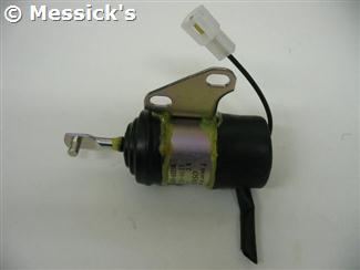

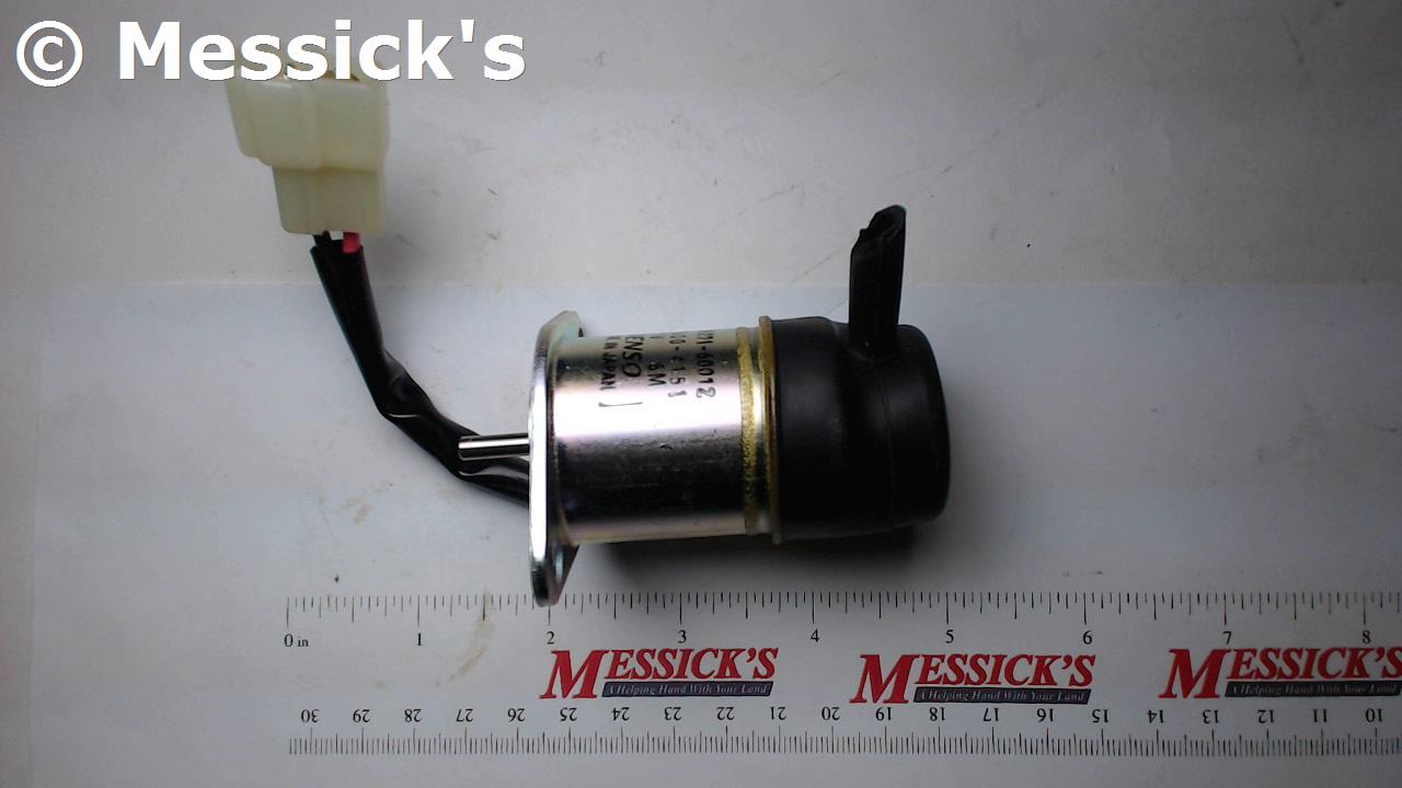

So your saying the 902's have an external solenoid that pulls the stop lever on the fuel injection pump? Interesting.
A pic would be nice. That solenoid could be the OP's problem. Does it hold the lever in the stop location for a similar duration as the D905 i.e. 10-15 secs., then release it back?
The shutoff system on my 04 BX23 w/the D905 has worked as designed without problem, must have been a change in the fuel injection pump that necessitated how the electric shutdown was redesigned.for the D902 series.
   / BX25 will not turn off #14
The D905 solenoid has ears where it bolts to the engine and the plunger pushes against the arm inside the injection pump holding against a spring that would push the arm into the stop position. When power is cut to the solenoid the spring pushes the lever and the engine stops.
The D902 solenoid is mounted adjacent to the speed control lever and pulls the lever into the stop position when energized. The safety switch circuit takes power from the key switch and there are a few parallel loops within the circuit that will bypass the PTO lever if the seat is raised forward, but any break in the circuit makes remove power to the Keystop TImer Relay making it activate for the required time to energize the stop solenoid and stay energized long enough for the engine to come to a complete stop (this is the circuit with the 5amp fuse that people find blown).
David
D905 solenoid on left D902 solenoid on right
