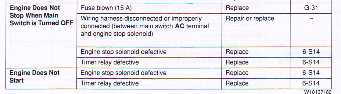

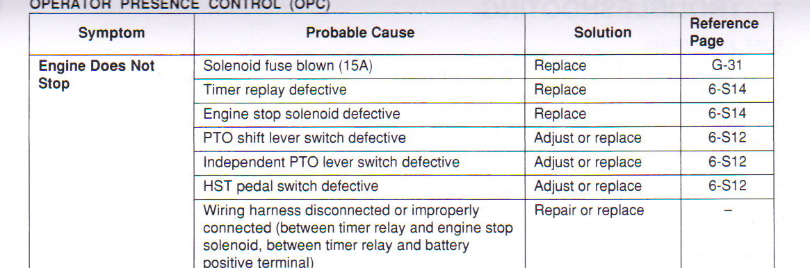

Don't know if this will help but my WSM for BX24, which should be close has these options to check.

After rereading the first post if you pulled the 20amp fuse & killed everything, something is wrong in the fuse panel or wiring around it. My schematic shows that fuse only controls the red/black wire in the rear of the tractor for working or aux lights & normally is not connected to anything unless you have installed lights. There should be a black gnd wire along with this one taped or stored somewhere around the tail lights. Shutoff solenoid, fuel pump, & timer are controlled by the 15amp fuses.

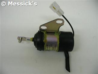

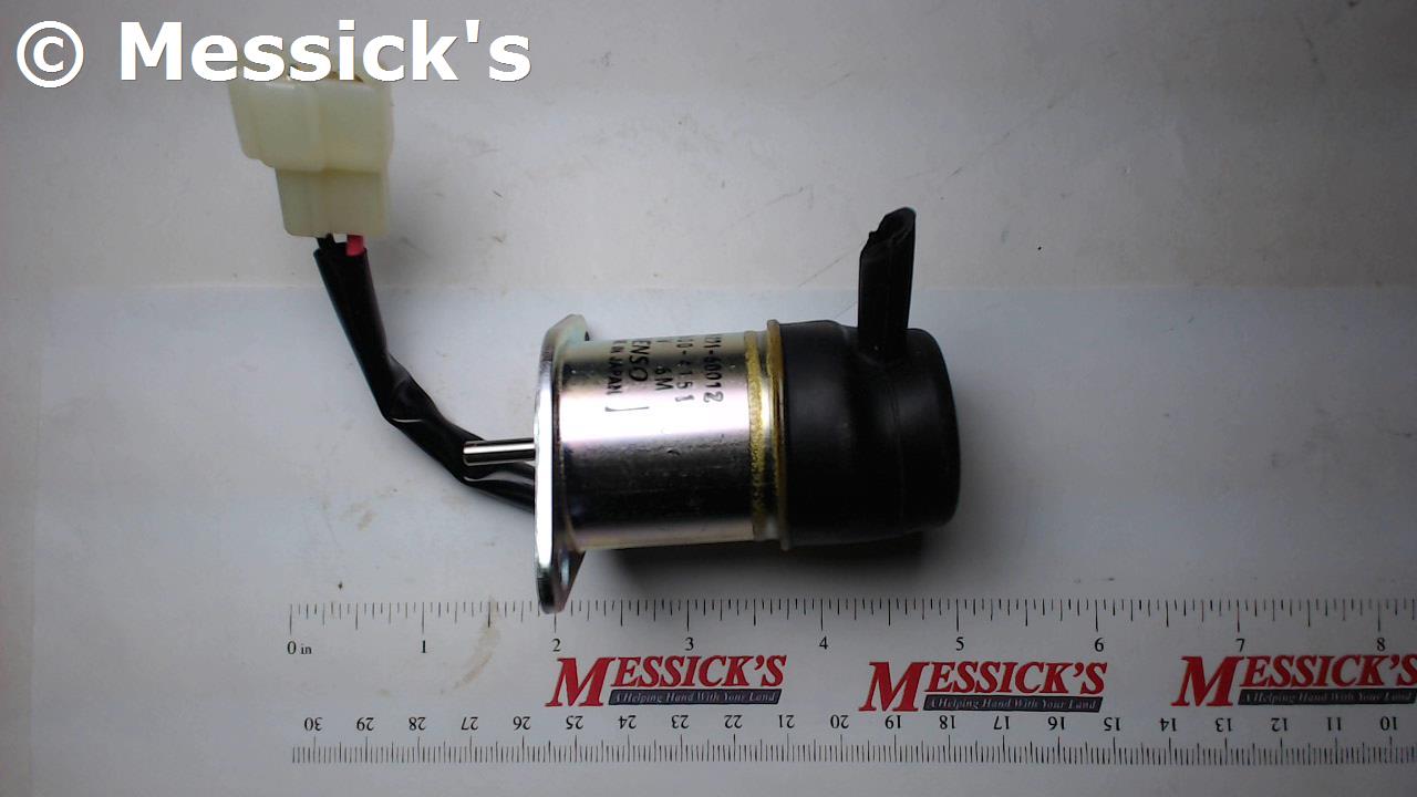

The D905 had the internal solenoid with the run and hold winding, the newer BX has the D902 "Super Mini Series" engine where there is an external solenoid that is just energized to pull the stop lever.
The Dx02 and Dx05 or Dxx05 engines use different systems, my RTV1100 with the D1105 and my L3130 with the D1503 both shut down when battery power to solenoid is lost.

The D905 solenoid has ears where it bolts to the engine and the plunger pushes against the arm inside the injection pump holding against a spring that would push the arm into the stop position. When power is cut to the solenoid the spring pushes the lever and the engine stops.
The D902 solenoid is mounted adjacent to the speed control lever and pulls the lever into the stop position when energized. The safety switch circuit takes power from the key switch and there are a few parallel loops within the circuit that will bypass the PTO lever if the seat is raised forward, but any break in the circuit makes remove power to the Keystop TImer Relay making it activate for the required time to energize the stop solenoid and stay energized long enough for the engine to come to a complete stop (this is the circuit with the 5amp fuse that people find blown).
David
D905 solenoid on left D902 solenoid on right
