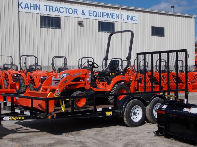

Greetings, I'll be picking my my new BX25D in the next week or so and Trailering it 150 miles home. What are the best tie down points? I'd really like to install 4 dedicated tie down rings at some point. Any pics of one properly secured to a trailer? Thanks....

I use the 4". maybe 3" wide nylon? straps (Harbor Freight). Have used them on an L, several Bs and several BXs. I have a 16' utility trailer. I hook the ends on the side rails of the trailer near an upright point or under the edge of the floor of the trailer. I strap the BX25 across the front weight with the bucket curled down on its front edge. I run the strap across the floor of the back hoe platform and strap down.
I usually swing the BH bucket to one side getting the tractor on the trailer so bottom of back bucket doesn't drag the ground. I then adjust the BH from side to side to where I can get the gate lifted and closed. No pro but been doing it with no problem for 10 years. :2cents:

I would advise you not to complicate things. I trailer my BX-25 with both buckets on the deck, the parking brake on, and one strap securing the front bucket and one securing the rear boom. You can see the straps in the photo. Regarding the parking brake, I found it a good practice to always tap the brake when I get on the tractor before throttling up. I would advise all new tractor owners to do this. If you plan on using your parking brake--and you don't do this--then you will operate the tractor with the brake on. It's just a matter of time.
Good luck with your new machine.
