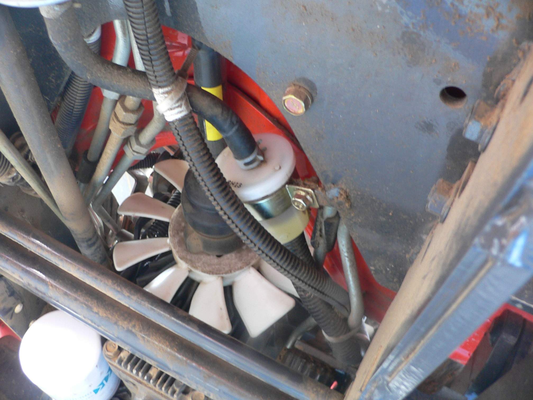

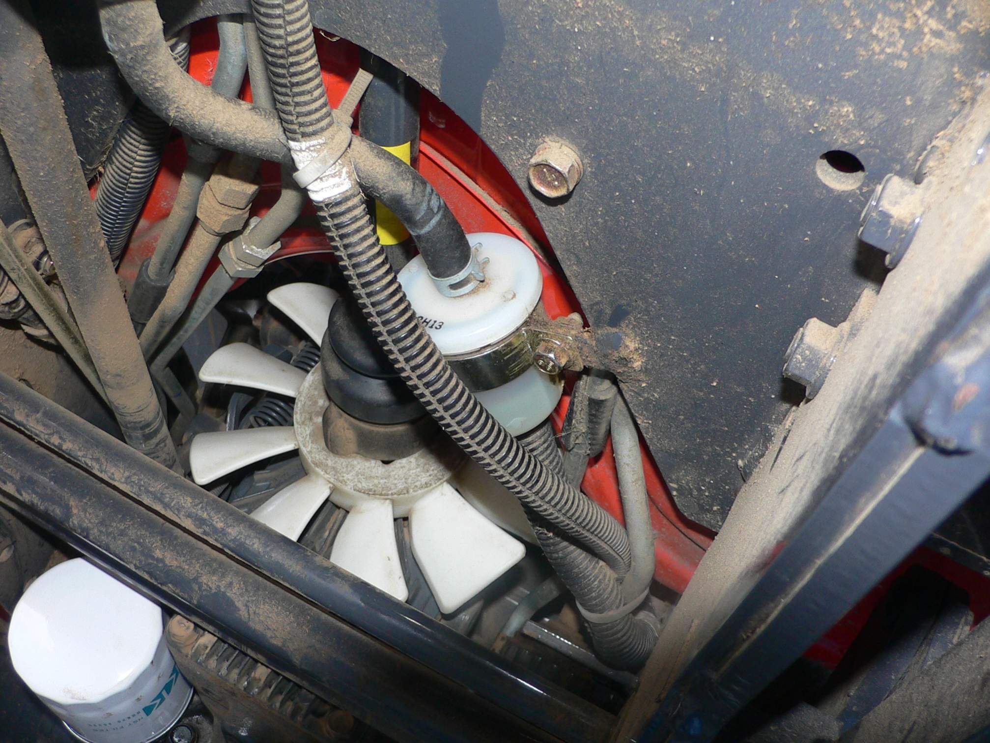

We need to have someone figure out how to replace it simply. A metal one would probably bend and also have to be replaced so someone find an easy way to replace!:thumbsup:
   / BX2660 HST fan GONE, gone, gone... #12
JT, as far as I know, the "improved" fan guard was factory installed after a certain date, which suggests yours was assembled for sale just prior to the mid course correction by Kubota. I have always felt, although I took some heat for taking this position, that this shield could only cost Kubota $10 and they should have made it available to EVERY Bx owner. Don't want to say the "Toyota" word, but anyhow, that is how I felt, and still do!!!
No problem using that photo, BTW. No problem at all.

I bought a new fan, cut out the center and then glued it into place. I put a couple of screws in to reinforce it and never had a problem. I spent $8. I can't fugue out why anyone would do more than this to fix it. It is a design flaw - no doubt about that.
