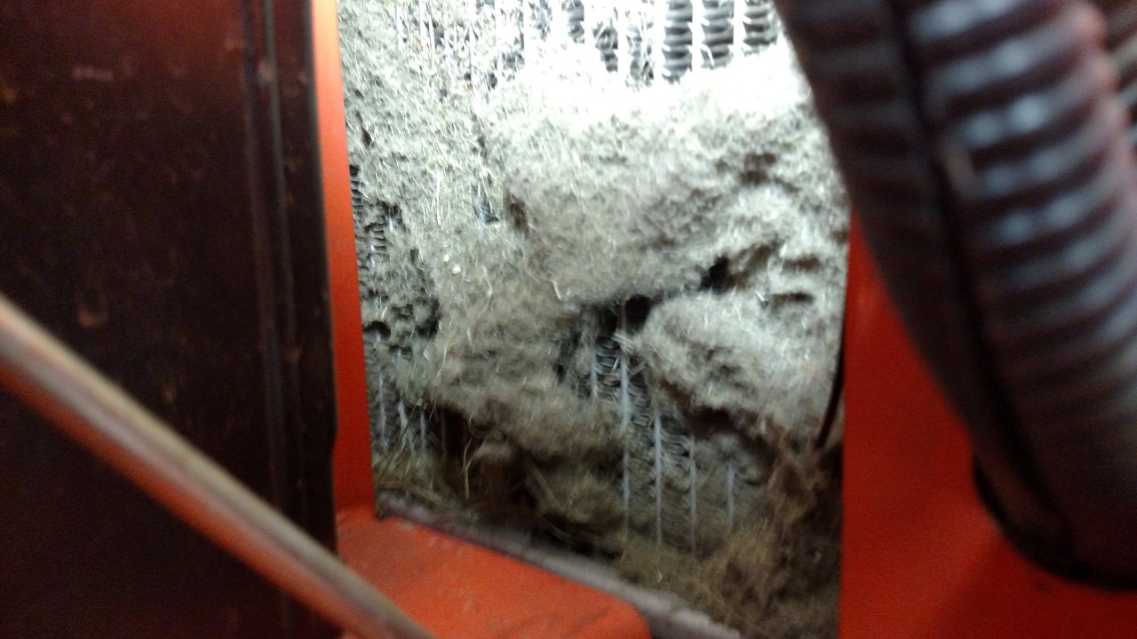

The radiator on my BX had a bunch of fuzzy stuff in it, even though the screen was clean. I have a 3 foot long wand for my air blow gun. Went in from the fan side and got is all cleaned out, It never over heated, in fact the water temp gauge only barely gets 1/4 of the way up on the gauge, even when it's 80+ degrees out.IMG_20200628_144056745 (Custom).jpg

The radiator on my BX had a bunch of fuzzy stuff in it, even though the screen was clean. I have a 3 foot long wand for my air blow gun. Went in from the fan side and got is all cleaned out, It never over heated, in fact the water temp gauge only barely gets 1/4 of the way up on the gauge, even when it's 80+ degrees out.View attachment 664732
Double check your coolant level. Low coolant will leave the temp sensor high and dry so it will read lower than it should.
