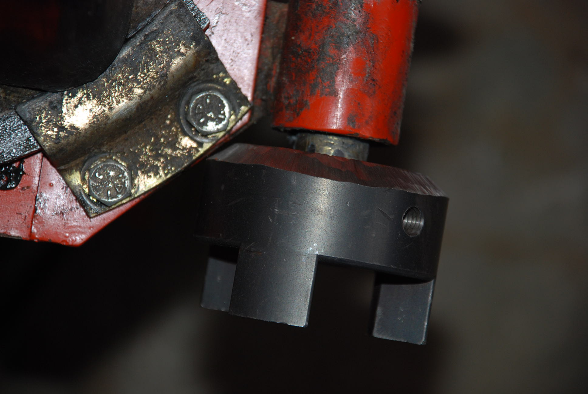

I meant to mention that one half coupling was 3/4 in. and the motor half coupling was 1 in. John

Huck,
I thought I should also mention that if you go with the half couplings on the worm gear shaft, you will likely have to grind a 45 degree on the back edge to clear the housing. My picture isn't great for this, but you get the idea. The picture also shows the coupling back on the shaft further than it ended up being, so there is more clearance than what you see. John

Huck,
