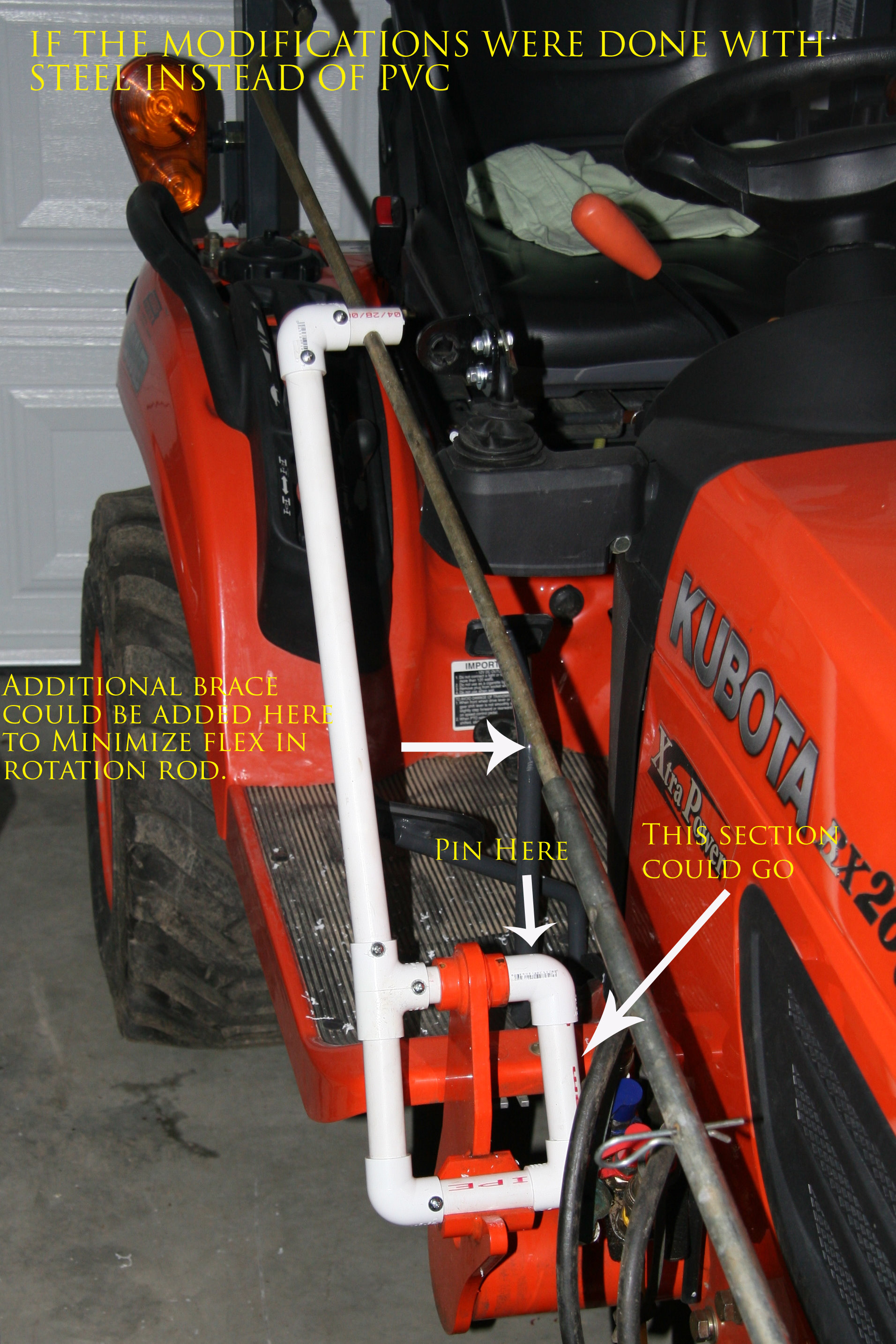

I'm looking forward to seeing a picture of it when you get it back. The Powder coat will offer up rugged protection and is a good way to go...especially at that price! :D Dyer, retired
Well, the orange isn't close to Kubota orange but it'll do (a little grease and dirt and it will blend right in.) The setup works like a charm. I had about 4 inches of snow and slush to give it an immediate tryout. Did my neighbor's driveway too.
The hydraulic hoses cost me about $100. I should have asked the guy how much before I said to make them. They are high quality and no adapters required. I played it too tight on the length. They work -- but they just make it with but a little play to spare. No problem lifting the blower because it tilts it back and gives me more slack. I "ballparked" the length while the blower was at my son's shop. Stupid of me, but I lucked out.
I used a soft aluminum screw to connect the worm gear. The hope is that if I go too far rotating the chute that the screw will break before the worm gear does. I'm thinking I may remove the chute and cut more notches so the chute can do a full 360 so I'd get a wake up call if I rotated too far, but no breakage.
Here's some pics -- and thanks for all the help!:)

Huck,
Excellent looking setup and I especially like the motor mount! It's compact, strong, and looks like a factory installation. As I said before, it sure shows when a good machinist gets working on something. The paint is close enough and the powder coat job looks professional.
I probably mentioned that I cut notches in the chute base all the way around, so I can turn the chute through 360 degrees. I will never turn the chute all the way through 360 degrees, but figured if I hadn't cut the slots all the way around, I would eventually hit the stop and tear the worm out...Murphy's law and all. I read other threads where guys have ripped the worm gear apart doing that and the motor never hesitated, so I thought notching the base was the quickest and easiest answer. If I had it to do over again, I'd have the machine shop do the notching....mine works fine, but I wouldn't enter it in any beauty contest.
It looks like your hoses will be fine as they are and if you got nervous about it, adding two 45 degree adapters to feed the hoses straight back would free up an extra couple of inches for you. I didn't remember the hoses being expensive, but the quick connects price was surprising.
It sounds like you aren't experiencing any trouble with the stick movement? When you push to the right, the chute turns right....you can feather it, etc.?
I'm very impressed and think you'll like it much more than the old hand crank setup you had. Congratulations! John

Huck-
Very clean setup .... doesn't that PYO about not getting the hose length perfect!
Given the look of strain on the hoses near the quick couplers, I would consider threading in some right angle adapters coming out of the hydraulic motor. I bet you would end up with 3 or 4 more "effective" inches of length on the hoses and I would be willing to bet several more years of life from them.
Nice work.

John,
I know I read somewhere about notching it to turn 360!:) The only thing I recall is a response that said "I can't because the hoses from the hydraulic chute deflector would wrap." and I thought "well, I don't have that problem."
I don't want to push my luck at my son's shop, but I'd prefer an experienced machinist to make the cuts. Maybe I'll just take the chute off and bring it down and ask for some quick advice on making the cuts. ;)
The stick movement is fine. I need to go to the far right (beyond the detent) when moving the chute to the right. It didn't take much getting used to. In fact, the only thing that was a little odd was when I first started to use the new setup. I felt like something was missing. It was too easy! :)

John,
I think if I had to notch my chute again, I'd have it done by the machine shop. Just to clarify, I will probably never rotate the chute around 360 degrees, but I wanted the notches there, so if I went past where the previous stop would have been, I wouldn't tear the worm gear out. I figured that I would be rotating the chute some day and get distracted just long enough to hit the stop and cause big damage, so I went ahead and notched the base. I guess if you had a hydraulic or electric chute deflector, you could not rotate 360 degrees...even if you wanted to.
In the meantime, you're ready for the white stuff and have a great looking modification to help you do it. John

Dyer,
How powerful is that motor?
I see this question was discussed before I read all 12 pages (What happens if you look the other way and neglect to stop the rotation? Besides a face full of snow, are you not worried about twisting off the chute?:eek:)
Is there such a thing as a low power hydraulic motor with rotation "STOP" screws?
Nice setup.

Dyer,
Nice setup.
Thanks! I had fun doing the project. I've included the specs for the motor below (copied from Surplus Center site.) They make relief mechanisms for purposes of saving the worm gears, but as Dataway said, it was just easier to cut the grooves and not worry about hitting stops. John
Dyer,
How did you cut the notches in the chute base??? I have the electric motor set up each time I go too far I blow the fuse, a pain to have to pull the fuse and replace each time I have done it. I do not have access to a machine shop, so it is up to me to make the notches...suggestions??
/ BX2750 snowblower #116
Dyer,
I cut mine with a 4 1/2 inch grinder and cutting wheel and smoothed out the troughs with a Dremel tool and sanding wheel. It was pretty awful looking! Then I figured out that if I drilled a hole where the deepest part of the groove trough should be and then use the cutting wheel to make my angle cuts into the drilled hole, it came out much cleaner. If I had it to do again, I'd take the chute off and take it to a machine shop to have it done. Mine works just fine and serves the purpose, but it looks pretty amateurish. People look at it and never notice, but I do....you know how that goes! John

We've been hit a few times. Not a lot of accumulation -- just enough to give me a little tractor time.
I opted not to go for the BSPP elbows in that they cost $25 apiece at Discount Hydraulic. Instead I used couplers and 12" hose extensions to give me a little more play in my lines. I had the guys at my son's shop grind the chute so it could rotate 360 degrees. It looked perfect. I was all set. I turned on the tractor and tried the chute rotation. Bang! Something hung up. It broke the worm gear and bent some teeth on the chute (powerful little motor). So I brought the blower back to them to see what they could do. In the meantime, I priced a new chute and worm gear just in case ($125), I'm sure the guys at my son's shop were thinking "how did we ever get ourselves into this?" Anyway, they welded the worm gear and pounded the chute back into shape.
Everything works fine now.
I can really get some work done in a hurry with that chute rotation but I have found myself working a little too fast on a couple of occasions -- looking off in some direction while turning the tractor and rotating the chute. I've caught myself about to get a face full of snow on a couple of occasions. I can almost hear Mr Murphy chuckling "Not yet ... but soon!!!" ;)
