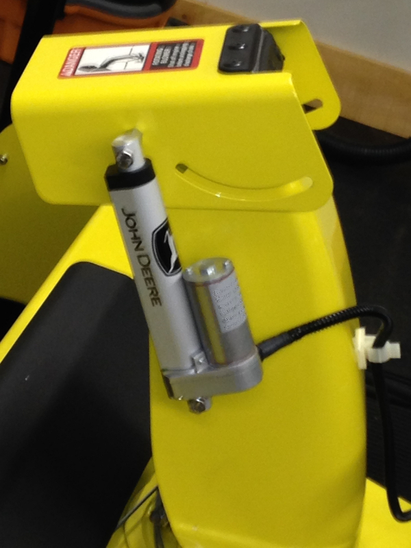

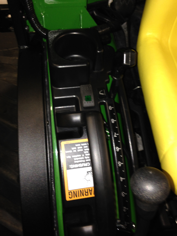

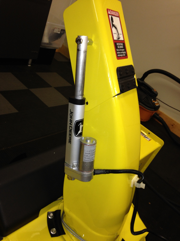

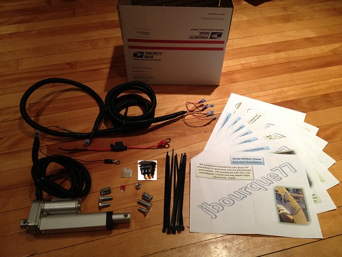

I just wanted to say this is such a great setup! I use to have the cable controlled remote downspout and I recently added this electric remote downspout. I love this thing.....I bought the whole kit from a guy that designed it and puts them together for your specific tractor, very cool option! He includes detailed installation directions with it, very simple to install... took me less than an hour. I added some pics, I will try and post a video of it here so you can see it work. It works flawlessly. The guy I bought it from sells the whole kit with everything I needed to install this on my 2520 for less than $200... If anyone wants to see if he can build a kit for your machine you can email him at james_bourque777@yahoo.com he's a really good guy.
LET IT SNOW!!!!

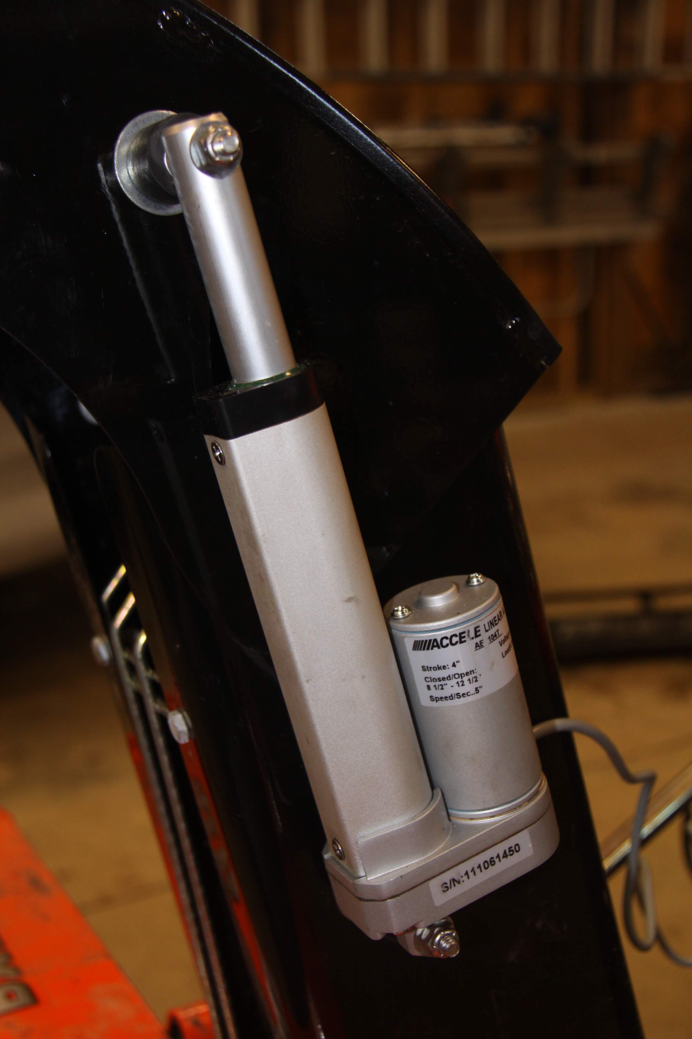

I'm sure there are other brands and suppliers that would work fine. Just look for ones rated at least IP65 - (Totally protected against dust ingress and Protected against low pressure water jets from any direction. Limited ingress permitted).
FWIW: If you mount the actuator the other direction you would be less likely to have problems with water. Of course, it's only possible if the actuator motor and body doesn't get in the way.
