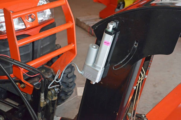

I used the same actuator as you did but a slightly different different setup on my B3030:
It does have a tendancy to flop a little in action. You can see what I am talking about in this movie I made and posted on YouTube. I will evaluate how it holds up at the end of the season:
Kubota B3030 HSDC snowblowing Jan 2012 (HD) - YouTube
   / BX2750D Snowblower chute actuator project #19
The flopping can be stopped by putting a bolt and some nylon washers there at your spout pivot (picture below). I put a nylon washer on the outside and in between the chute and the spout. Use a crimped nut (or one with a nylong insert) so you don't have to tighten it very tight and the flopping stops.
My spout moves freely with no stress on the hinge and no wobble.

I noticed there is a generous amount of clearance in the hinge assembly. Without the knobs keeping the deflector in place mine has a decent amount of movement even without the actuator. If it really starts to bother me I could put a larger diameter hinge pin in there, or replace the hinge entirely - I'm thinking I can live with it!
