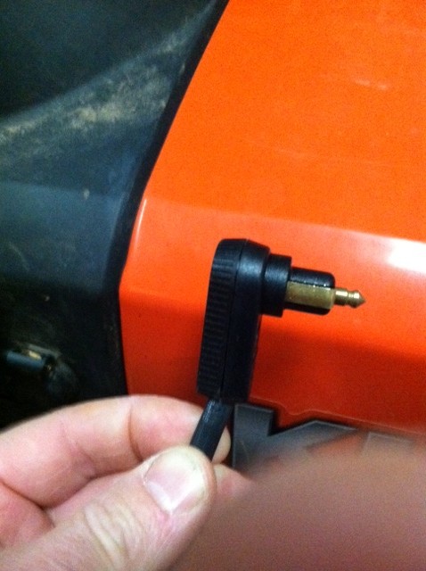

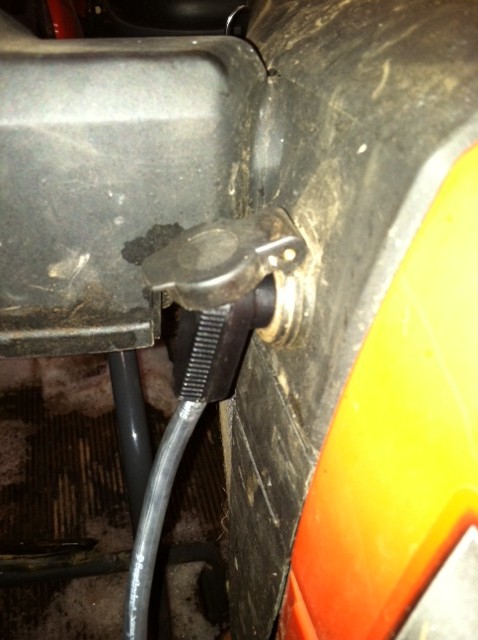

Which connector plugs into this socket? This is a really nice clean install.
I like their 90* plug, since it lets the cord hang down without any pressure on the wire. These are definitely not cheap, but for a mountable outlet solution they stay clean and look like they belong. These are standard issue on most touring motorcycles. BMW and other manufactures put them in handy places for heated accessories (gloves, vests, etc) and trickle chargers.
You can find most of their line on ebay with free shipping.
Right Angle Plug - Powerlet Products
