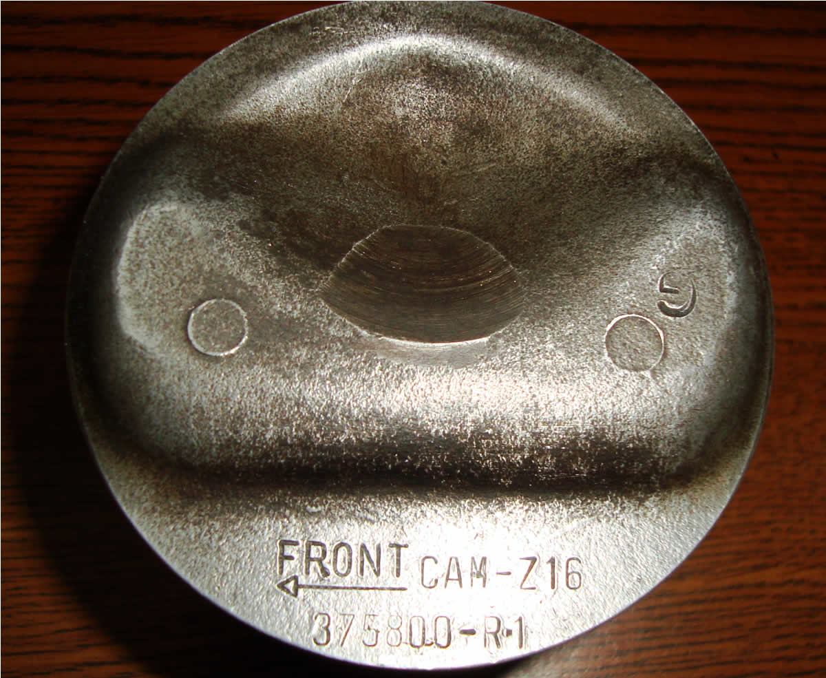

There are two camshafts for the C-135 engine.
Engine serial number 100,500 & below went into model 330 & 340 tractors and had a cam lobe lift of .240 inches.(same specs as a C-123 cam)
Engine serial number 100,500 & above went into model 404 tractors and had a cam lobe lift of .274 inches. Duration specs are the same as the C-123 engines..
Serial 100,500 and above also had high dome firecrater OEM pistons and a 14 bolt bolt head. (see piston image below).
