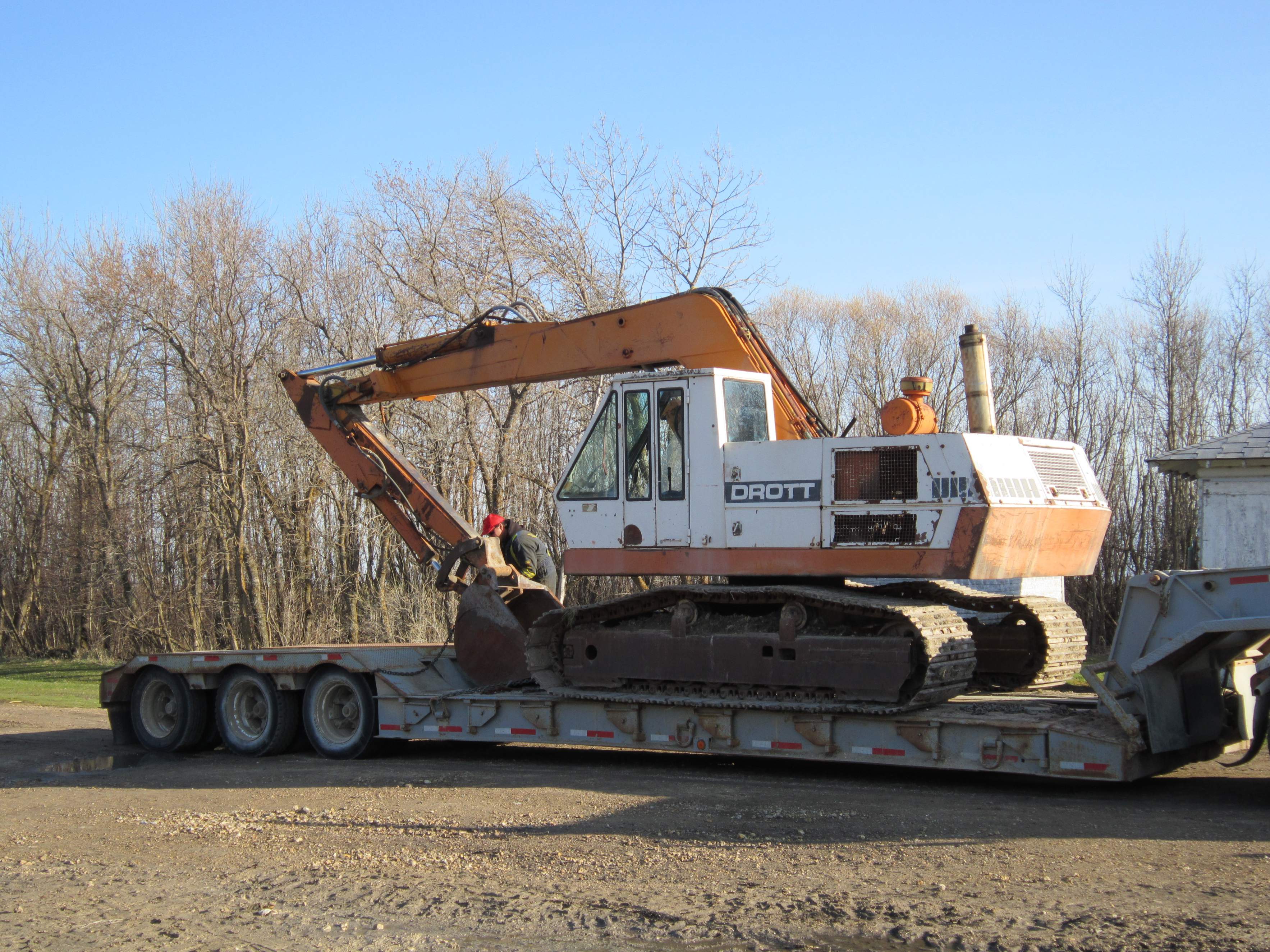

me too been driving JCB, Case,Cat since the mid 1980's and never heard of a 3 stick .
Took me quite a while to get used to slewing and curling bucket with feet in my drott after drining newer machines for so long lol

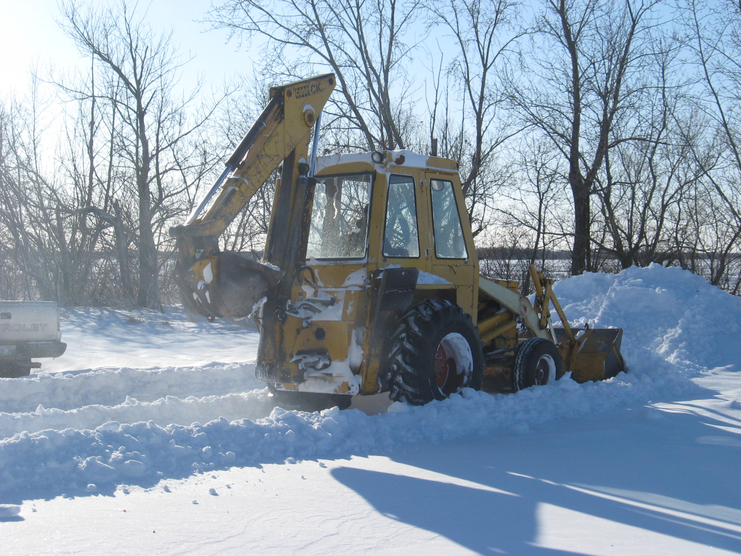

All case's I ever ran were 2 stick including the 580b that I own now and an old 580G I used to have . extenders were always foot pedals .
I never ran a hoe older than a k without the 3 or 4 stick so I learned something then! I didn't think they switched to the wobble sticks until much more recently?

I have a 1975 case 580b diesel 2 stick for sale at the moment .
