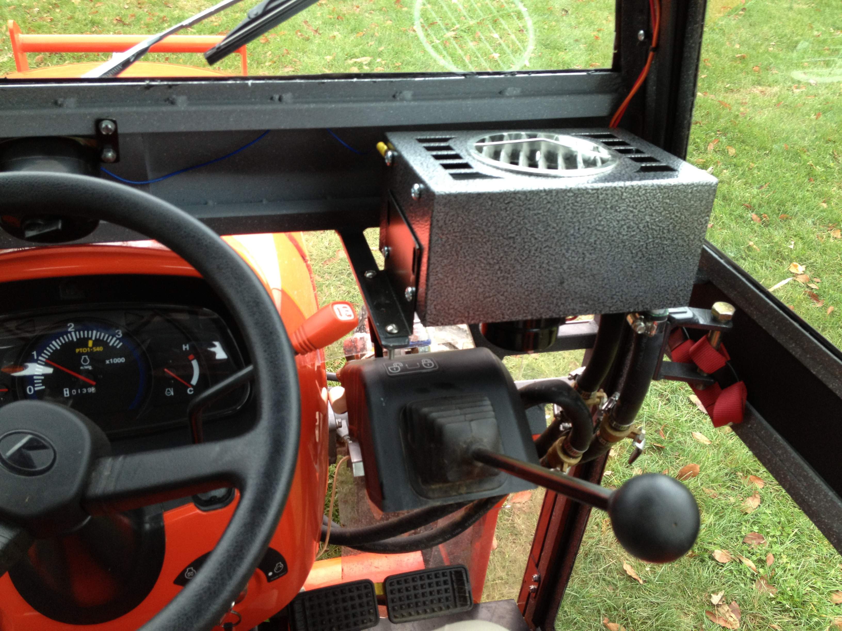

Is there some way you could rig the heater hoses up with quick connect fittings so that you could just plug the two hoses together to complete the loop when you aren't using the cab??
/ Cab for the Kubota #43
RV water heaters often use bypass kits so the trailer can be winterized without filling the water heater with RV antifreeze. Generally two ways they are plumbed, one is using 3 valves and crossover pipe, the second is a check valve in one line, 3 way valve that diverts to cross over. You can look it up easy enough (for example here is a kit (not recommending it, just showing an example Quick Turn By-Pass Kit - Camco 35983 - Winterizing - Camping World). That should allow you to bypass the heater during the summer and not have water flowing heating cab when it is already too hot out... you could even put some quick connects in for removing the cab..

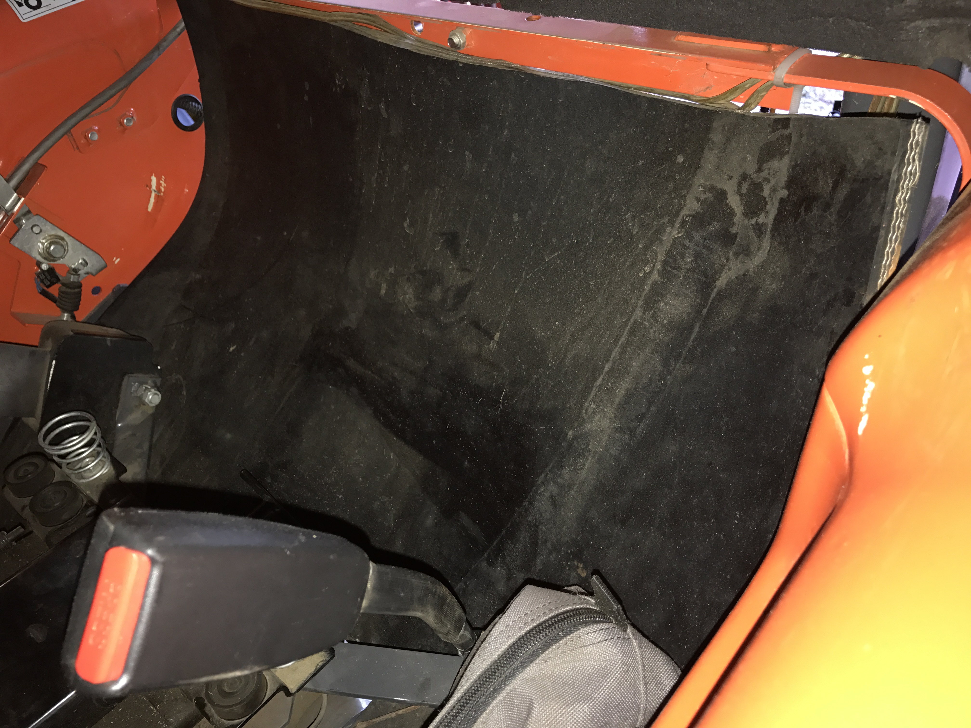

Got the radio mounted, supports done. Trying to figure out if I want to do a double ceiling or not. 1" gap would allow me passage for all my wires and wouldn't restrict headroom by much at all. Also may provide insulation with an air gap between the two panels. And since I bought that second sheet of diamond plate, I'll have the spare materials.
Today I finished up the wire framing for the interior and mounted the radio up. Got bluetooth pairing and bluetooth playback on the phone. Going to install a cigarette lighter to charge the phone, but need a nice phone mount. Also doing double cup holders, one on the door and one on the dash.
Up top the panels will have switches for heater high/low, flashers, flood lights. I'm not sure what else to do yet though. Dome light maybe. I'd like the cigarette lighter up top but it doesn't do me good for my phone if it's mounted on the dash, no good having wires dangling in front of me. But I also want everything on the cab completely removeable with the cab, so I don't want anything added to the dash, or anything that will interfere with knee's or getting in/out.
Tomorrow is what I've been putting off, cutting panels. Basically that's it, then I can paint, then wire the electrical up. My starter relays are in NY as of yesterday, so that will be perfect timing.

I built my cab a few years back and added a Meradyne heater utilizing shark fittings, valves and quick connects, no issues
