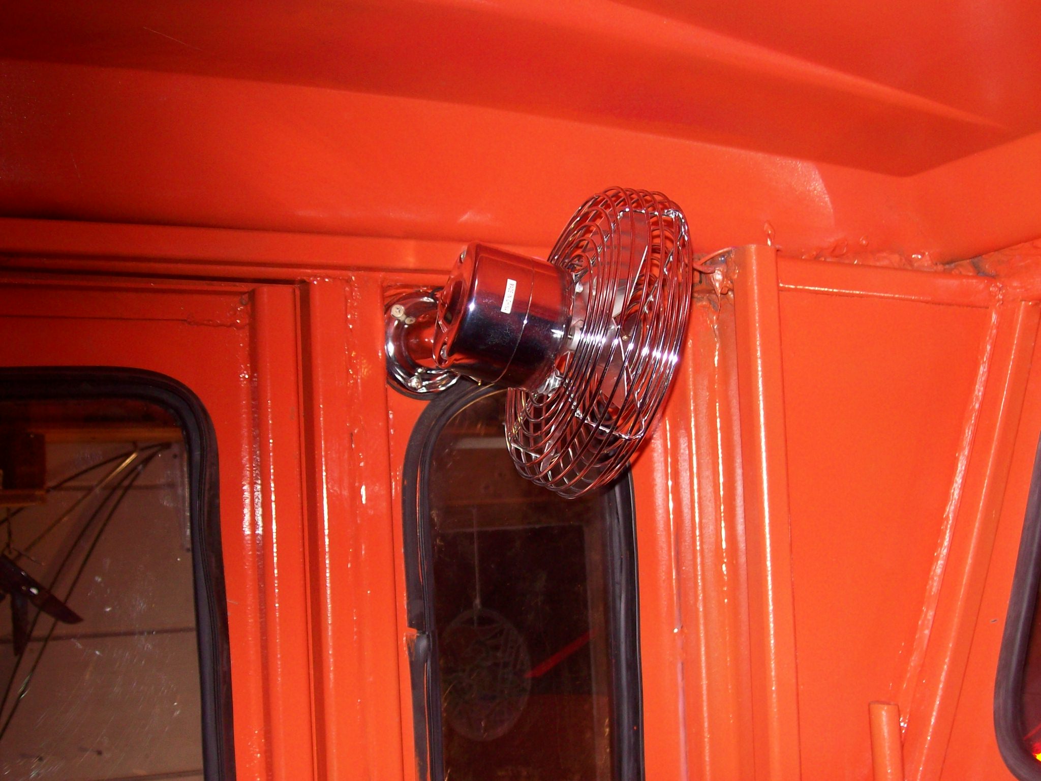

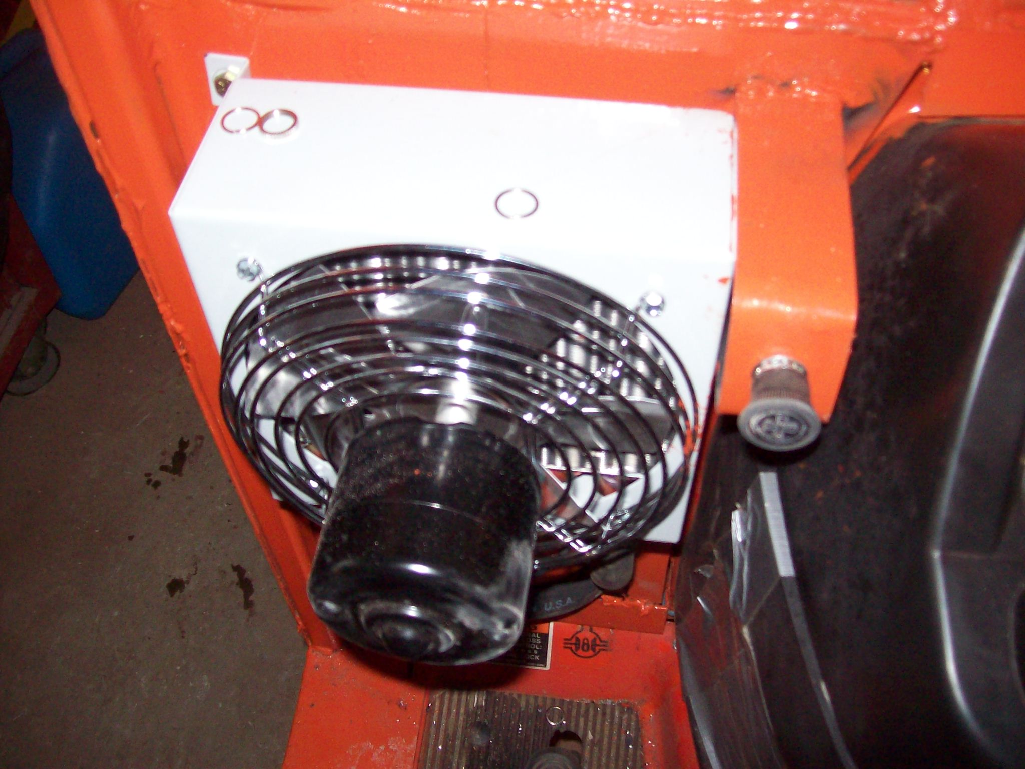

This heater i put in was from a stepvan catalog on sale just over 100bucks easy to install into the tractor cooling system,A fan in the cab helps move air around winter or summer
