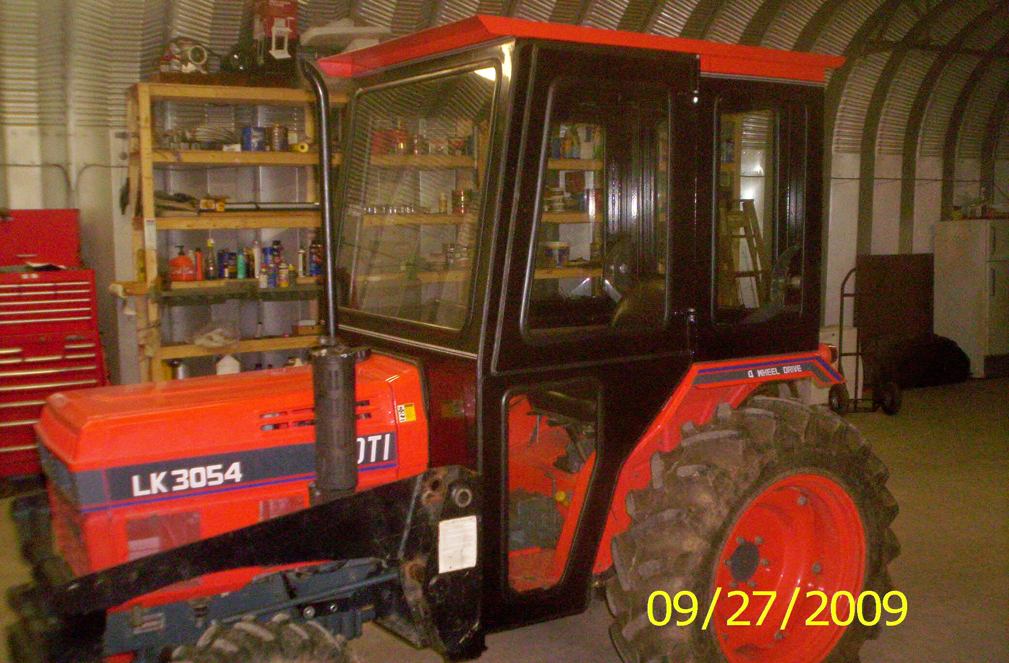

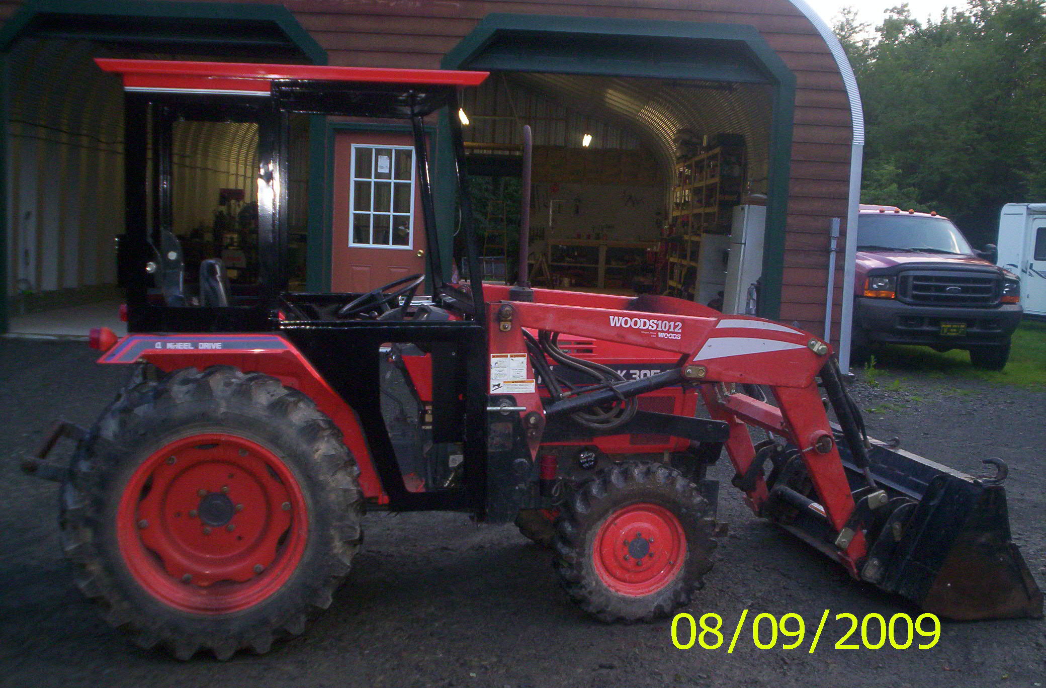

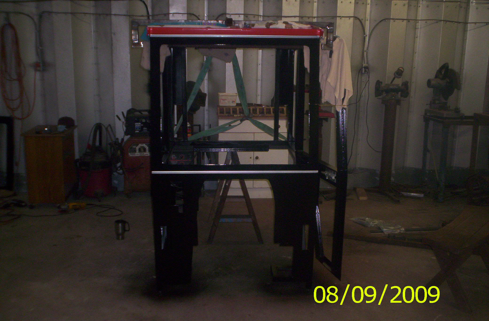

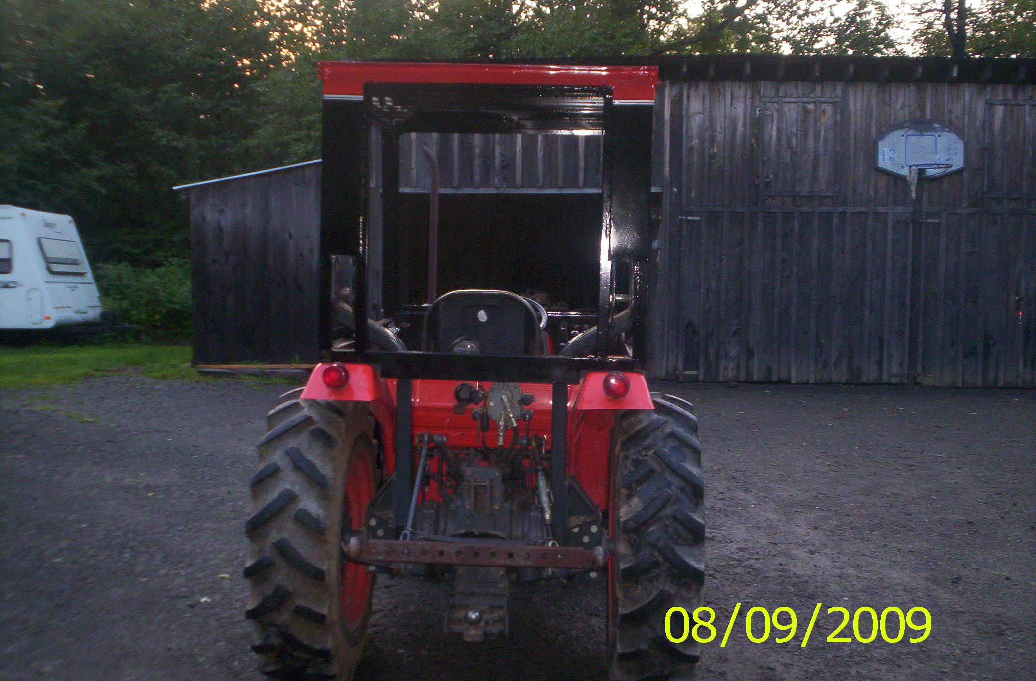

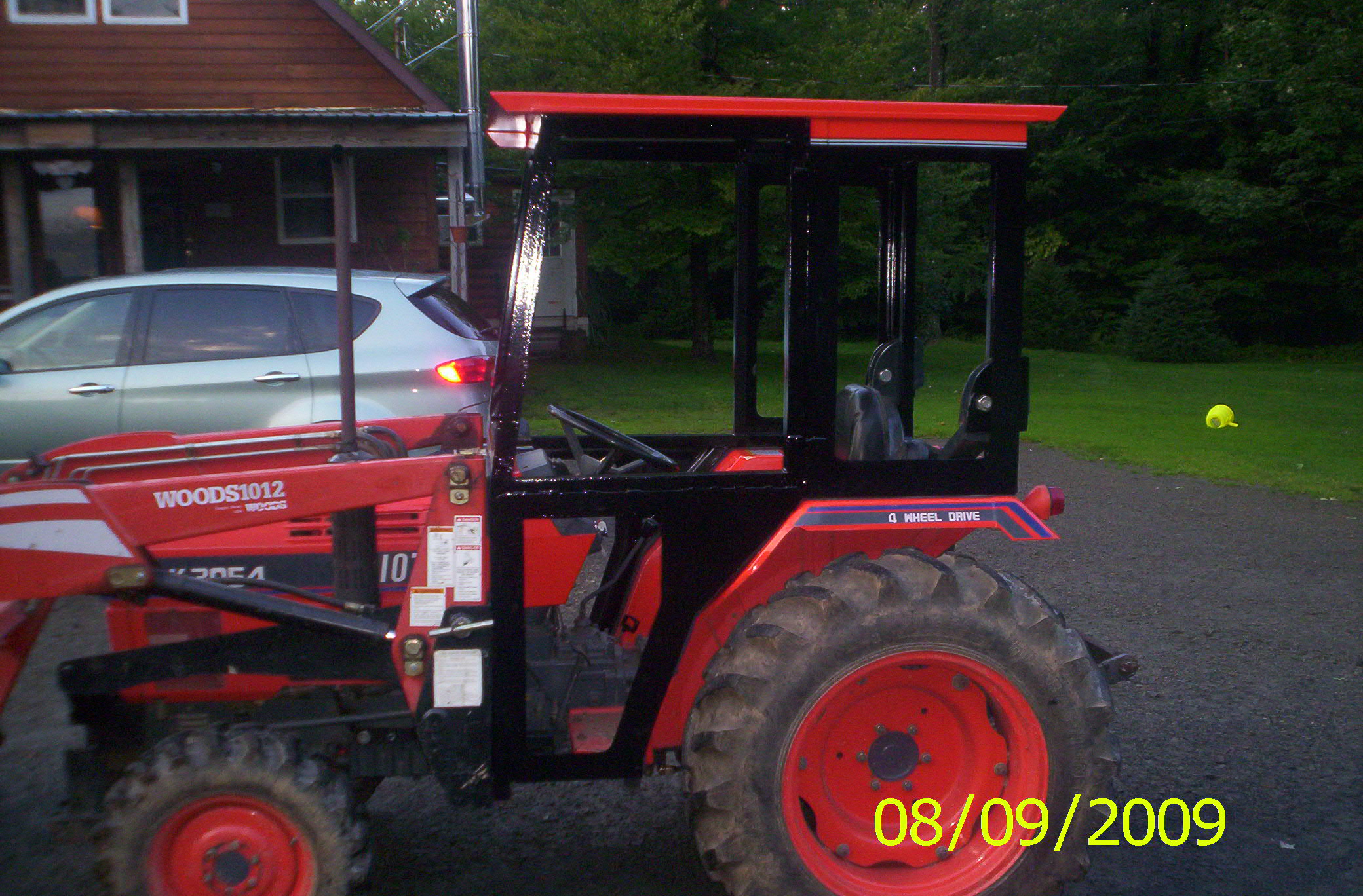

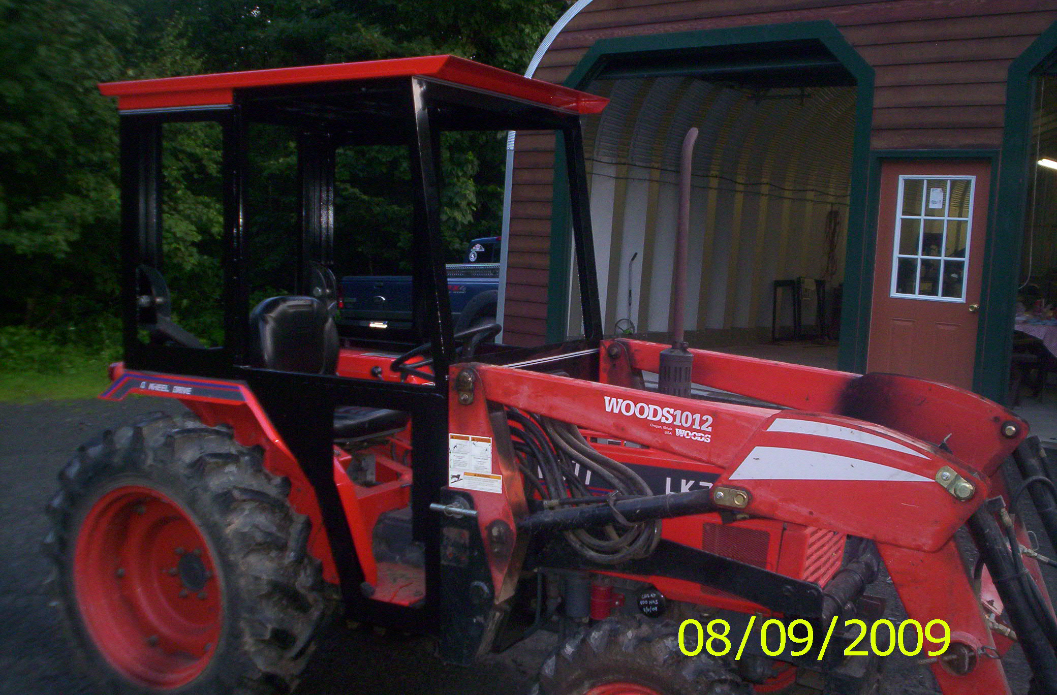

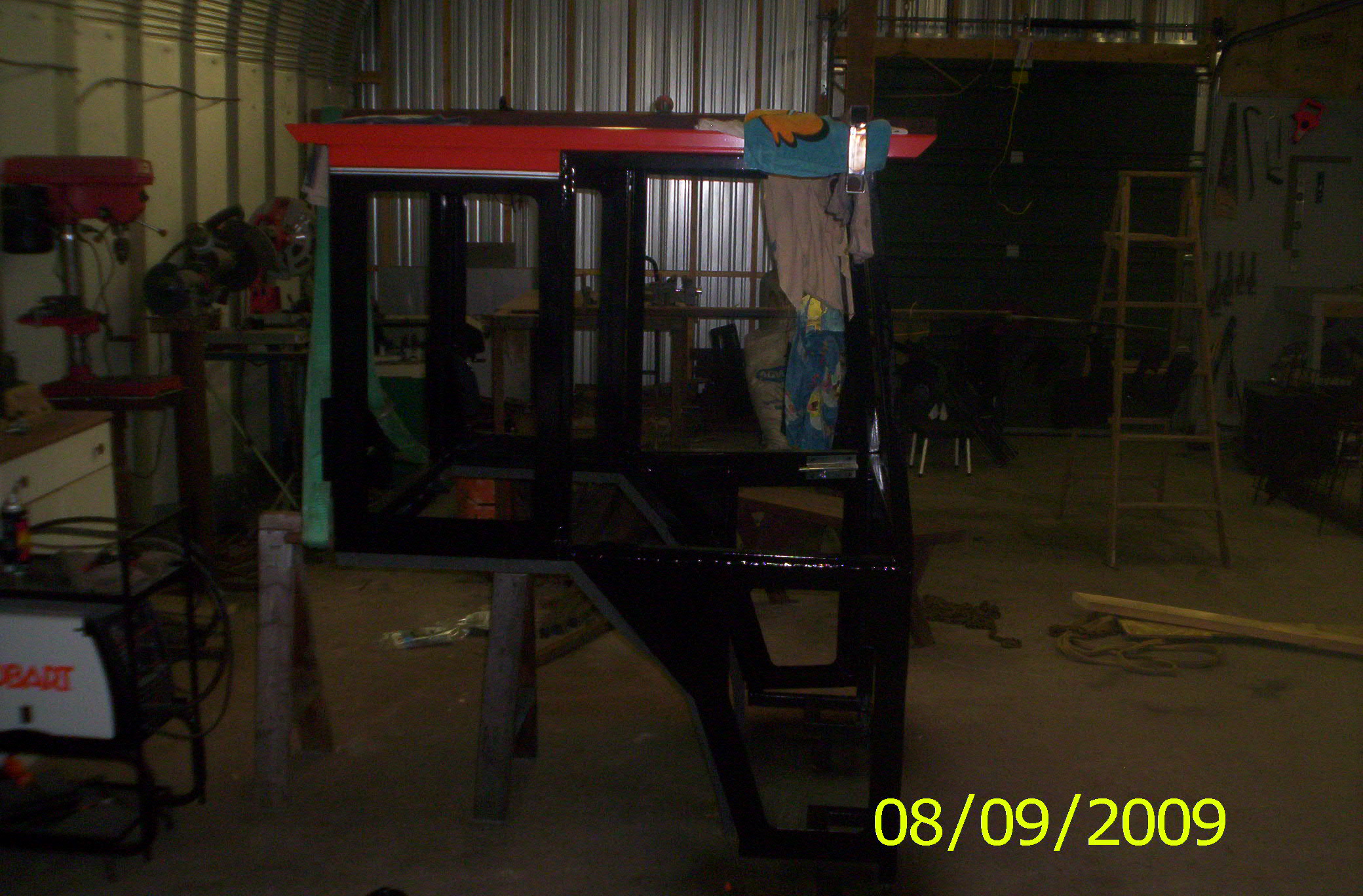

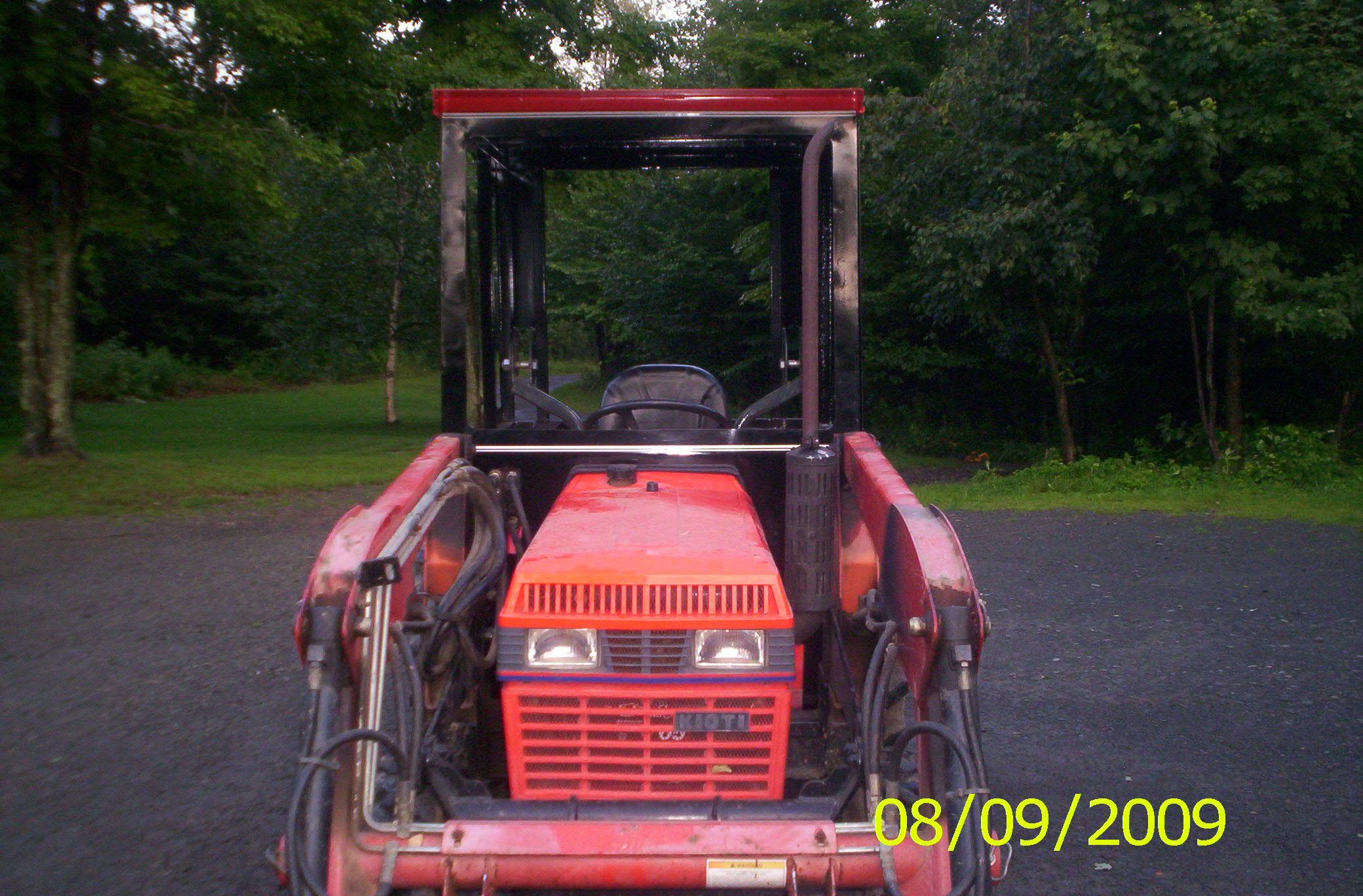

well here it is.
still needs glass,lights,wipers,headliner,heater
   / cab project #84
well here it is.
You did a great job!
Now once you get the rest done... Are you going to install AC for next summer. :D
Thanks for the update!... and it looks great!
Keep posting pics when you can.

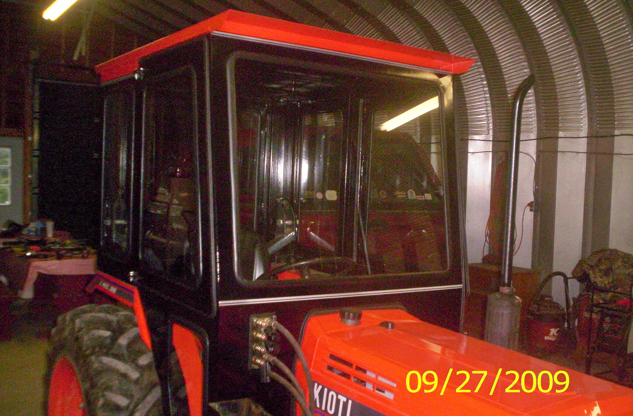

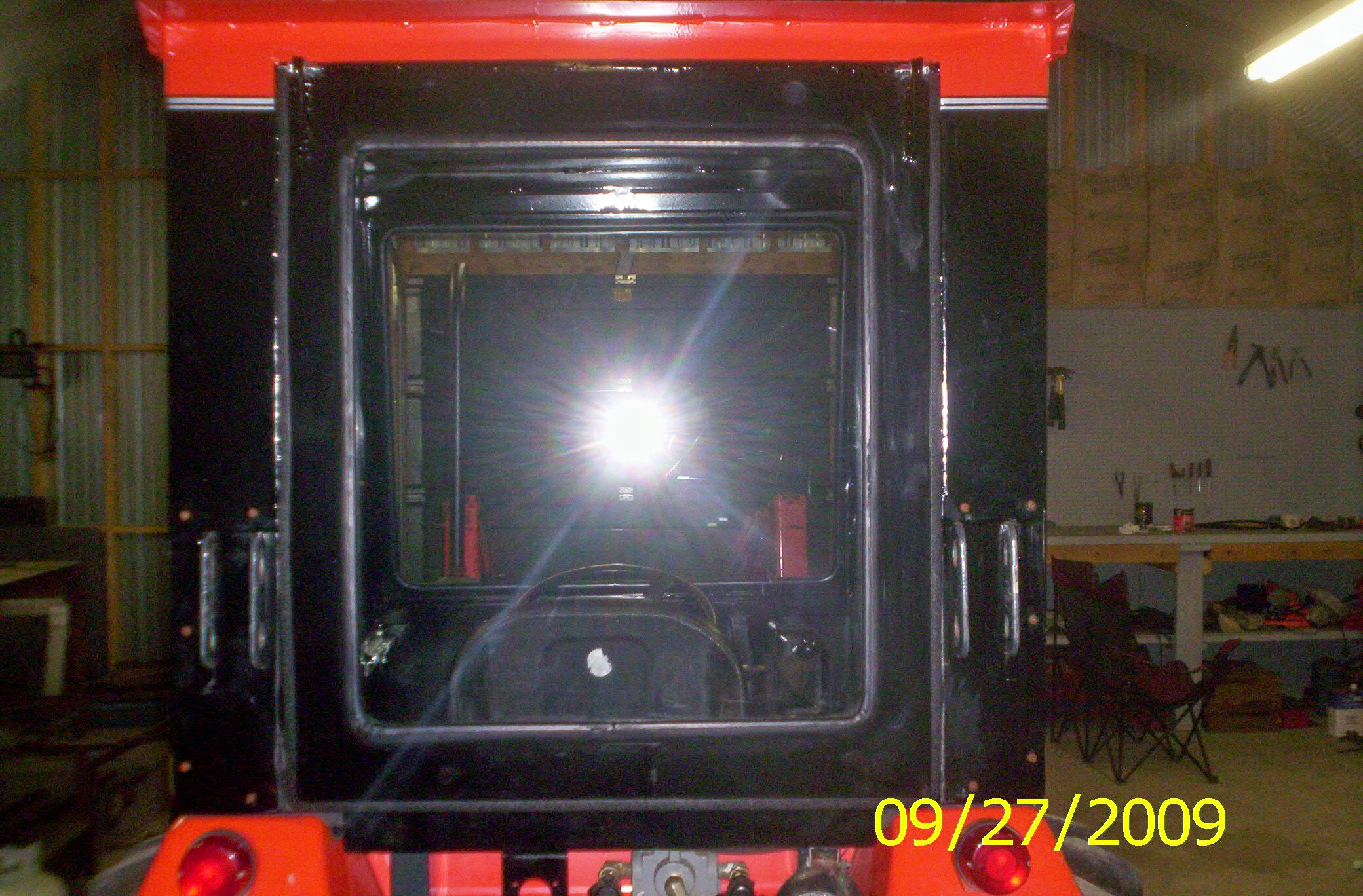

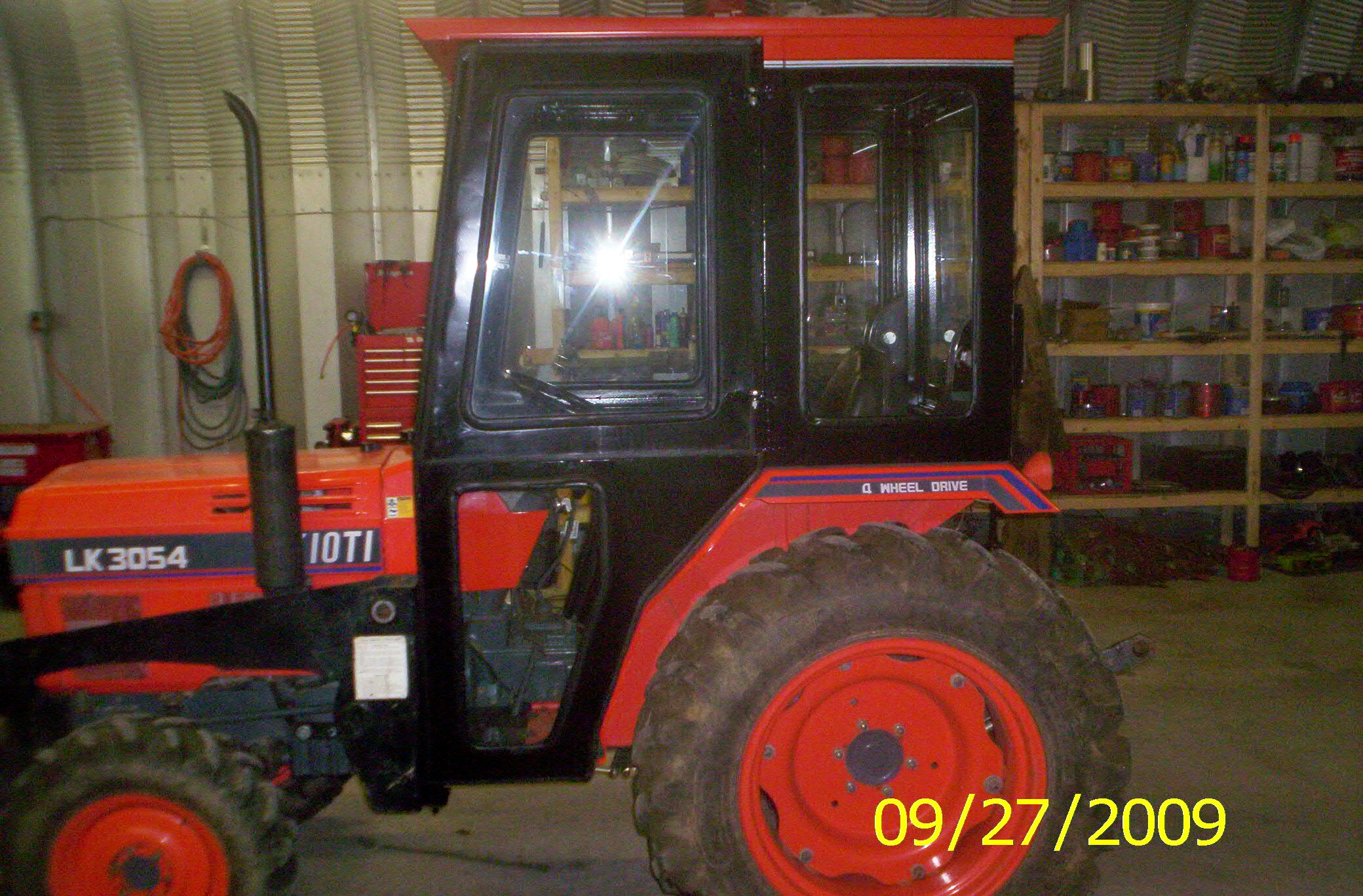

glass is in. a little advice when you make rounded corners cut no less than 3" radius corners. i had 2.5" corners it made it difficult to work the rubbers.
   / cab project #89
That looks great! Just in time for winter. I can't get your pictures to blow up very well but I like what I can see. Richard
   / cab project #90
I like how you did the bulkhead fittings for your hydraulics. How much more to do before it's complete?
