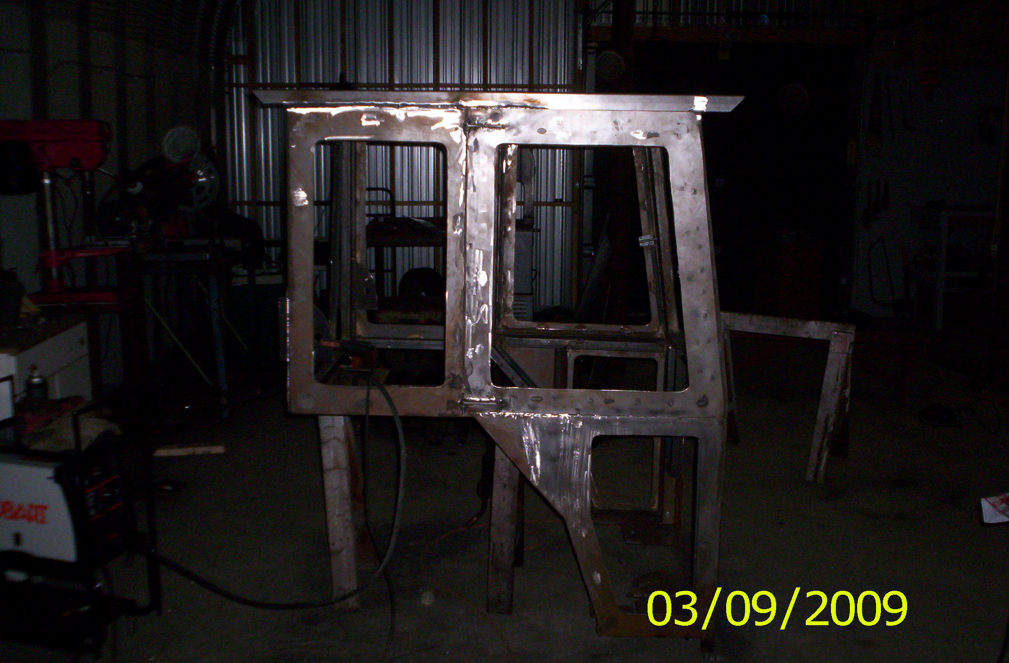

update on cab. i got my steel for the roof today had the sides bent & put it on.turned out pretty nice,will weld the drip edge on when i get the 1/2x1/2 angle.now i need some warm dry weather to do some finish work and paint. it is really starting to rust.

I have been told that warm dry weather is on it's way, although we had another 6-8 inches of snow yesterday and looking at another front moving in tonight.
Just wondering if you are keeping track of the hours and money invested in the project?
Wayne
   / cab project
#76
no track of time,about $250.00 for steel i had to buy.i had all the square tubing already.hope to keep it around a $1000.00 when done.
Looks great Dirtnut,
I hadn't seen you post in a while.
Yea can't wait till spring hits and turn the ground to get the garden going.
Thanks for the update!
   / cab project
#78
i was waiting for my steel,plus got called back to work beginning of feb.picked up my drip edge last night will weld that on over the weekend.
