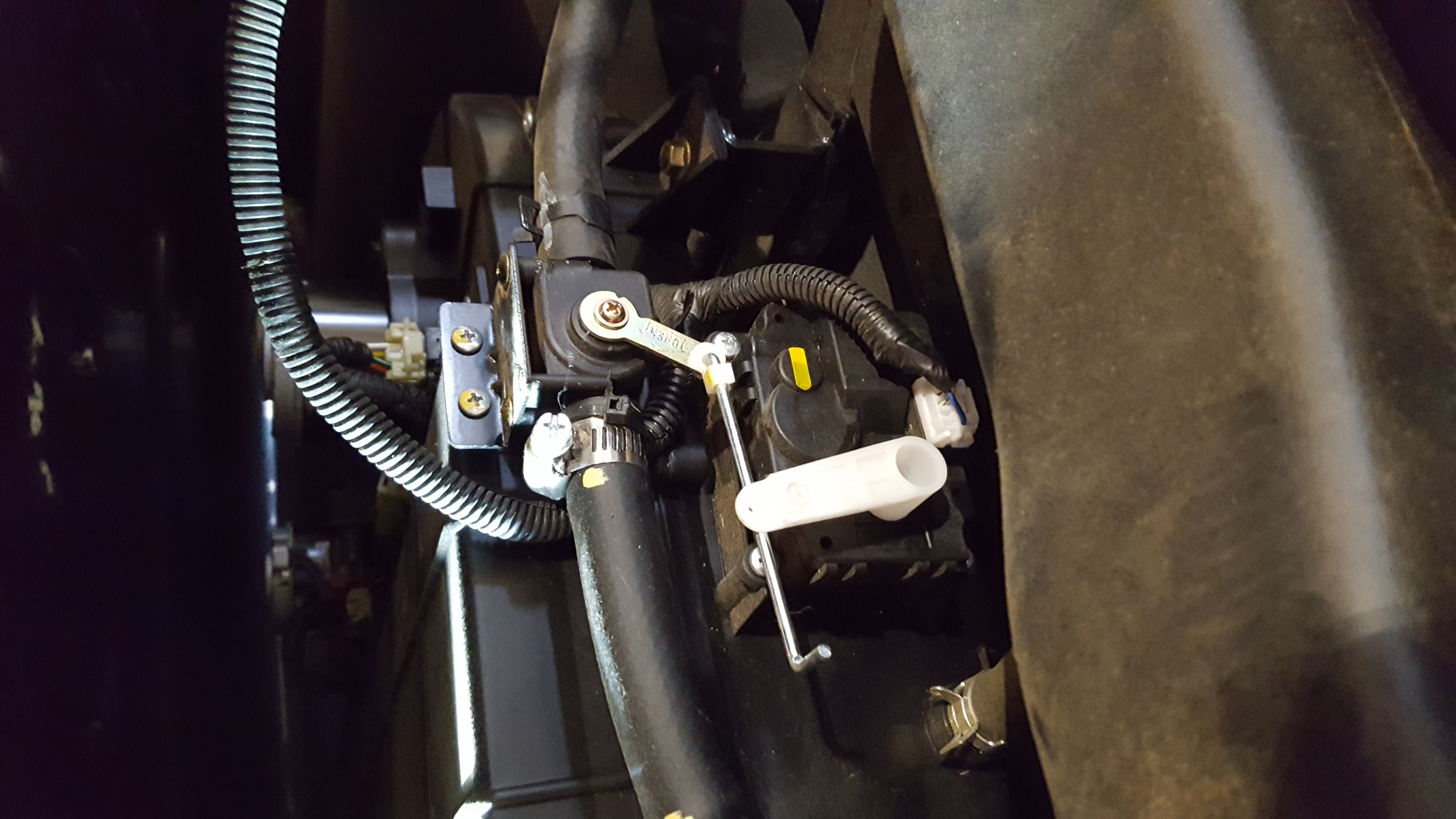

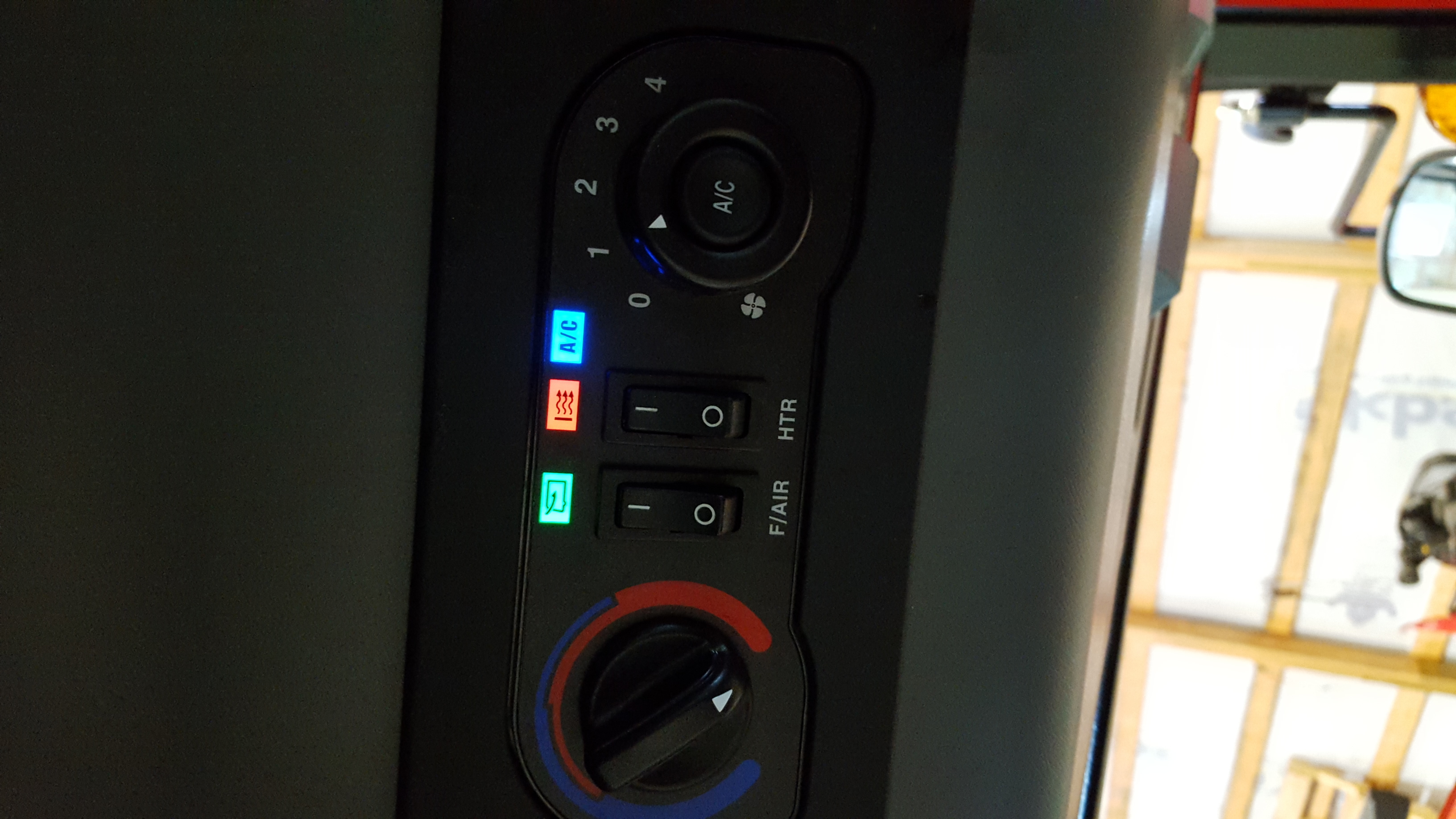

I have a Branson 4520C and the heat doesn't work. I had a previous thread and I did the suggested troubleshooting by checking the cab air filters and ensuring the coolant is at the proper level. When none of that worked, I unscrewed the HVAC control panel and had a look. The unit has power (all the lights work), it will kick on the AC compressor, the fan works, and the fresh air door opens and closes. When I turn on or off the Heater switch, I see nothing moving or hear any sounds, also when I adjust the heat blend control, I don't see movement or hear noise. I think this is what should be moving 20181204_141441.jpg. It looks like the top is the valve that opens the coolant flow and the bottom is for the air door.
Do you think I have a bad control unit? If so can I override the malfunctioning part and manually open the heat valve and move the air blend door without breaking something? This is the second time I have had a issue with the HVAC controls as my AC stopped working a few summers ago (it was replaced on warranty.) If the controls are the issue, has any one opted to replace it with an automotive one (Ford/GM/Mopar)?

Can you check voltage from the heater switch when you turn it on?
When you rotate the temperature knob can you monitor the voltage from it?
Can you feel the heat control valve try to actuate?
Or monitor the voltage signal to it.
Looking at your pictures I would agree that you are on the right track.

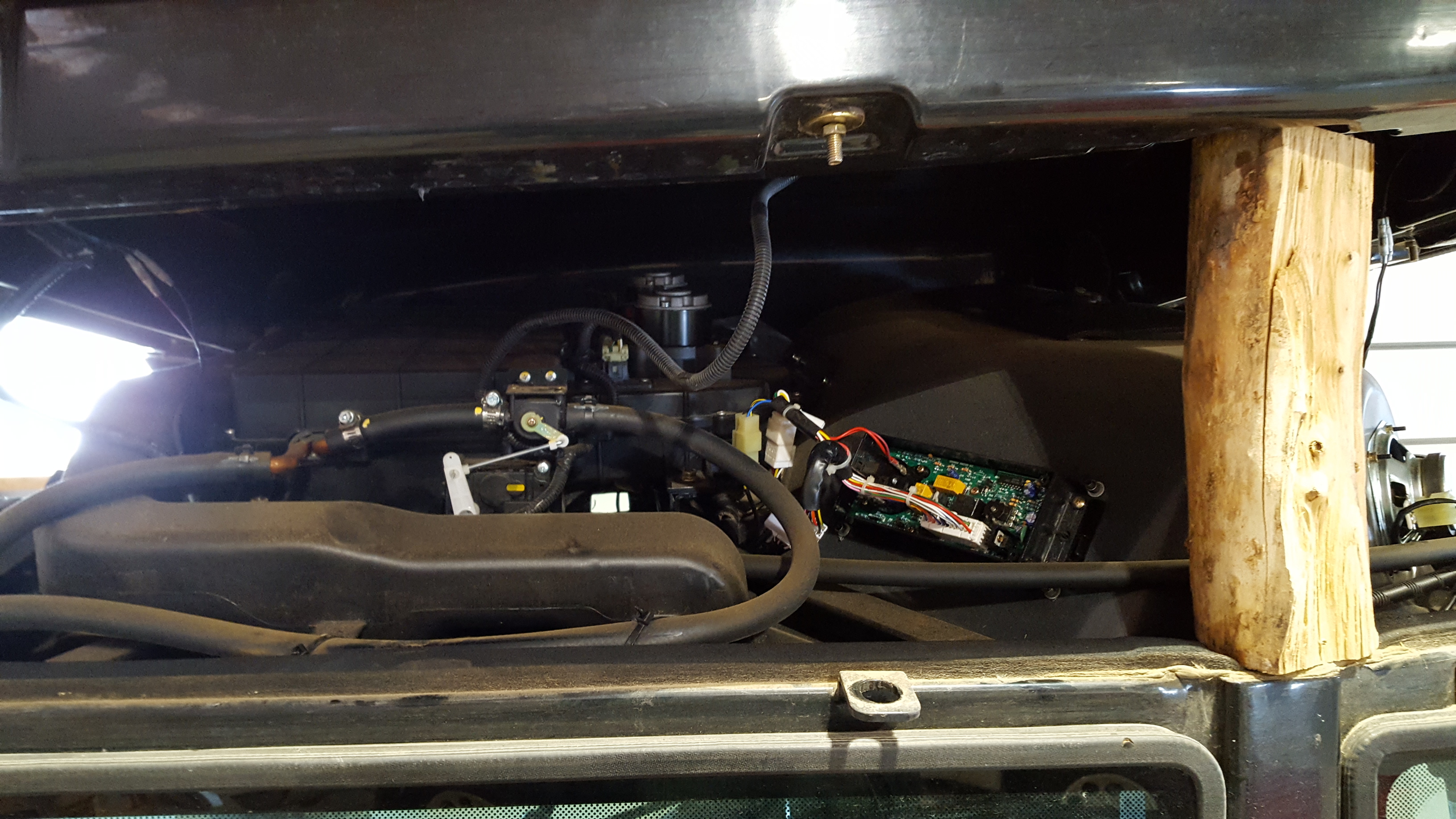

Removing the cab roof is rather easy if you don't take it off all the way. There are six studs that hold the roof onto the frame. You don't need to take to top nut and rubber washer off. There is a nut and a large washer underneath these. This will allow you to keep the red and black roof components together and then you can just tip the roof to one side to gain access.
Next I just unattached the linkage to the coolant cutoff valve and opened it manually.
Does anyone know how the temperature control works? In the service manual it talks about a blend door in the troubleshooting section, but in the pictures and exploded drawings there is no indication that there is a mechanical blend door. Could it use the actuator to throttle the engine coolant valve to adjust the temperature (which wouldn't explain the on/off heater toggle switch)?

Interesting pictures, you definitely found the water valve.
Is there a blend door on the far side of the box with the heater core in it?
I looked thru the 7845 manual and the 8050 parts pdf and the manual mentions the same blend door,
but I don't see it in the parts breakdown.

Have you tried to turn the Heater on now that you have that apart to see if it moves at all? I'm assuming you need to get to operating temp.
/ Cabbed HVAC Controls
#12
Yes, got the tractor up to temperature and it blows heat with the valve manually opened. I still didn't hear/see any movement when adjusting the blend control or heater switch. I tried to move the coolant valve actuator by hand and it didn't want to move. I'm not sure if it is frozen up and that is my problem or if it's the gearing that won't let me move it without applying lots of pressure. I'm starting to suspect that the actuator is the problem and not the control panel. Any ideas on how to test the actuator?
/ Cabbed HVAC Controls #13
Can you disconnect the electrical plug and trace it back to the controller?
Then see if it is coming from the temperature rheostat or the switch or possibly both?
Then check voltages with the various controls?

I noticed in one of the pics the controller was a Doowan;
Doowan Parts Buy Auto Parts
Possibly these people could help with controller details
