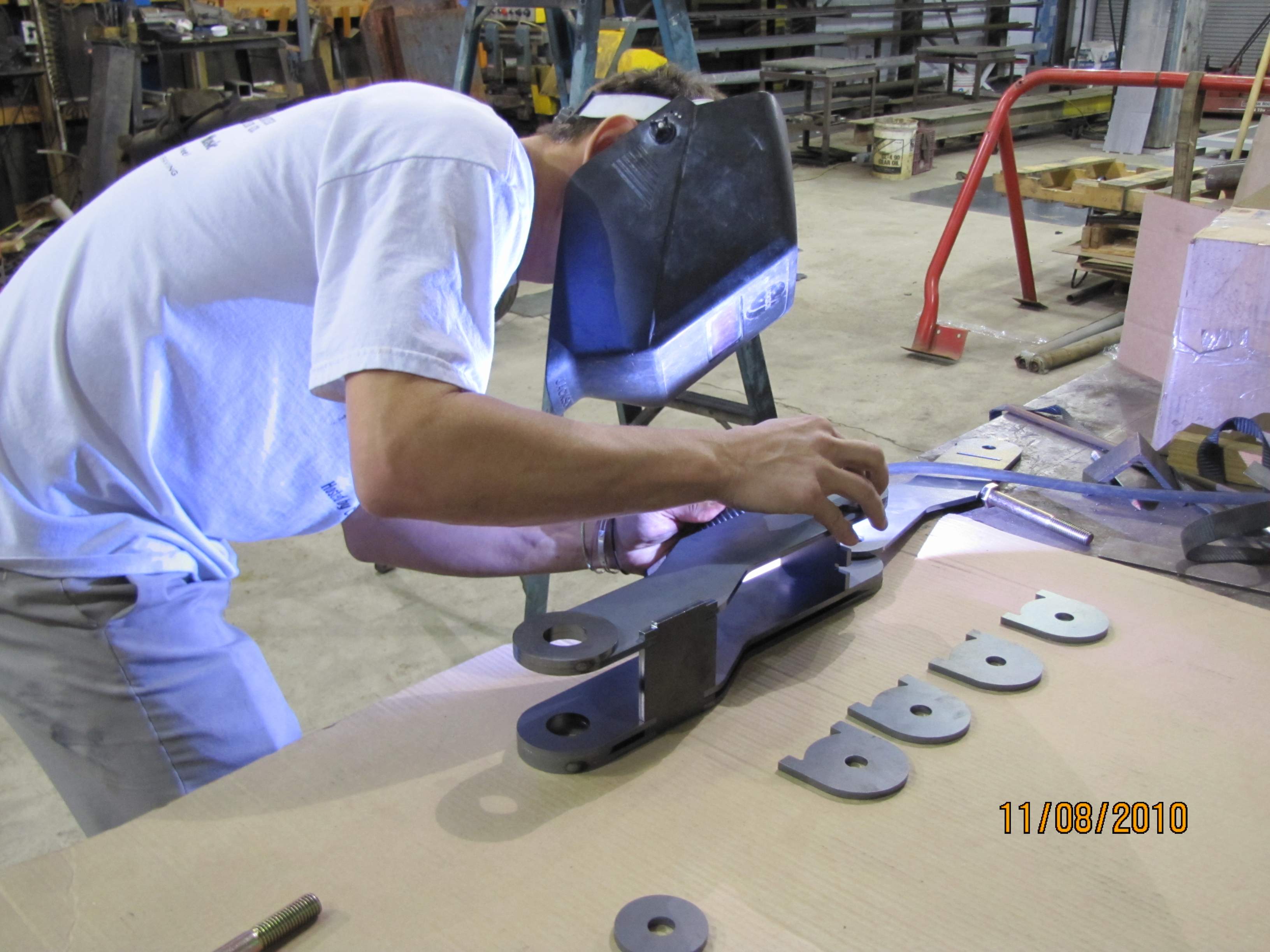

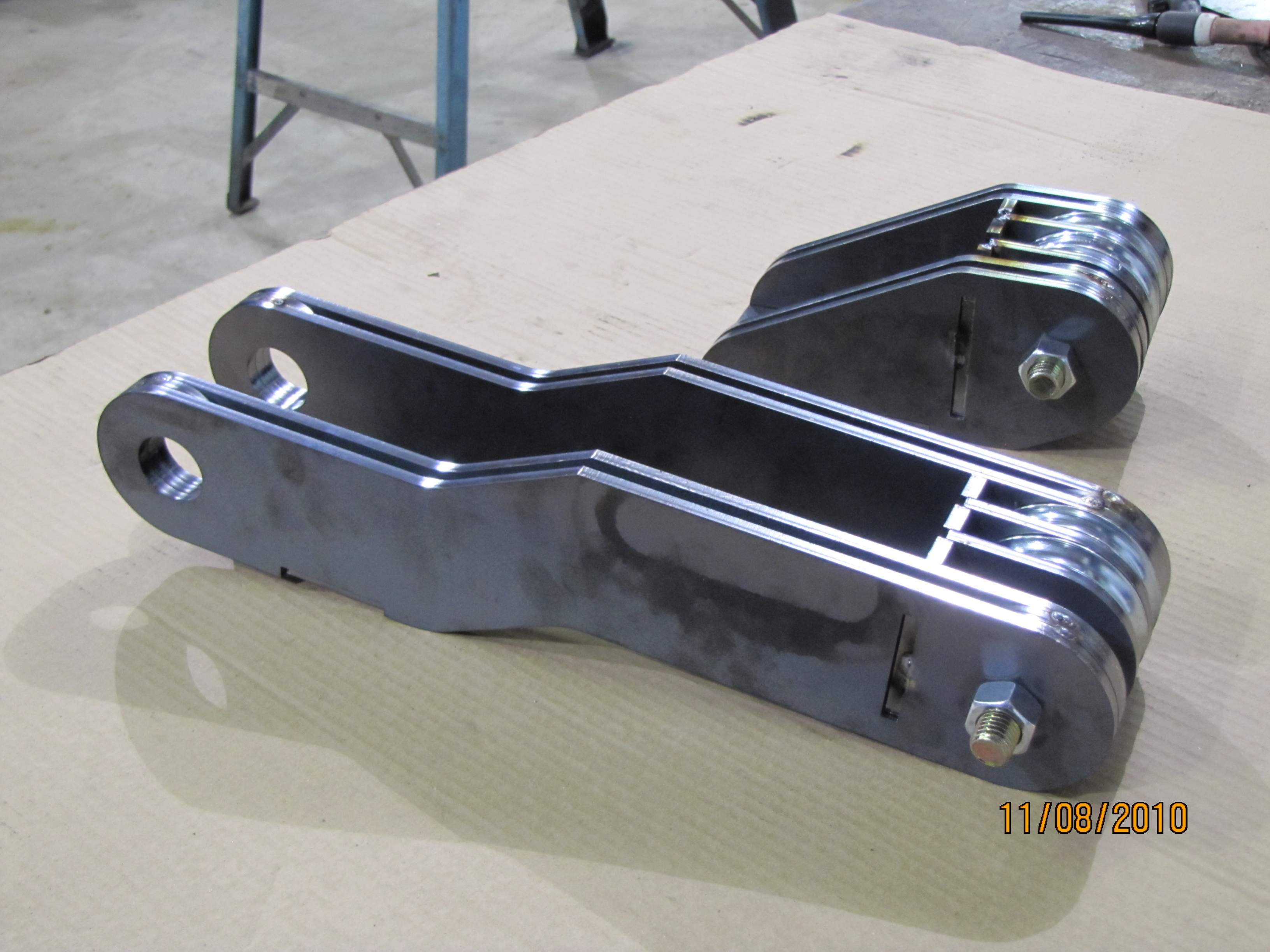

As promised, Here are a few shots of the plasma cut an assembly of the block& tackle.
Army grunt

It looks much nicer made into steel plates :thumbsup: then it was in the drawings. I'm beyond jealous and envious and all :drool:. When do you plan on mounting it on the trailer? Are going to bolt it or weld it?

Those are incredibly clean and accurate cuts for a plasma cutter . They almost look like they were cut on a flowjet . What type of plasma cutter and table is he using ? I am curious aboutwhat brand and model plasma he used.
