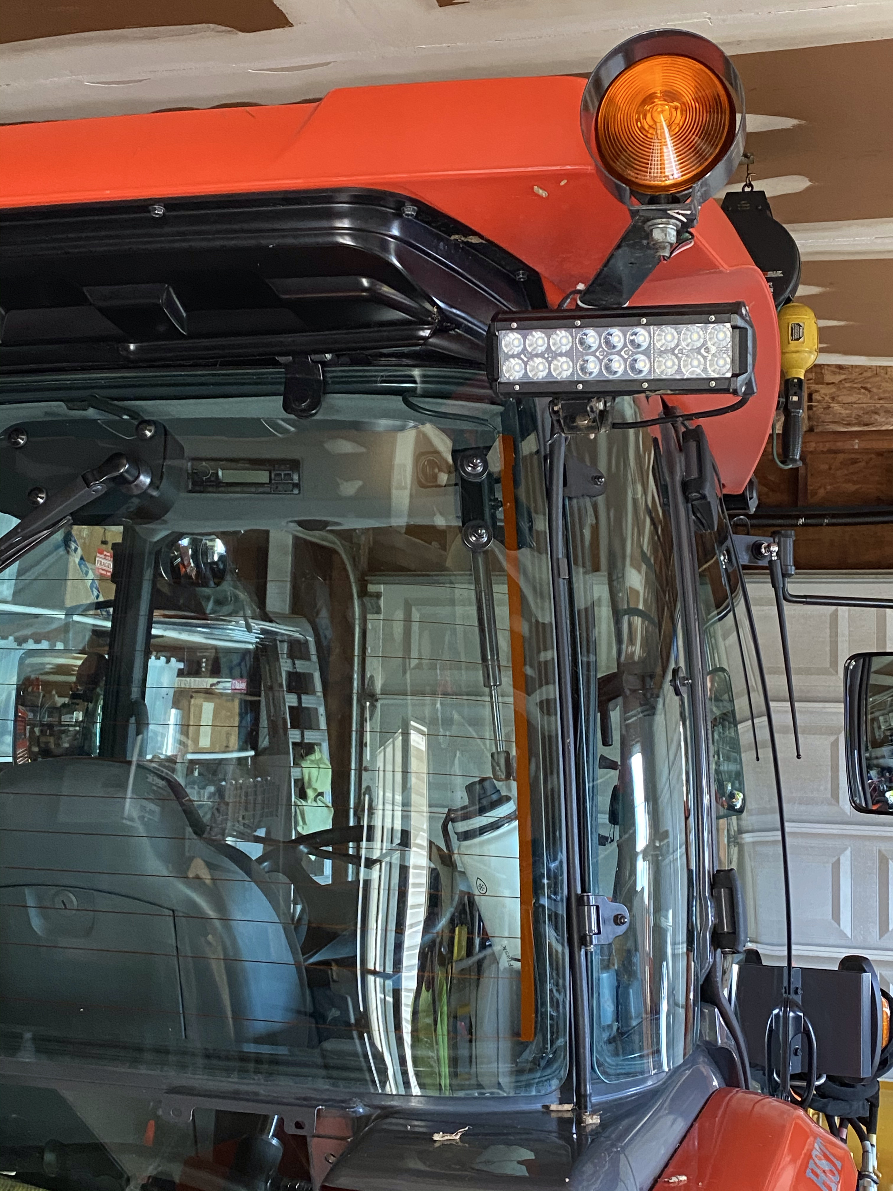

I should have them soon. The led front and rear work lights was the single most useable modification I've made to my L4060. They are 54 watts each, and turn night into day.

They are inexpensive eBay lights with no part number or manufacturer info. I will say they appear well made with no issues over the past several years.
Similar to this one (no experience with this seller) :
Spot Flood 9in 54W LED Work Light Bar Offroad 4WD Truck ATV SUV Jeep Lamp | eBay
My 52" bars were no name stuff off Amazon. Under $75 each. Cheap no-name big & small bars are on Amazon, Ebay & every auto parts or rural supply store. Cheap ones are usually noisy on RF (they jam your radio reception). They are a cheap commodity item at this point, unless you get some really expensive ones like Ridgid.
My front bar has a leak & foged up. I just undid a bunch of the screws at the bottom so it leaks out as well as in now. Will replace it with a better one that doesn't kill my radio if/when moisture kills it.
   / L6060 Cab Questions #51
Yeah, mine certainly kill the FM radio, but I generally stream Abba and the Beach Boys through Bluetooth.
