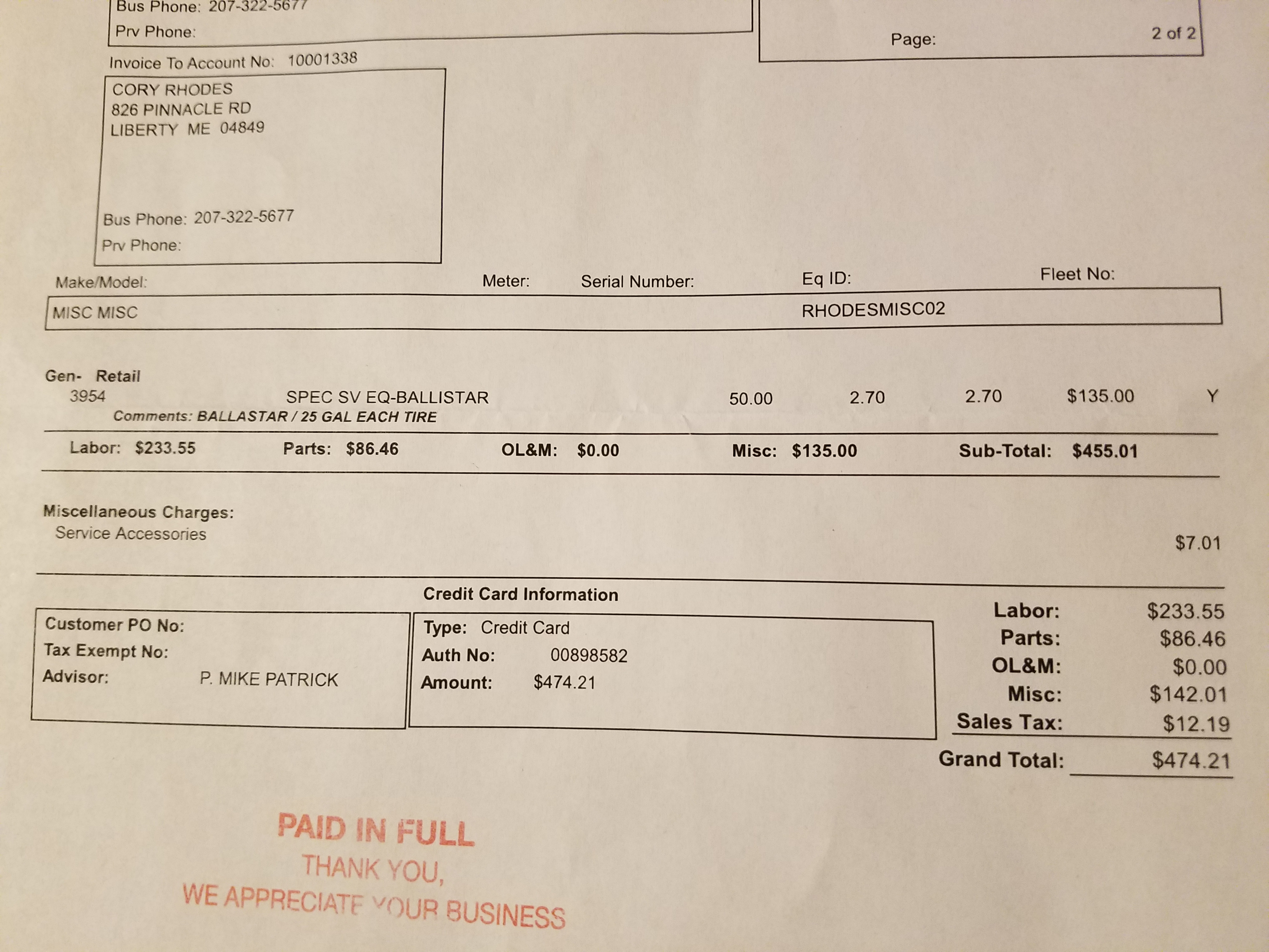

20170324_180918.jpg <<<<<<<<<<<<Tires are back on, what was done was get rid of the calcium, >> put in new tubes, must be the Parts at $86.46 for two,> fill with Ballast Star, slip says 25 gal. in ea. tire, sounds like a lot to me for AG 11.2-24. >> then 15-20 psi.
This seemed like a reasonable price to me if it's done right and or once on two tires, hate to pay it again on these same tires, adds up quick. I could save the labor charge of $233.55 if I do it myself, but how many here would of done that work for that price. But maybe I should look at what's needed for tire changing equipment anyways just so I can have some fun changing tires to, or everyones busy and tractor is needed ASAP. I know 1> an affordable ballast transfer pump is needed along with the valve core connecter, 2>> Valve core cable holder, 3>> couple tire irons, but what length/kind? 4>> then what about bead breaking? what if the tire is stubborn, use the tractor bucket? 4>>The last thing and the most important is ambition, use to know where to get that.

You know that Ballast Star is good ol' calcium chloride solution with a quart or two of oil "corrosion inhibitor" thrown in that floats on the surface of the fluid and coats the steel rim as it rotates. For a few bucks more per tire I went with a beet juice based product TL 90. A recent rim change on the Farmall C due to CaCl corrosion ran me $795...and I re-used the old tires.
To me it's worth the extra $$. Some folks on here spend $30-50k on a new tractor and complain about a few cents per gallon for ballast. I don't get it.

And that's all it is, just a few $$$ more than calcium, and the quote I got from Union Farm Tractor, Rimguard was a little cheaper than the John Deere place that sells Ballast Star, but the tire guy was sick and would't be back till sometime this week, and the person at the JD place told me Ballast Star was like RG, but I go home and do research on it and find it's just Calcium with anti rust additives in it. We'll see how much anti rust there is when I check the valve cores in a couple years.
