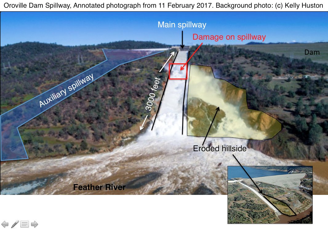

Please, before fearmongering, read this whole thread (I posted several pictures showing the concrete with rebar in it), then look at the linked thread at Metabunk (Oroville Dam Spillway Failure | Metabunk).
The upper part of the spillway is carved into a rock outcropping, the spillway and emergency spillway are built on top of a rock outcropping.
Worst case, they lose the emergency spillway and 30 feet of the lake dumps downstream. While that would be a big problem, the rest of the dam is not going anywhere.
Let me repost a picture showing where things sit:
Picture of the whole area with some good markings of where everything is to give some perspective:
Source: Twitter
Even if both spillways blow out, there is still a large shoulder with rock underneath that it has to get around before it can eat into the dam itself.

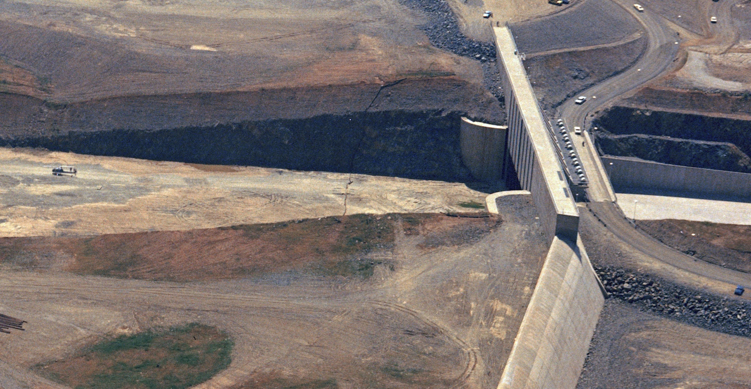

In this picture, you can see the rock lining the side of the main spillway:
Source: Oroville Dam Spillway Failure | Page 7 | Metabunk
The evacuation was in case the emergency spillway blew out as they were getting undercutting that was getting close to the base of the emergency spillway.

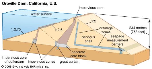

You can stand down there if feel safe but I'll stay up here on the hill high above it all.
I know how earthen works dams are supposed to work and what too much water does to clay. It's clay and not rocks that is supposed to hold the water back. Rocks are permeable unless it's solid rock and it's clay that makes earthwork dams hold water. All that red stuff you're seeing is clay. The rock rubble or rip-rap is just there to protect the earthen structure from physical wave action. In the end, only time will tell.
Here is a cross section of the Oroville Dam which is one of the highest embankment dams in the world. Until 1980 or so it was the highest in the world. The so called impervious core bit that is supposed to hold the water back is simply compacted clay.

The spillway is NEXT to the dam, NOT ON the dam. The area that the spillways are in is a shoulder of rock. That is why they built it there
If you look at the main spillway, it has scoured out the clay and the reclaimed tailings that they used for fill and the area is down to rock (other than the corners of the bottom end of the upper spillway which are still eroding uphill a little), this can be seen by comparing the reddish flume coming off the main spillway for the first day or two to the white flume coming off now.
See Oroville Dam Spillway Failure | Page 3 | Metabunk for comparison pictures.
The emergency spillway is 20 feet lower than the top of the actual dam, it is not likely that there will be enough water to fill the lake to where it over tops the emergency spillway by 20 feet.
