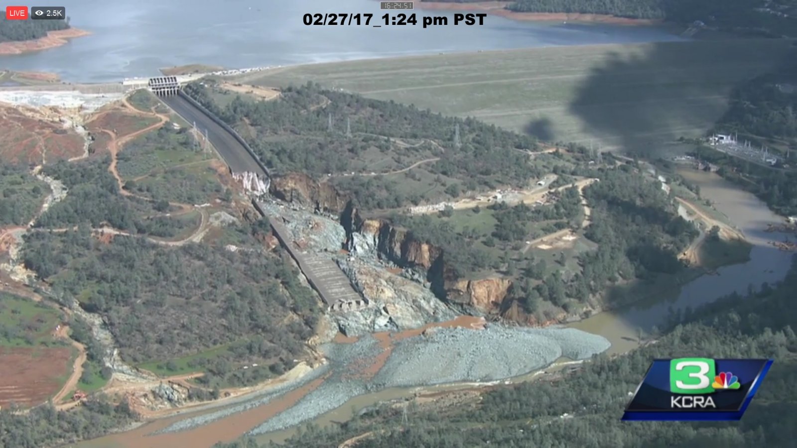

The spillway is NEXT to the dam, NOT ON the dam. The area that the spillways are in is a shoulder of rock. That is why they built it there
If you look at the main spillway, it has scoured out the clay and the reclaimed tailings that they used for fill and the area is down to rock (other than the corners of the bottom end of the upper spillway which are still eroding uphill a little), this can be seen by comparing the reddish flume coming off the main spillway for the first day or two to the white flume coming off now.
See Oroville Dam Spillway Failure | Page 3 | Metabunk for comparison pictures.
The emergency spillway is 20 feet lower than the top of the actual dam, it is not likely that there will be enough water to fill the lake to where it over tops the emergency spillway by 20 feet.

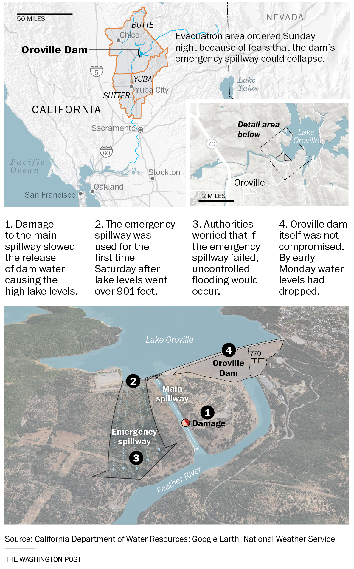

Here is a graphic showing where things are:
498709d1487039586-california-drought-spillway0212-jpg
Source: Compromised Oroville Dam Auxiliary Spillway Leads To Mass Evacuation: SFist
The main spillway is cut into the rock as seen in the picture I posted earlier.
For all you guys who keep repeating that the spillway is rock, why do you think that will stop the water?
Rock is one of the worse materials for holding water in a pond because of all the cracks. Rushing water over it will break it apart in time. Yosemite is an excellent example of what water does to solid rock.
What is protecting the solid rock from the rushing water? and how long will it remain solid rock?
There is clay and fill dirt/riprap/concrete (depending on where you are talking) on the lake side keeping the water out of the (mostly solid) rock. What the rock downhill from the spillway does is resist erosion. Yes, it can be worn away, no it wont hold as well as good concrete, but it will hold a lot better than dirt does.
If you follow the link in my last post, you can see where the water coming down the main spillway has cleaned the dirt out and the water coming down the hill is white (no mud/clay unlike the bottom of the emergency spillway).

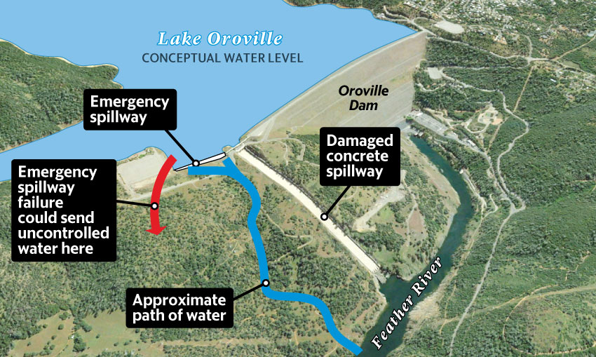

Another map and photo showing where things are.
Bruce
