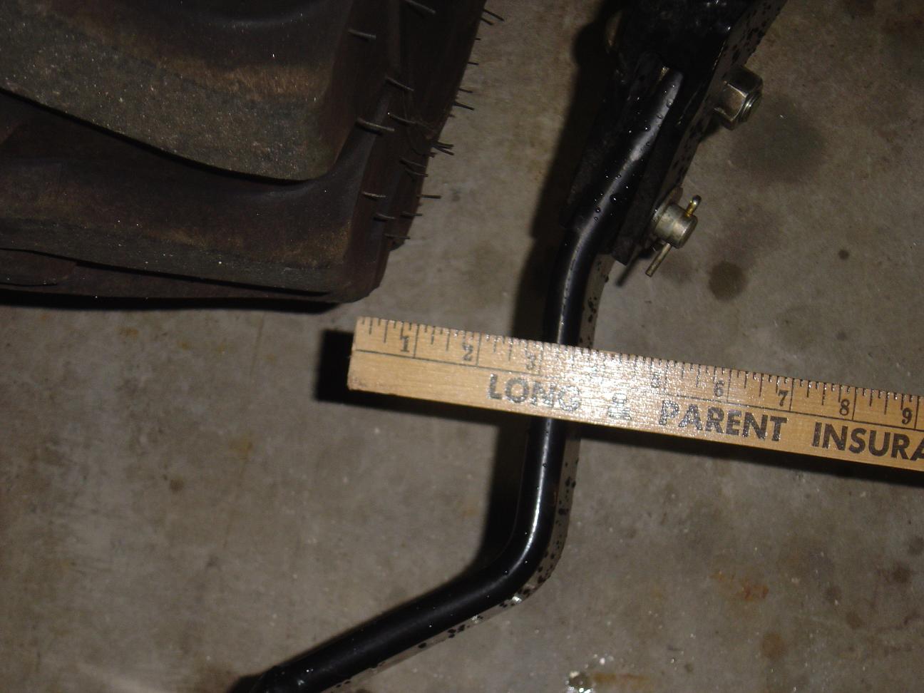

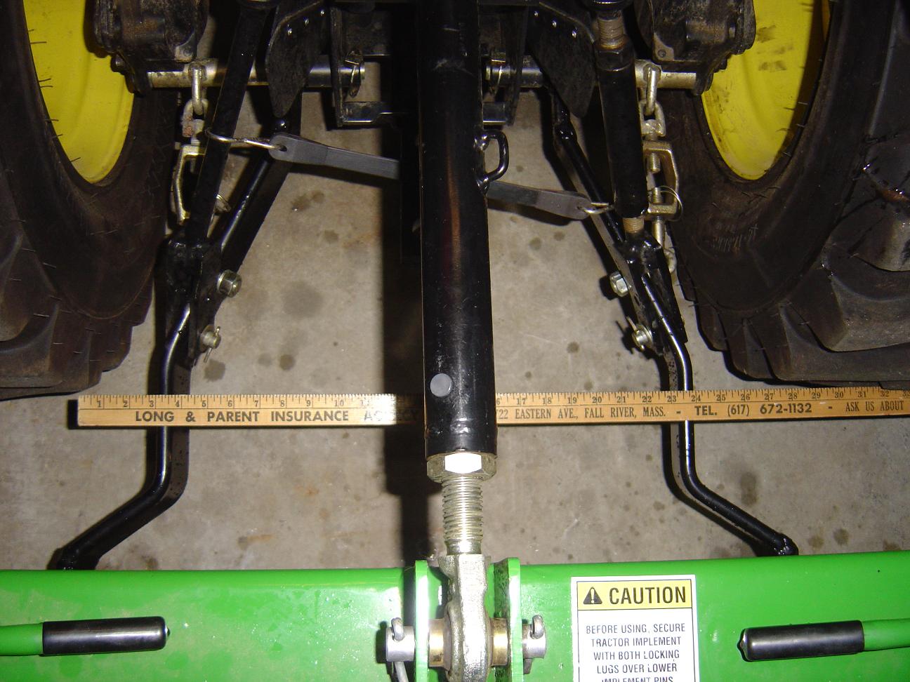

Hiya,
Well, they came in and they are on! The calls worked! My faith in the big green is restored. :)
Here's the pictures, there is 3" between tire and arm when all the way down. (I didn't measure it all the way up but there has to be more than before) I tried to take a picture with a meter stick but the batteries died as I pressed the button, sorry metric system guys and gals. ;)
Has anyone checked the overall length of the replacement arms? It may be an optical delusion but they look longer. I'm wondering if PTO shafts are long enough to have proper slide engagement at full extension.
Tom
