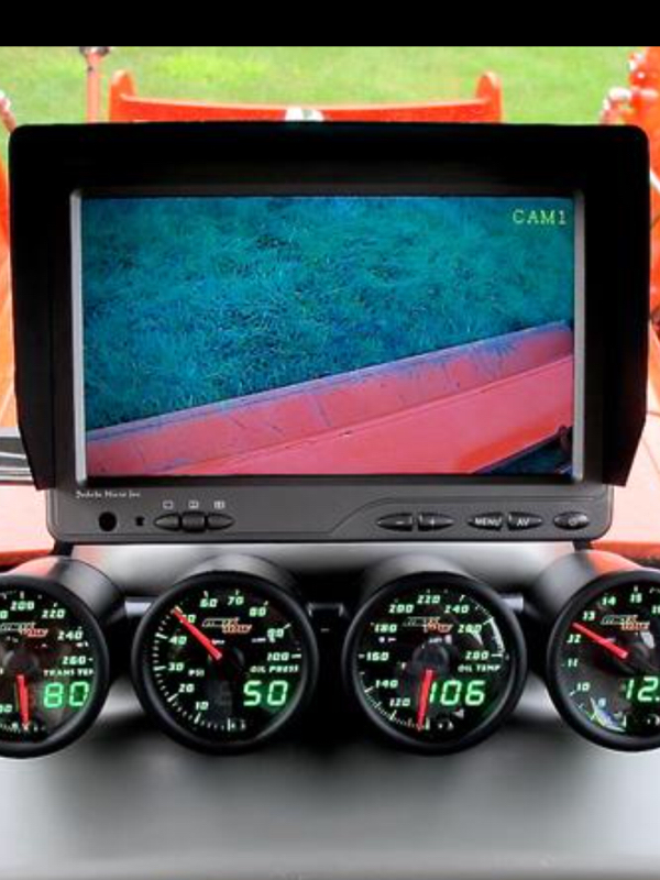

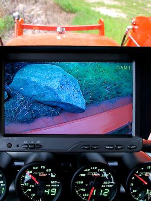

For a front camera, a narrow field of view works the best.
On the Versahandler, I mounted mine in a piece of 2x4 tubing to protect it from brush.
The rear camera is in the taillight bracket.

A camera mounted in the correct location lets you see the cutting edge just fine. Not my pics , but mine looks about the same.
