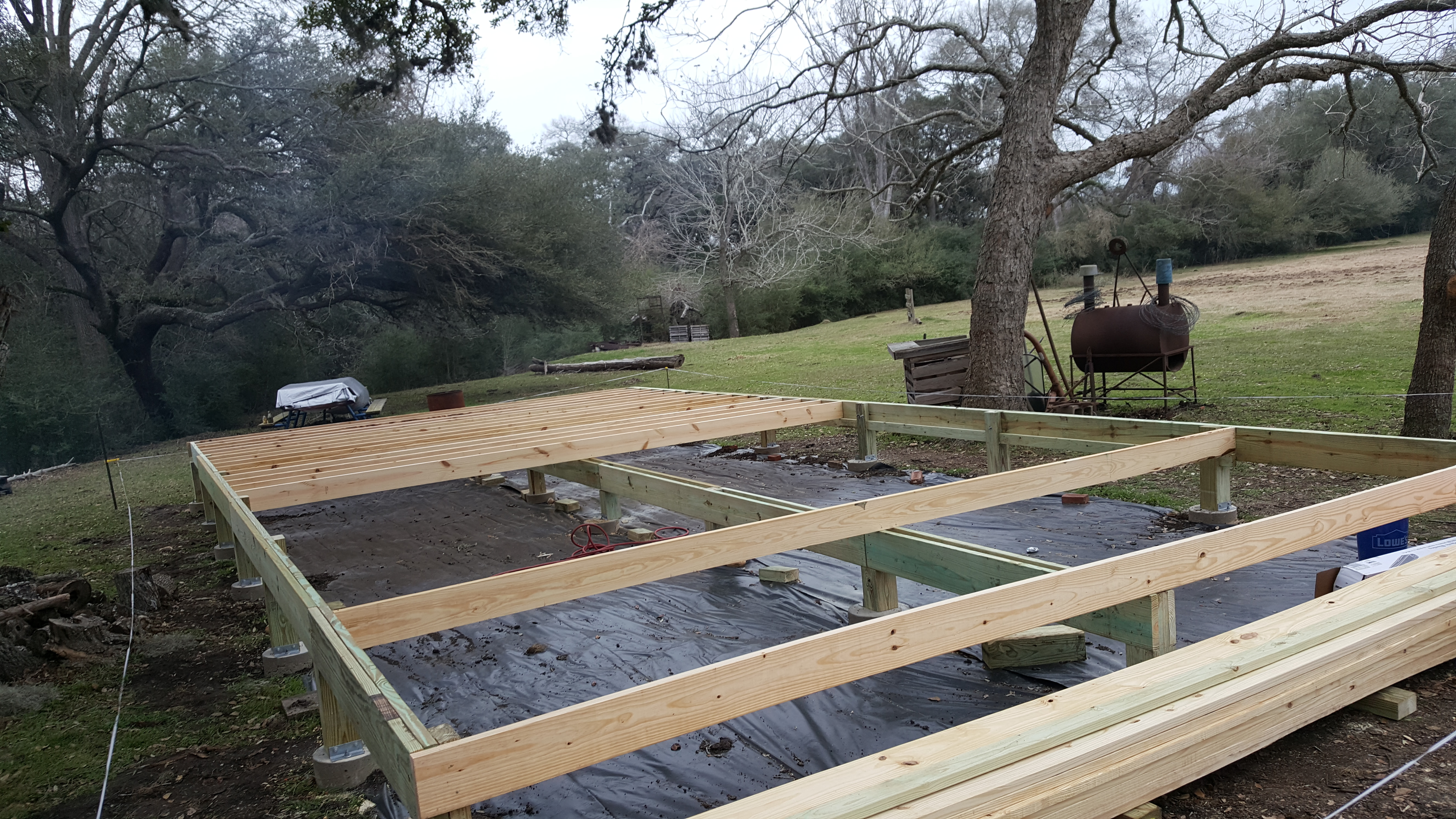

Looks nice. What was the reason for not using T&G for the subfloor?
Are you going to have plumbing in the building? Or did I just not see drain lines sticking out from the floor?

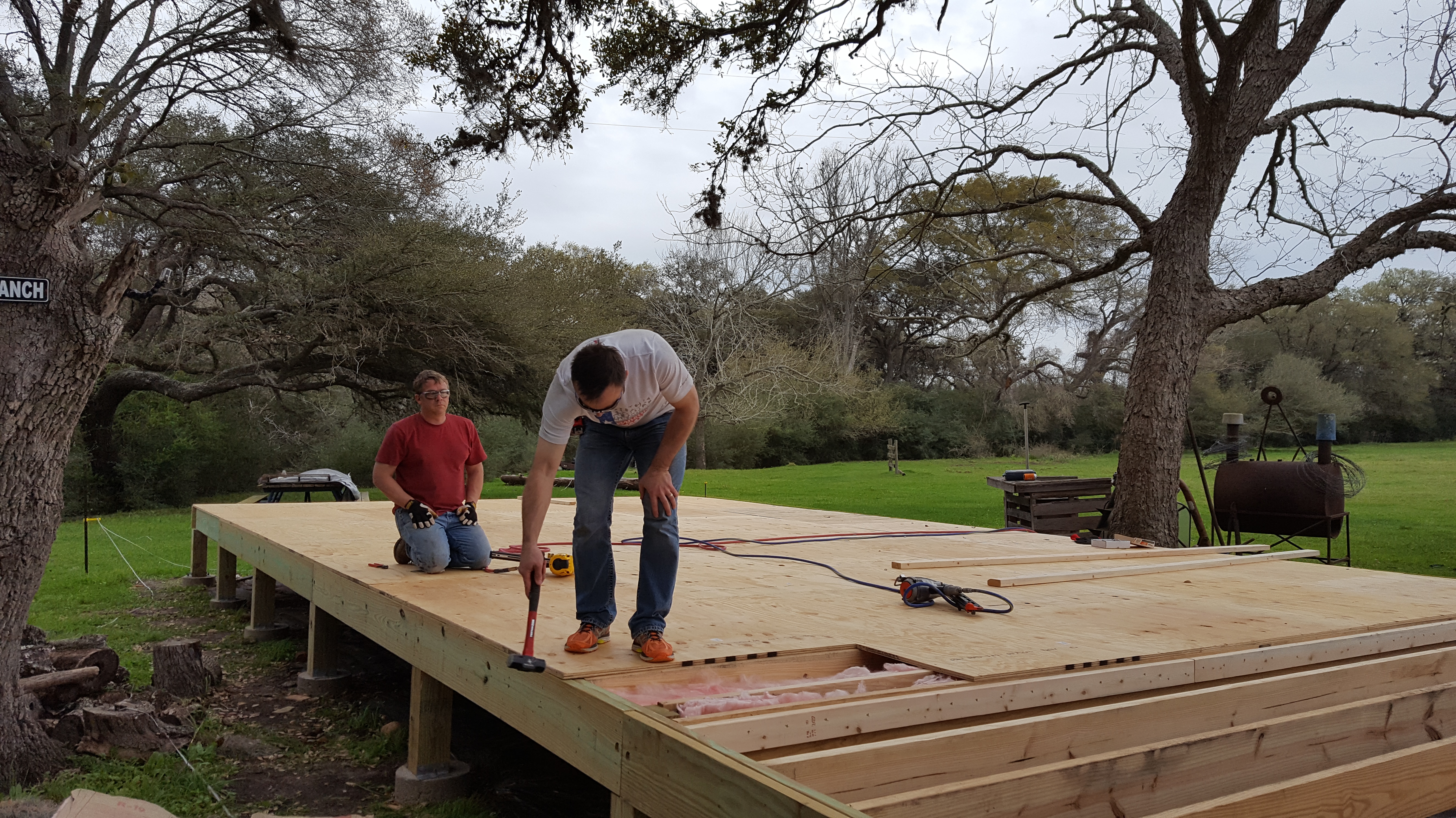

BIL wants to clear coat the plywood floor as the final surface and T&G has an gap where they join. I was ready to block every joint (wasn't too excited about it) but we walked over and jumped on a plywood joint and didn't think the give was significant.
Since we can crawl underneath right now, we are going to put the plumbing drain lines in later. Hang them with strapping underneath the joists and go underground right at the building edge.

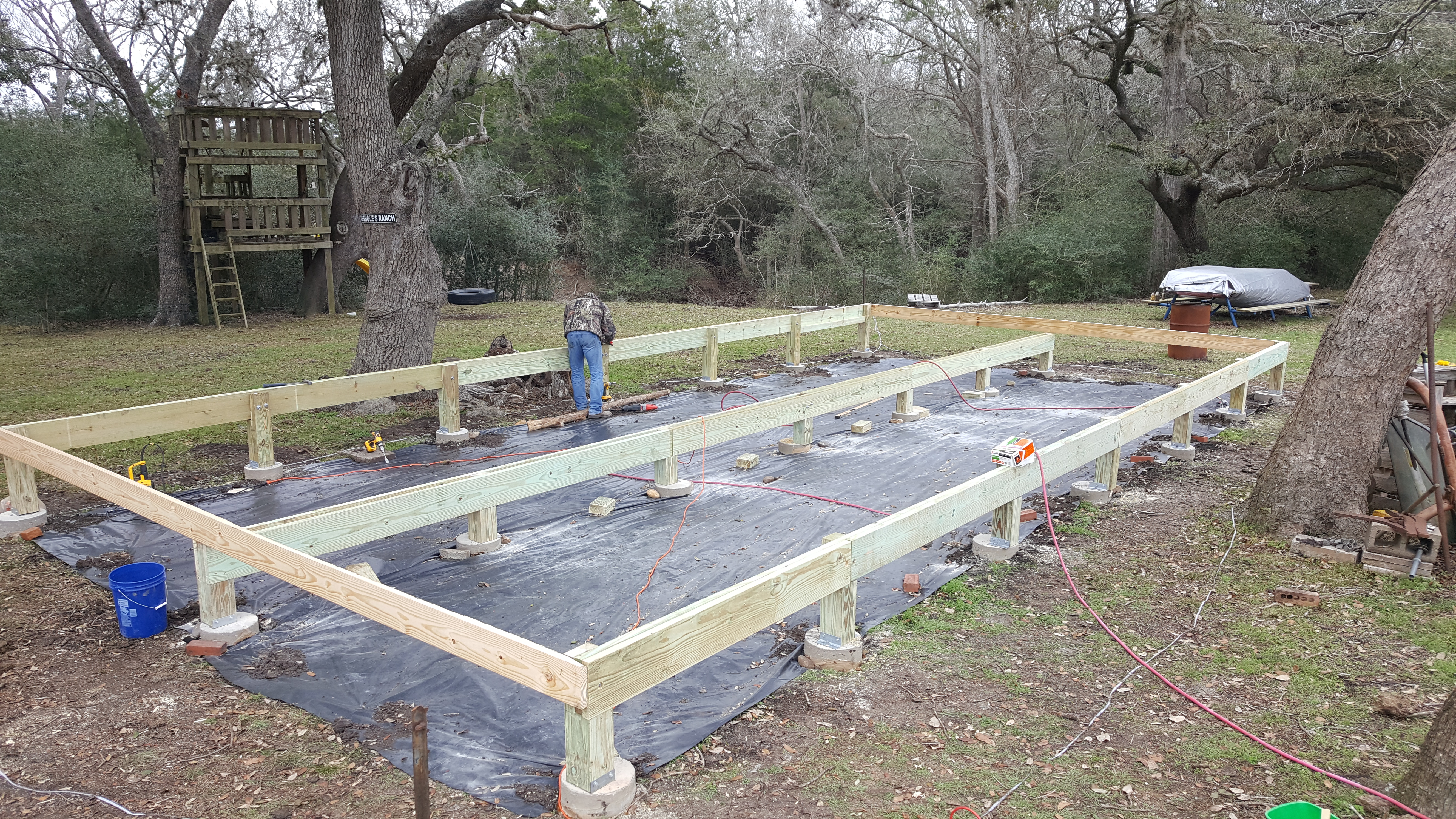

2 x 4 ledger is nailed every two inches plus joists are toe nailed. It will be fine.
Without doing the math, I'm quite confident you will not get sufficient shear capacity out of the nails. More than one floor has catastrophically failed because these fasteners were disregarded. I attached some reference material for your use:
LedgerLOK Deck Ledger Structural Wood Screw – Deck Ledger Board Fastener
Deck Ledger Bolting by the Code - Fine Homebuilding
Ledger-Bolting Requirements in the 212 IRC | Professional Deck Builder | Codes and Standards, Framing, Anchors, Building Codes
Second thing is that your posts have created a soft story. To prevent racking you will need to add some diagonal braces to laterally stabilize the "table legs" you have.

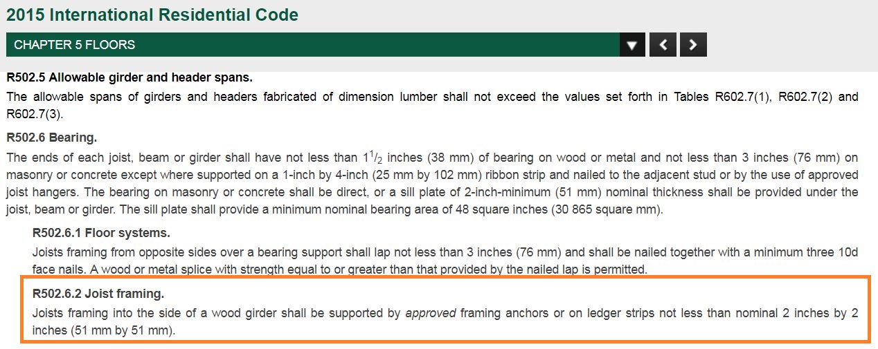

According to the IRC, it appears to be correct to me.
   / Camp house Build #30
Yes, but that section does not address the attachment of the ledger strips. The problem is not the use of the leger, but how it's being attached. Nails alone are not providing sufficient shear strength.
Deck Ledger Attachment Methods
Despite opinions to the contrary, the inspection requirements have come into existence to help prevent problems like this.

Looks like a great project.
It would be very easy to go back and put lag screws in the floor joists at the support posts. I like using screws and lag screws to keep things tight and prevents the problem of nails working out and getting loose over time.
Also, putting some diagonal bracing on the "legs" would probably be a great idea. Also makes for something to attach "skirting" to later.
Looks like you are doing a great job and will have a nice hunting cabin where many fond memories will be made.
