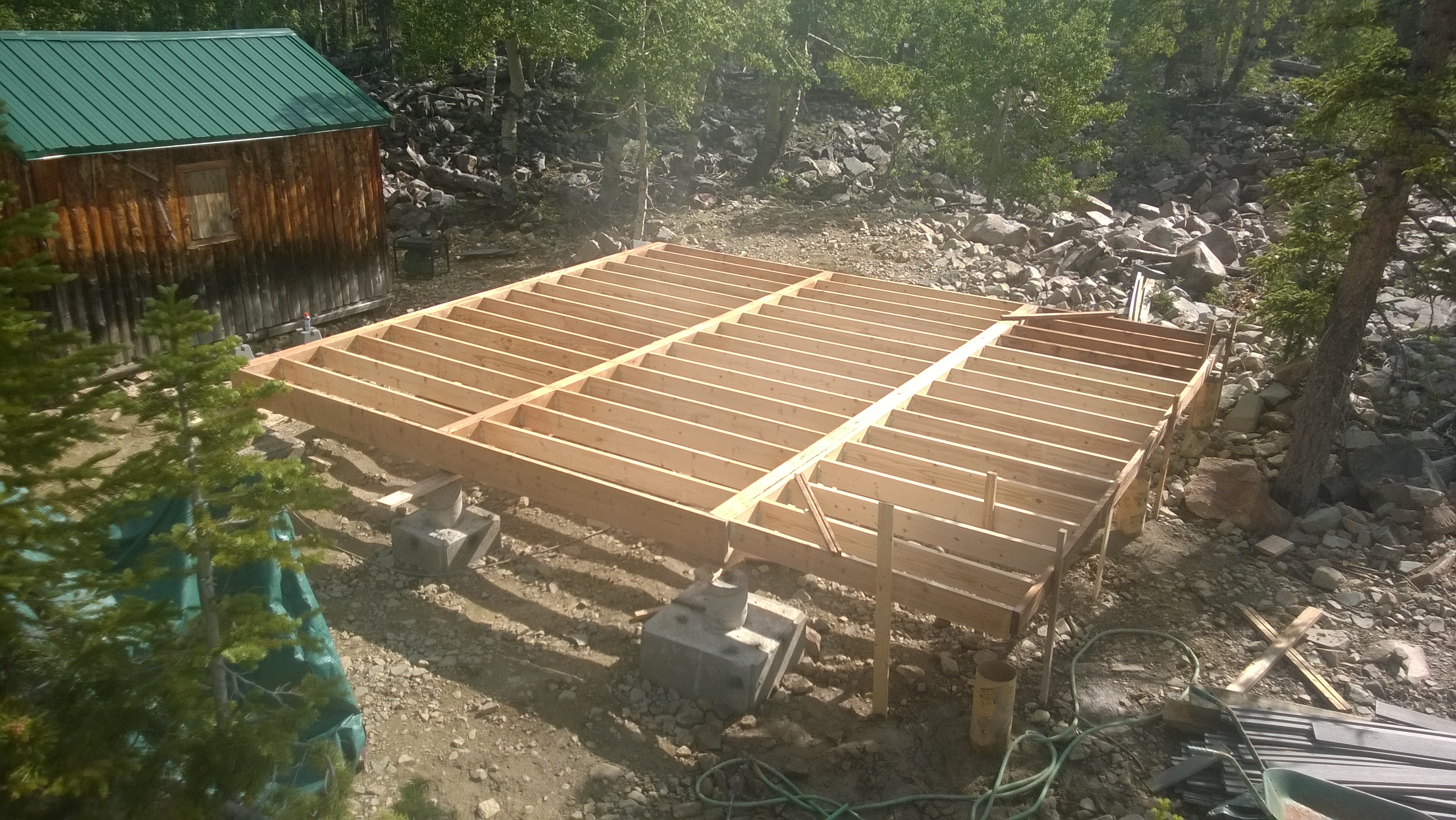

Keeping rodents out is always a concern and particularly with seasonal-use buildings. Even if you can't keep them completely out you want to limit the amount of harborage you give them. So everything should be as tight as possible. A mouse can go through a hole the size of a dime, a rat through a hole the size of a quarter. So I like the idea of boxing the bottoms of the floor joists with plywood. Since by the look of the pictures it doesn't seem like you have much clearance below, I like the idea of running cleats along the joists and doing all of the work from above. But I see some issues. Whenever you insulate you have to worry about moisture. If any gets in there it's not going to have a way out. There is a constant debate about whether it is better to seal things up completely and keep moisture out, or give it a way out. I would consider using 7/16" Zip board for the bottom, it's about the same price as 1/4" CDX plywood around here, but has better weather resistance. It also is less likely to warp so it will stay tight. If you decide you want moisture to have a way out you might put a round vent at each end of each bay.

I would do it so that if you had to, you could come in from below later and get into the joist bays. If the plywood isn't fastened to the cleats, I think with 2x8 or larger joists you could lift the plywood from below and angle it and pull it out. You could also just pick up a piece and slide it over a neighboring piece. Think of like a suspended ceiling.
It may end up being easiest to put the sheets of plywood in while you're framing, but not the insulation. Once the building is sealed, crawl under, slide the plywood to one end, put up the insulation and slide the boards back. It depends a lot on how much clearance you have.

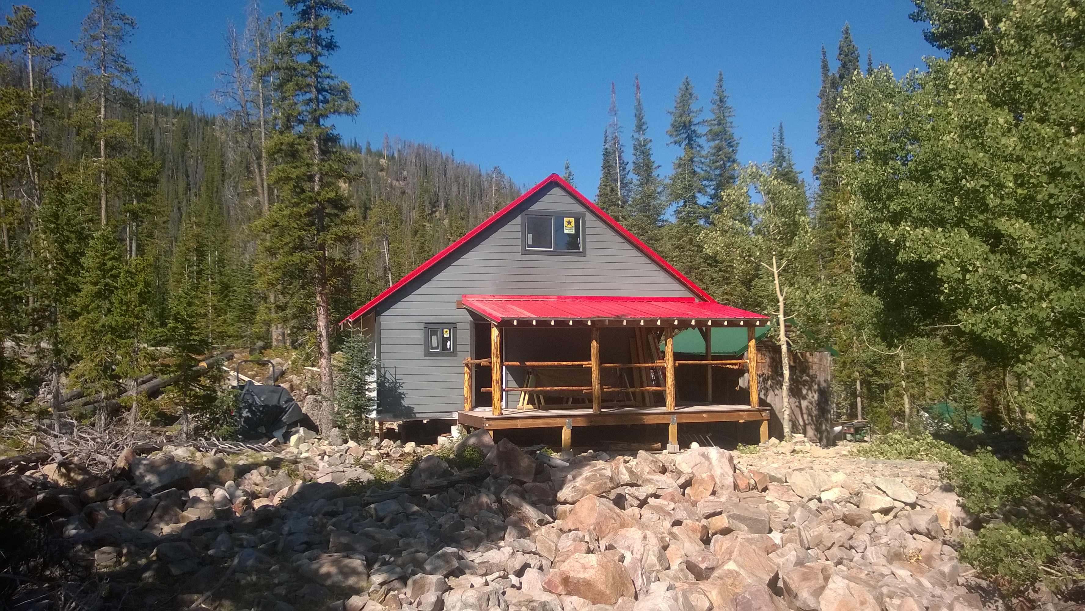

I am in the same boat. I have temperature extreams to deal with and I want to be able to use it in the winter when I snowmobile in. The best for me in my situation is spray foam. I will have to bite the bullet and pay for the closed cell spray foam kits and get about 4 inches of depth. It's a one and done deal, will never have to mess with it again. The foam can be sprayed with a bittering agent that will prevent mice from eating it, pluse I've never had a problem with mice and closed cell foam. They must think that since it's hard, it's not nesting material. I have not spray foamed it yet because I still have to run plumbing and electrical, but I want to do the floor this summer just to get an idea how it is going to go. Luckily since I have to deal with heavy snow, 20+ feet sometimes, I built 4 feet off the ground to keep things dry for a longer window of the year.
That is a fantastic looking cabin, Heck of a view.

When we built our cabin in Alaska we reached a point, very similar to the OP pic in post #4. We inquired about insulation under the flooring and were advised that almost nothing would keep the rodents/insects out. The rodents would go right thru plywood to reach the space between joists.
In the end we put down 2 x 6 T&G planking with no insulation. We put large throw rugs on the floor to help with the cold. It all worked out fine - my feet were always warm.

I think I'm going to go with 1/4 plywood attached to the bottom of the floor joists and fiberglass insulation. I've found enough lightly used 1/4 inch on Craigslist for 8 dollars a sheet.
