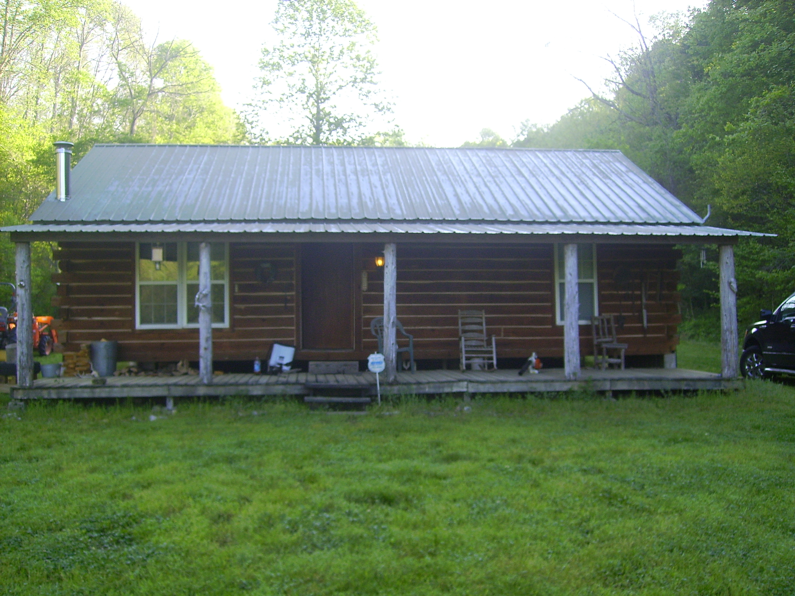

I built a 28X36 hunting/recreation log cabin on piers about 15 years ago. I cut trees off the property and had a local guy bring in his portable mill and cut 6X7 logs. I didn't put any insulation between the joists. My reasoning was it's just a hunting cabin, and it will serve my purposes. It's mostly carpeted so the floor isn't uncomfortable. It has a wood stove that keeps it pretty toasty even in cold weather. It has served my purposes quite well, but that said, I wish I had put insulation in. I wasn't on TBN back then. Wish I had been and had asked lots of questions of you experts. I was an inexperienced builder, but all in all, it has held up well.

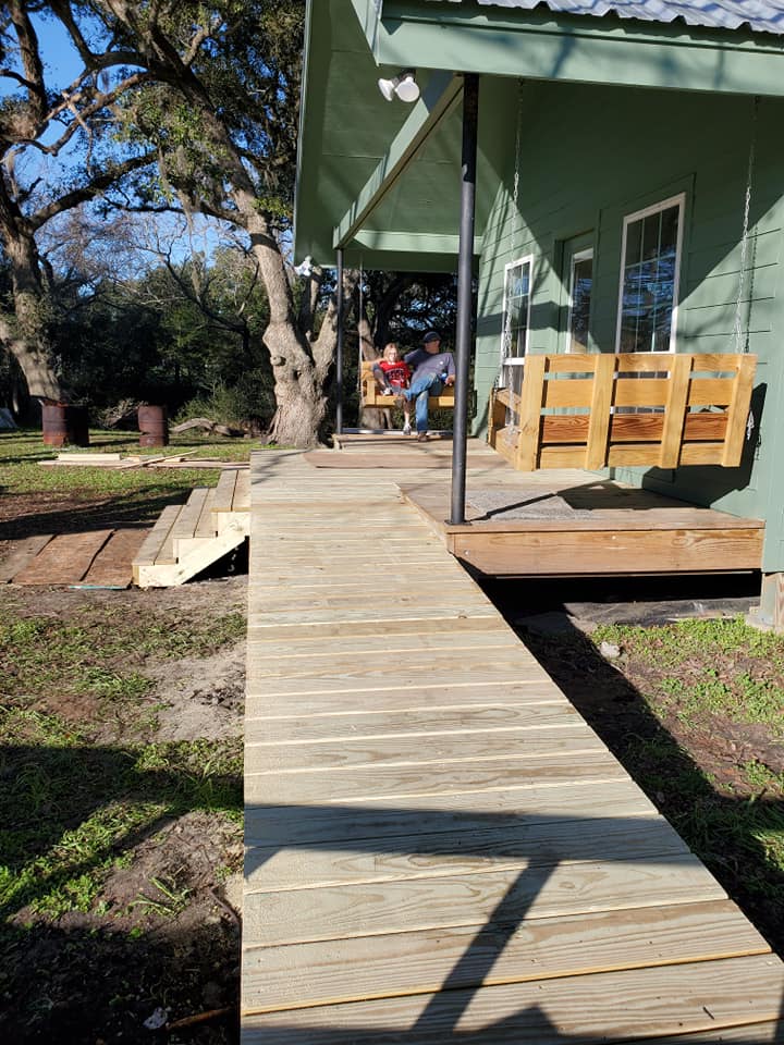

2 years later, the camp house is almost done.
   / camp house floor insulation #50
Ramp looks nice. Elderly people will appreciate that.
