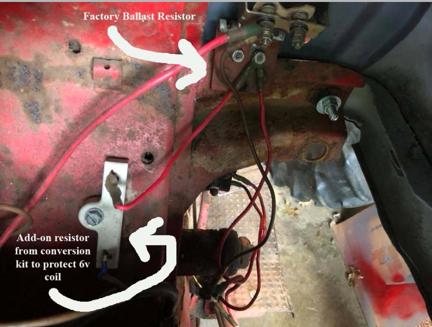

I have a 9n. I can’t get it to start. I have a good 6volt battery. A new distributor, coil, condenser, cap and rotor. 8 ohm resistor between the switch and coil. It cranks fine it acts like it wants to start with starting fluid but it won’t take off. Compression is low in all cylinders but I think it should at least start weather it runs well or not. Any ideas
In addition to the ballast resistor? If so, this is probably your problem. An additional inline resistor to the coil is only needed when you have converted to 12v but retained the 6v coil.

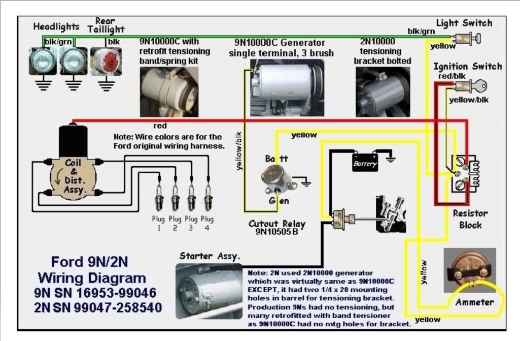

This wiring diagram will also show you the firing order:
