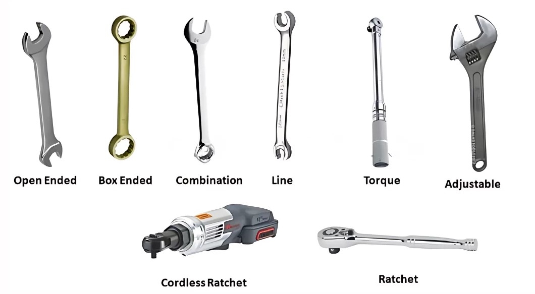

Where is the Socket wrench?
I cropped the so-called "socket wrench" out as they are called a ratchet in most tool catalogs. Seems to be an archaic term used in the beginnings of tool manufacturing. The line wrenches shown are also referred to as brake line or tubing wrenches. There are also thin wrenches for hydraulic hose fittings. For a deep dive into tools visit Alloy Artifacts Tool History Page
