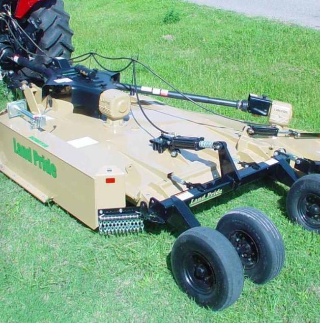

I want a 15 foot batwing and will need to get a bigger tractor to run it. I've seen the ten foot models like you asked about, but they are not just a 15 foot mowers with one of the wings removed. They have extra wheels and a certain twist to the tow bar so it will run straight behind the tractor with the one wing off to the side. I've only seen them for sale used, and I don't really remember the price. My thinking was that if I could get a mower like that, I could get away with a 50 to 60 hp tractor and save some money that way.
Eddie
   / Can a Bat Wing Bush Hog Have one Wing Removed #13
image-3215851009.jpg I see no twist to the hitch or extra wheels involved.
   / Can a Bat Wing Bush Hog Have one Wing Removed #14
Nope, I don't see it there either.
Eddie
